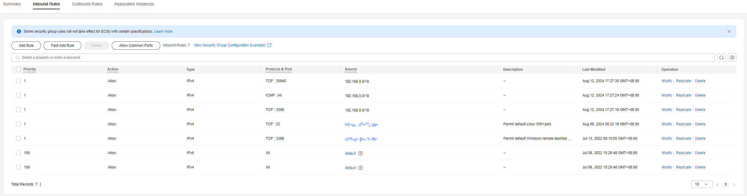

    2. Click the Security Groups tab. In the left pane of the page, click Manage Rule. On the Inbound Rules tab, you can find that the source addresses include the CIDR block 192.168.0.0/18. Within this block, the node CIDR block 192.168.0.0/24 is included, but the container CIDR block 172.16.0.0/16 is not. For a cluster that uses a VPC network, you need to allow both the node CIDR block and container CIDR block in the ECS security group rules to access the ECS from a pod. However, for clusters using other types of networks, you only need to allow the node CIDR block in the ECS security group rules.
      Figure 1 Original inbound rules

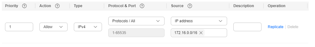

    3. Click Add Rule and enter 172.16.0.0/16 in the Source text box. For details, see Figure 2.
      Figure 2 Adding a rule

    3. Click Add Rule and enter 172.16.0.0/16 in the Source text box. For details, see Figure 4.
      Figure 4 Adding a rule
