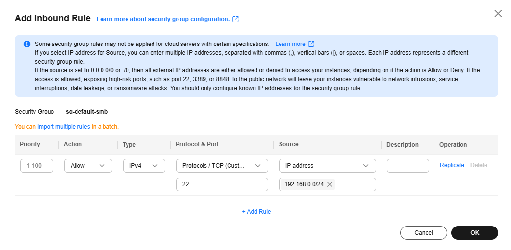

- On the Inbound Rules tab, click Add Rule.
The Add Inbound Rule dialog box is displayed.
- Configure inbound rule parameters as prompted. You can add multiple inbound rules one by one. Figure 1 Add Inbound Rule
Table 2 Inbound rule parameter description Parameter
Description
Example Value
Priority
The security group rule priority.
The priority value ranges from 1 to 100. The default value is 1, which has the highest priority. The security group rule with a smaller value has a higher priority.
Action
The value can be Allow or Deny.- If the Action is set to Allow, traffic is allowed to access the cloud servers in the security group over specified ports.
- If the Action is set to Deny, traffic is denied to access the cloud servers in the security group over specified ports.
Security group rules are matched by priority and then by action. Deny rules take precedence over allow rules. For more information, see How Traffic Matches Security Group Rules.
Allow
Type
Source IP address version. You can select:- IPv4
- IPv6
IPv4
Protocol & Port
The network protocol used to match traffic in a security group rule. The protocol can be All, TCP, UDP, GRE, or ICMP.
TCP
Destination port used to match traffic in a security group rule. The value can be from 1 to 65535.
Inbound rules control incoming traffic over specific ports to instances in the security group.
Enter ports in any of the following formats:- Individual port: Enter a port, such as 22.
- Consecutive ports: Enter a port range, such as 22-30.
- All ports: Leave it empty or enter 1-65535.
22, 22-30
Source
Used to match the source of an external request. The source can be:- IP address: The source is a fixed IP address. You can enter or paste multiple IP addresses separated by commas (,). Each IP address represents a different security group rule.
- Single IP address: IP address/mask
Example IPv4 address: 192.168.10.10/32
Example IPv6 address: 2002:50::44/128
- IP address range in CIDR notation: IP address/mask
Example IPv4 address range: 192.168.52.0/24
Example IPv6 address range: 2407:c080:802:469::/64
- Any IP addresses
0.0.0.0/0 represents all IPv4 addresses.
::/0 represents all IPv6 addresses.
- Security group: The source is from another security group. You can select a security group in the same region from the drop-down list. If there is instance A in security group A and instance B in security group B, and the inbound rule of security group A allows traffic from security group B, traffic is allowed from instance B to instance A.
- IP address group: The source is from an IP address group. An IP address group is a set of one or more IP addresses. You can select an available IP address group from the drop-down list. For IP address ranges and IP addresses with the same security requirements, you can use an IP address group to simplify management.
IP address:
192.168.52.0/24,10.0.0.0/24
Description
(Optional) Supplementary information about the security group rule.
The security group rule description can contain a maximum of 255 characters and cannot contain angle brackets (< or >).
N/A
- Click OK.
The inbound rule list is displayed.

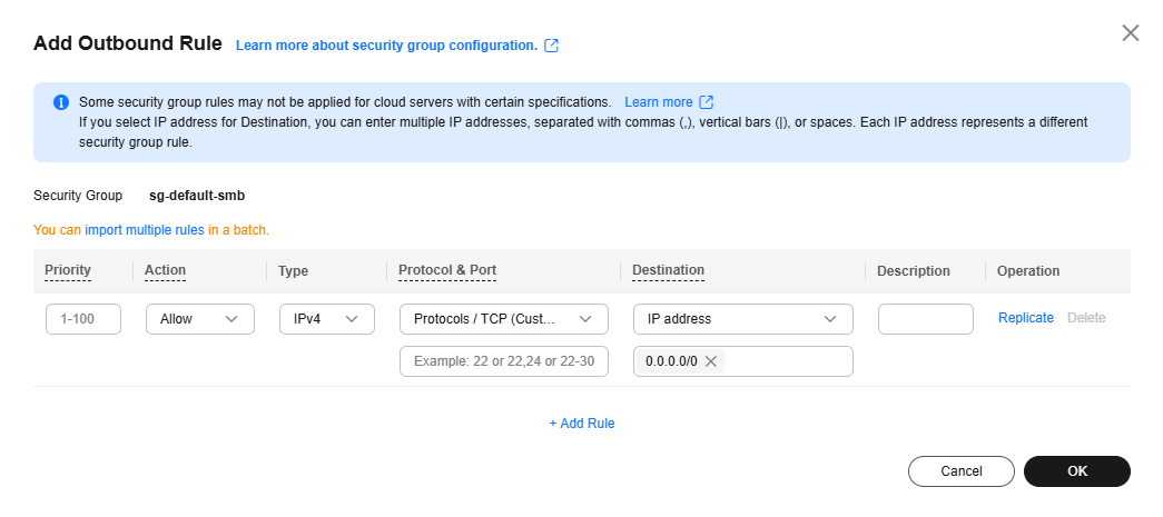

- On the Outbound Rules tab, click Add Rule.
The Add Outbound Rule dialog box is displayed.
- Configure outbound rule parameters as prompted. You can add multiple outbound rules one by one. Figure 2 Add Outbound Rule
Table 3 Outbound rule parameter description Parameter
Description
Example Value
Priority
Action
The value can be Allow or Deny.- If the Action is set to Allow, access from ECSs in the security group is allowed to the destination over specified ports.
- If the Action is set to Deny, access from ECSs in the security group is denied to the destination over specified ports.
Allow
Type
Destination IP address version. You can select:- IPv4
- IPv6
IPv4
Protocol & Port
TCP
Outbound rules control outgoing traffic over specific ports from instances in the security group.
22, 22-30
Destination
Used to match the destination of an internal request. The destination can be:- IP address: The destination is a fixed IP address. You can enter or paste multiple IP addresses separated by commas (,). Each IP address represents a different security group rule.
- Any IP addresses
- Security group: The destination is another security group. You can select a security group in the same region under the current account from the drop-down list. If there is instance A in security group A and instance B in security group B, and the outbound rule of security group A allows traffic to security group B, traffic is allowed from instance A to instance B.
- IP address group: The destination is in an IP address group. An IP address group is a set of one or more IP addresses. You can select an available IP address group from the drop-down list. For IP address ranges and IP addresses with the same security requirements, you can use an IP address group to simplify management.
IP address:
Description
N/A
- Click OK.
The outbound rule list is displayed.

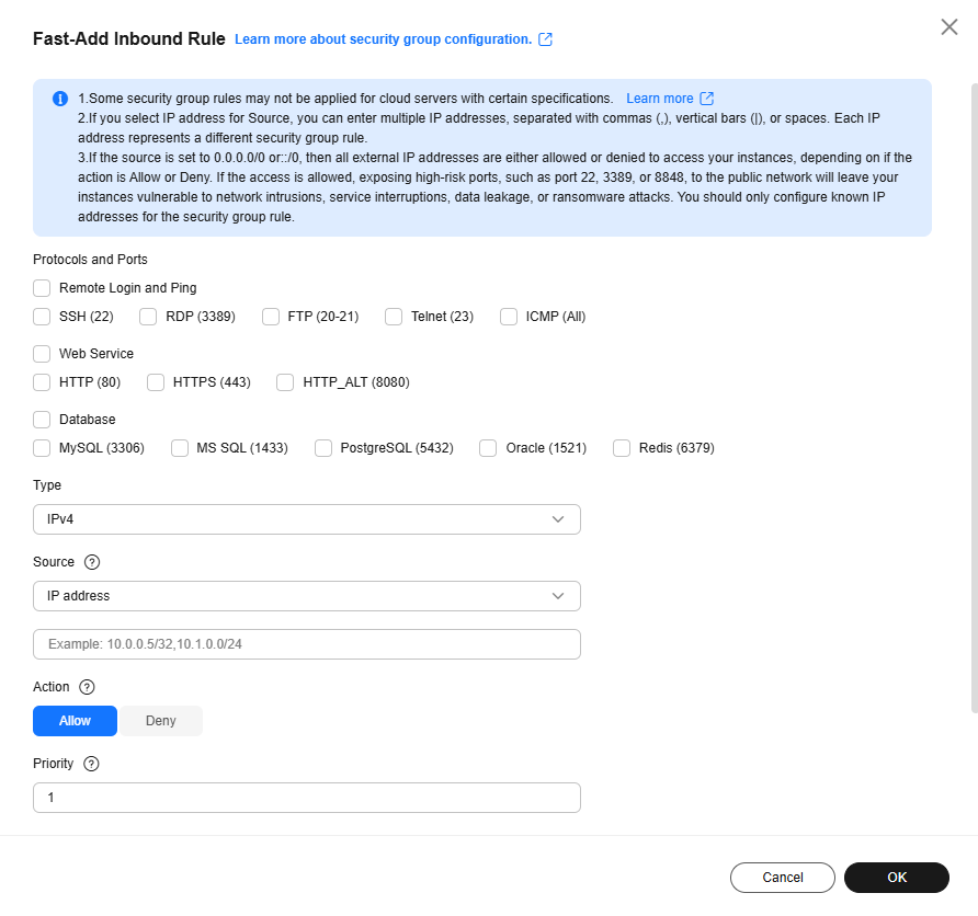

- On the Inbound Rules tab, click Fast-Add Rule.
The Fast-Add Inbound Rule dialog box is displayed.
- Configure inbound rule parameters as prompted. Figure 3 Fast-Add Inbound Rule
Table 4 Inbound rule parameter description Parameter
Description
Example Value
Protocols and Ports
Common protocols and ports are provided for:
- Remote login and ping
- Web service
- Database
SSH (22)
Type
- IPv6
IPv4
Source
Source of the security group rule. The value can be IP address or Security group to allow access from the IP addresses or the instances in the security group. You can specify:- A single IP address: 192.168.10.10/32 (IPv4); 2002:50::44/127 (IPv6)
- An IP address range: 192.168.1.0/24 (IPv4); 2407:c080:802:469::/64 (IPv6)
- Any IP address: 0.0.0.0/0 (IPv4); ::/0 (IPv6)
- Security group: sg-abc
If the source is a security group, this rule will apply to all instances associated with the selected security group.
192.168.0.0/24
Action
Allow
Priority
Description
N/A
- Click OK.
The inbound rule list is displayed and you can view your added rule.

Description
Inbound
TCP: 22 (IPv4)
0.0.0.0/0
Allows all IPv4 addresses to access ECSs in the security group over port 22 (SSH) for remotely logging in to Linux ECSs.
TCP: 3389 (IPv4)
0.0.0.0/0
Allows all IPv4 addresses to access ECSs in the security group over port 3389 (RDP) for remotely logging in to Windows ECSs.
TCP: 80 (IPv4)
0.0.0.0/0
Allows all IPv4 addresses to access ECSs in the security group over port 80 (HTTP) for visiting websites.
TCP: 443 (IPv4)
0.0.0.0/0
Allows all IPv4 addresses to access ECSs in the security group over port 443 (HTTPS) for visiting websites.
TCP: 20-21 (IPv4)
0.0.0.0/0
Allows all IPv4 addresses to access ECSs in the security group over ports 20 and 21 (FTP) for uploading or downloading files.
ICMP: All (IPv4)
0.0.0.0/0
Allows all IPv4 addresses to access ECSs in the security group over any port for using the ping command to test ECS connectivity.
Outbound
All (IPv4)
All (IPv6)
0.0.0.0/0
::/0
Allows access from ECSs in the security group to any IP address over any port.
