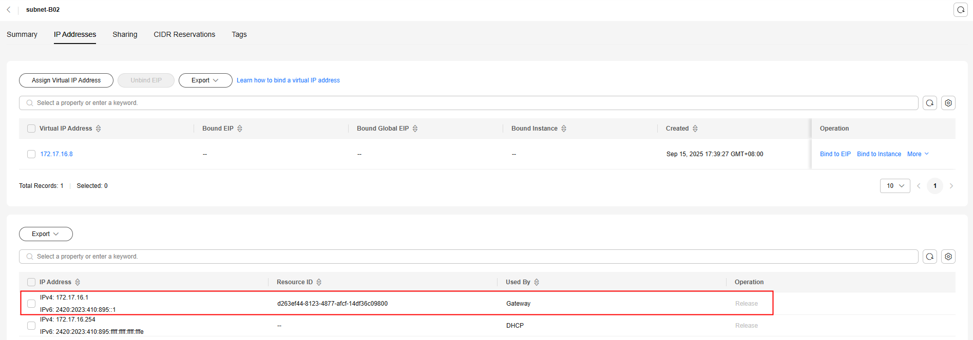

    5. Click the IP Addresses tab and view the gateway address of the subnet.
      Figure 5 Gateway address
