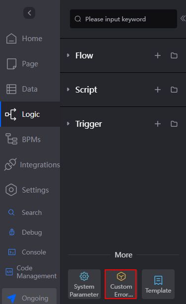

- Log in to the application designer by referring to Logging In to the Application Designer.
- In the navigation pane, choose Logic and choose More > Custom Error Codes.Figure 1 Customizing error codes

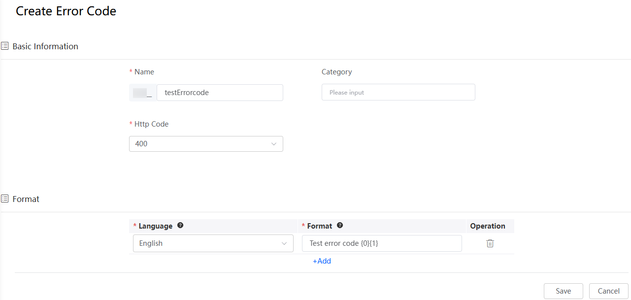

- On the Custom tab page, click Create.
Alternatively, click Import to import an available error code.
- Set error code parameters and click Save.Figure 2 Customizing an error code
Table 1 Parameters for customizing an error code Parameter
Description
Name
Name of a customized error code. The naming requirements are as follows:
- The value cannot exceed 64 characters, including the prefix namespace.
To prevent duplicate data names among different tenants, each tenant must define a unique namespace when first creating an application. A tenant can create only one namespace. After being created, the namespace cannot be modified.
- Start with a letter and consist of only letters, digits, underscores (_), hyphens (-), and periods (.).
Category
Category to which an error code belongs.
Value: 1–64 characters.
Http Code
Select a code from the drop-down list, for example, 200 or 201.
Language
Select a language. Click Add to add more language versions for the error code. If the language to be added does not exist, click
next to Language. In the displayed dialog box, click Translation Setting to add a language. For details, see Setting the Supported Languages.Format
Description of an error code. {Number} indicates a variable name. For example, {0} indicates the first output variable, {1} indicates the second output variable, and {N} indicates the output variable N+1.

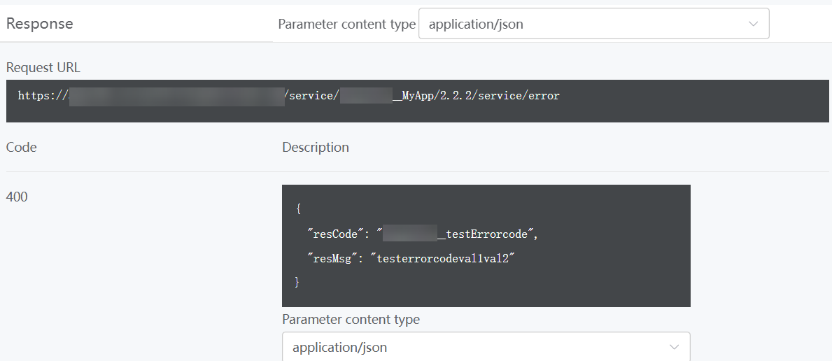

- Bind the developed script according to the operations in Customizing APIs and perform the test.Figure 3 Configuring an error message test
