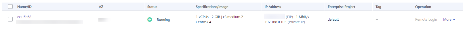

  2. Buy an ECS and select Linux (for example, CentOS) as its OS.
    To download a MySQL client to the ECS, bind an EIP to the ECS.
    For details about how to purchase a Linux ECS, see Purchasing a Custom ECS in Elastic Cloud Server User Guide.
  3. On the ECS Information page, view the region and VPC of the ECS.

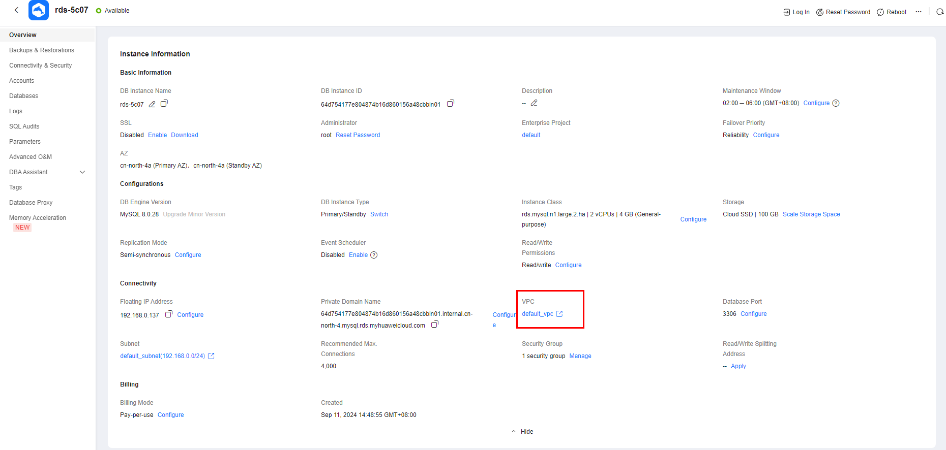

  4. On the Overview page of the RDS for MySQL instance, view the region and VPC of the DB instance.
    Figure 3 Overview

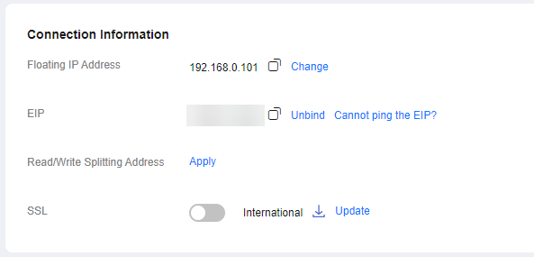

  3. Choose Connectivity & Security from the navigation pane. In the Connection Information area, obtain the EIP and database port of the DB instance.
    Figure 4 Connection information
    If no EIP has been bound to the DB instance, see Binding an EIP.

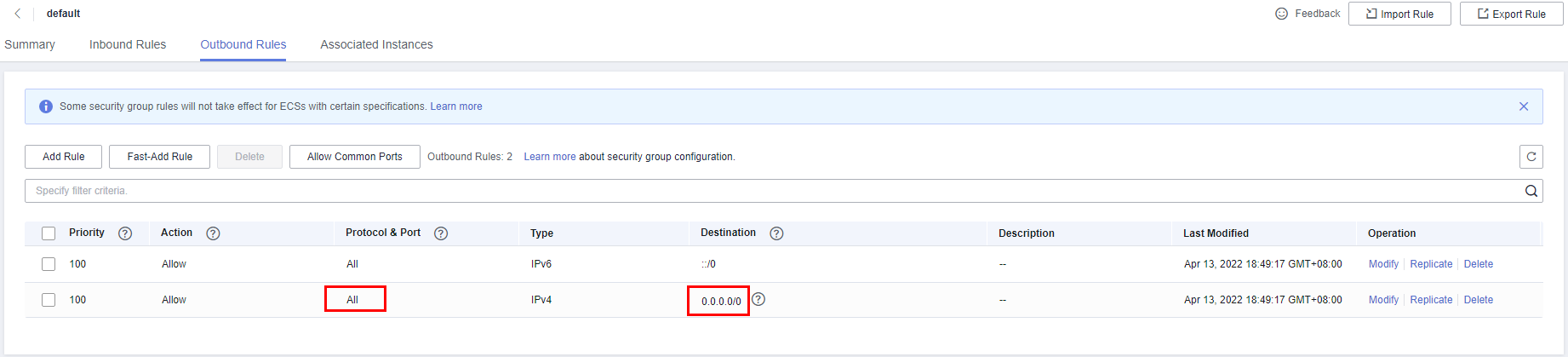

    • If no, check the security group rules.
      • If in the security group of the ECS, there is no outbound rule with Destination set to 0.0.0.0/0 and Protocol & Port set to All, add an outbound rule for the EIP and port of the DB instance.
        Figure 5 ECS security group

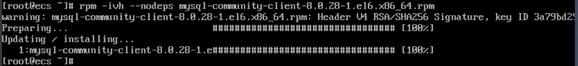

  2. Run the following command to install the MySQL client:
    • MySQL 8.0:
      rpm -ivh --nodeps mysql-community-client-8.0.28-1.el6.x86_64.rpm
      Figure 6 Installing a client

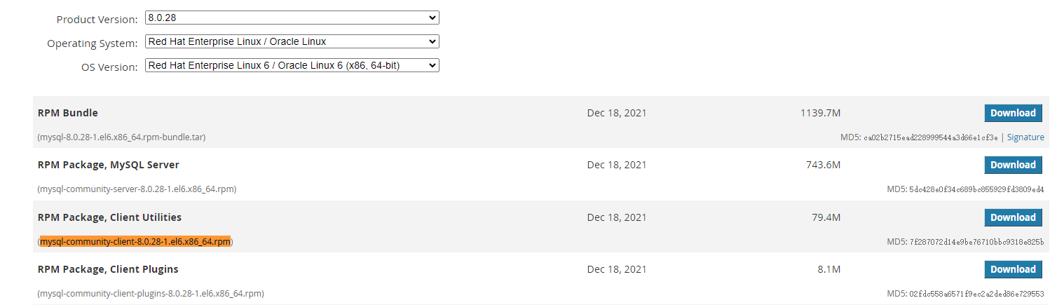

    • MySQL 8.0:
      Click here to download an installation package. mysql-community-client-8.0.28-1.el6.x86_64.rpm is used as an example.
      Figure 7 Downloading a MySQL 8.0 installation package

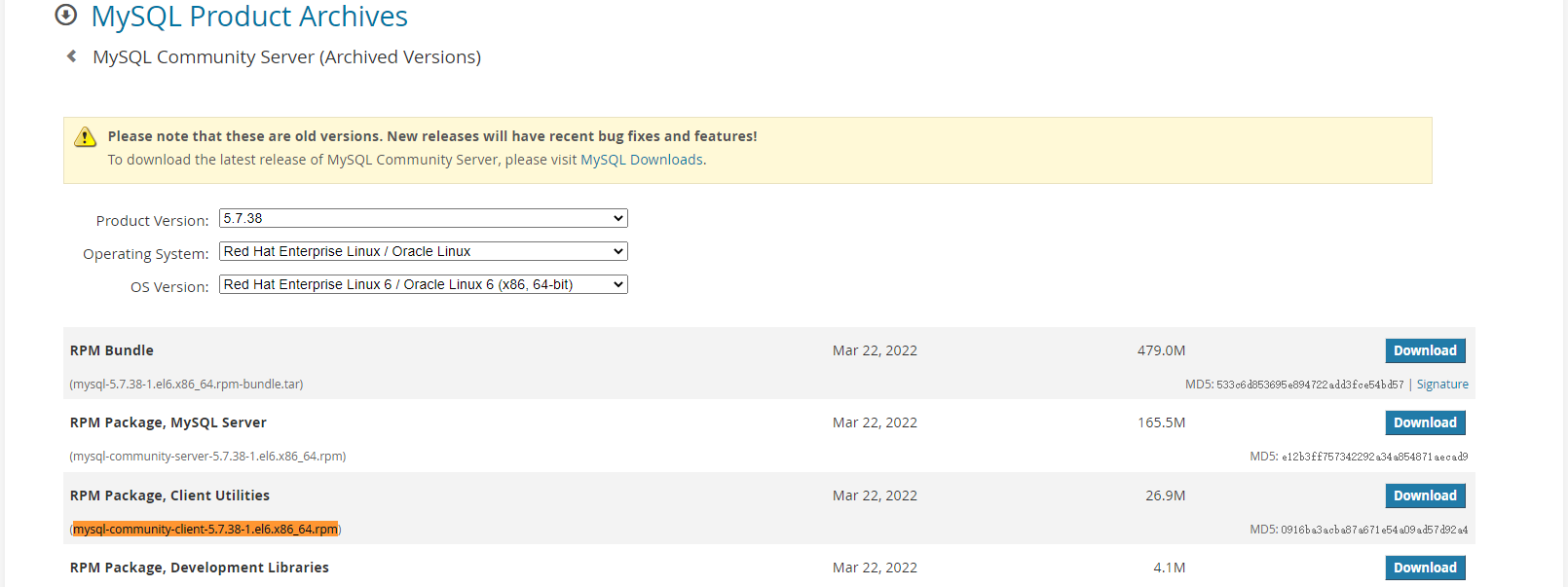

    • MySQL 5.7:
      Click here to download an installation package. mysql-community-client-5.7.38-1.el6.x86_64.rpm is used as an example.
      Figure 8 Downloading a MySQL 5.7 installation package
