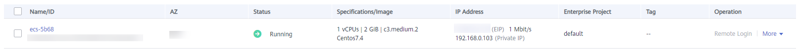

- Buy an ECS and select Linux (for example, CentOS 7.4 64bit) as its OS.
To download a MySQL client to the ECS, bind an EIP to the ECS. The ECS must be in the same region, VPC, and security group as the RDS for MySQL DB instance for mutual communications.
For details about how to purchase a Linux ECS, see Purchasing a Custom ECS in Elastic Cloud Server User Guide.
- On the ECS Information page, view the region and VPC of the ECS.
Figure 2 ECS information

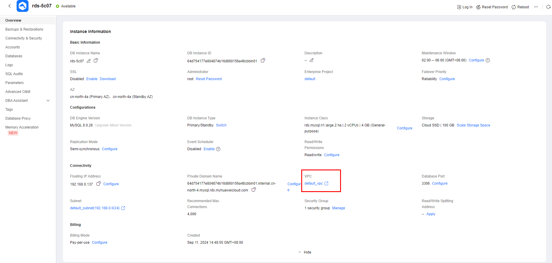

- On the Overview page of the RDS for MySQL instance, view the region and VPC of the DB instance.
Figure 3 Overview
- Check whether the ECS and RDS for MySQL instance are in the same region and VPC.

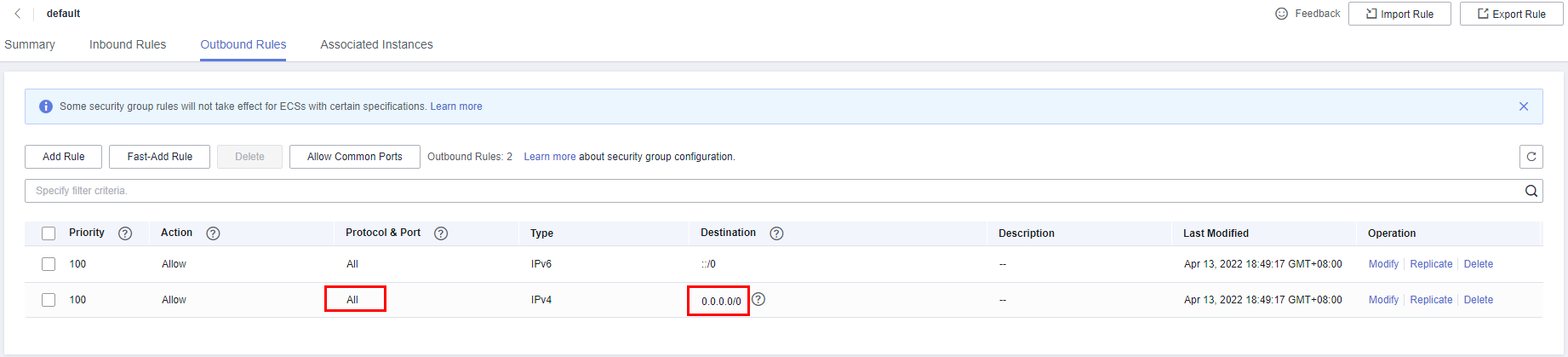

- If no, check the security group rules.
- If in the security group of the ECS, there is no outbound rule with Destination set to 0.0.0.0/0 and Protocol & Port set to All, add an outbound rule for the floating IP address and port of the DB instance.
Figure 6 ECS security group
- If in the security group of the DB instance, there is no inbound rule allowing the access from the private IP address and port of the ECS, add an inbound rule for the private IP address and port of the ECS. For details, see Configuring a Security Group Rule.

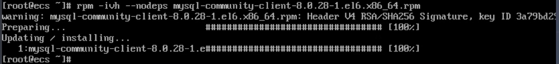

- Run the following command to install the MySQL client:
- MySQL 8.0:
rpm -ivh --nodeps mysql-community-client-8.0.28-1.el6.x86_64.rpm
Figure 7 Installing a client - MySQL 5.7:
rpm -ivh --nodeps mysql-community-client-5.7.38-1.el6.x86_64.rpm
- If any conflicts occur during the installation, add the replacefiles parameter to the command and install the client again.
rpm -ivh --replacefiles mysql-community-client-installation_package_version-1.el6.x86_64.rpm
- If a message is displayed prompting you to install a dependent package during the installation, add the nodeps parameter to the command and install the client again.
rpm -ivh --nodeps mysql-community-client-installation_package_version-1.el6.x86_64.rpm

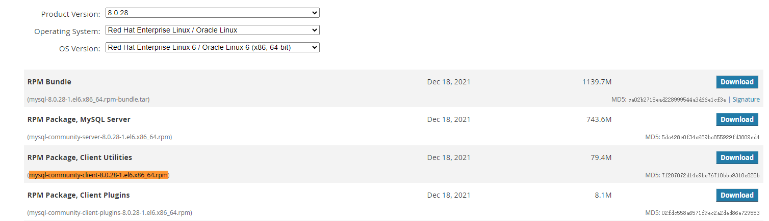

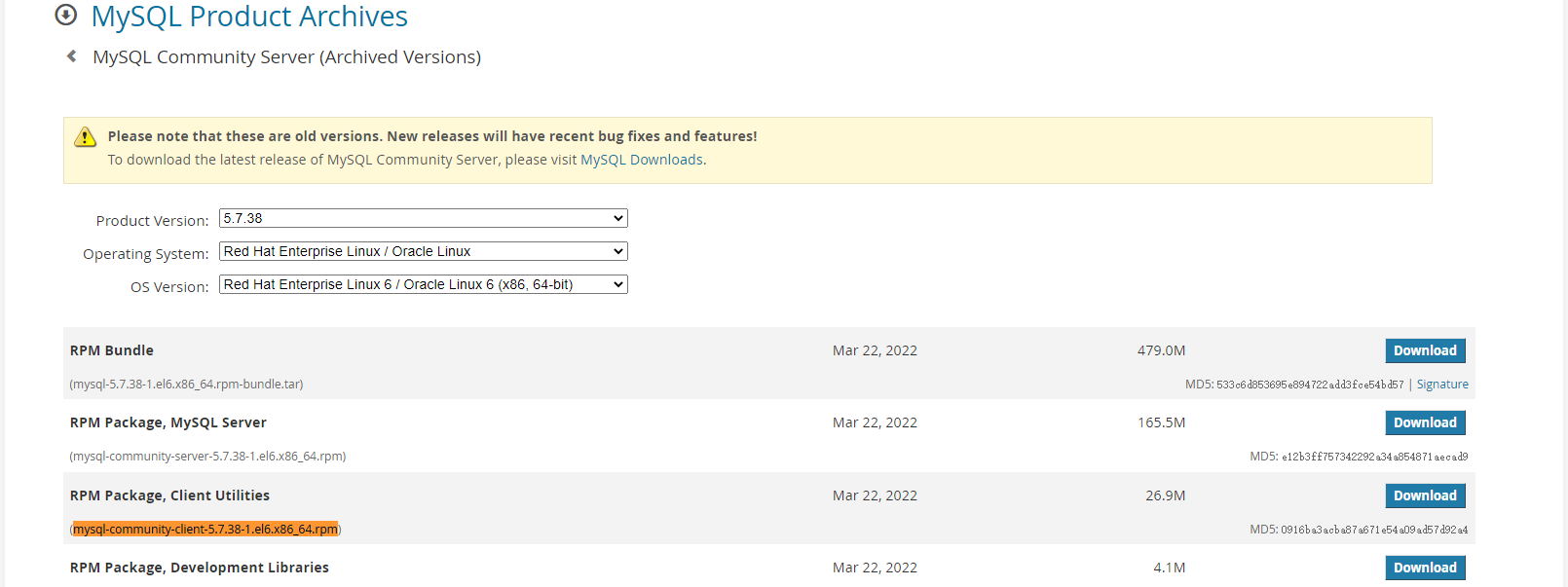

- Download a MySQL client installation package for Linux using a browser and upload the package to the ECS.
You can use any terminal connection tool, such as WinSCP and PuTTY, to upload the installation package to the ECS.
- MySQL 8.0:
Click here to download an installation package. mysql-community-client-8.0.28-1.el6.x86_64.rpm is used as an example.
Figure 8 Downloading a MySQL 8.0 installation package - MySQL 5.7:
Click here to download an installation package. mysql-community-client-5.7.38-1.el6.x86_64.rpm is used as an example.
Figure 9 Downloading a MySQL 5.7 installation package
- MySQL 8.0:
Figure 10 Installing a client - MySQL 5.7:
