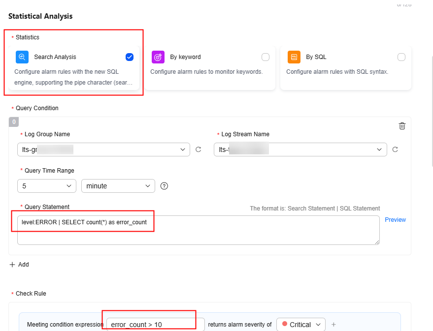

    Statistical Analysis
    Statistics
    Search Analysis: Configure alarm rules using the new SQL engine, which supports the combination of search and analysis statements with a pipe character (search | analysis).
    After an alarm rule is created, the statistics type cannot be changed. Plan the statistics type based on service requirements.

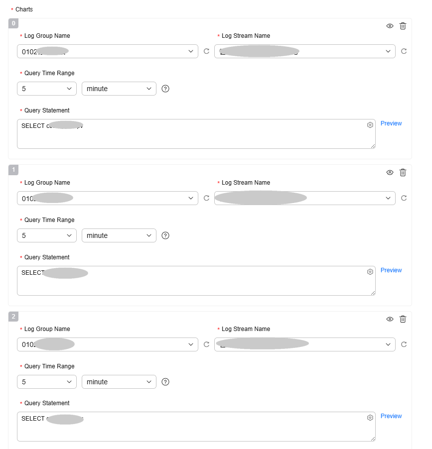

    Query Condition (Up to three query statements are supported.)
    Log Group Name: Select a log group.
    Log Stream Name: Select a log stream.
    Query Time Range: Specify the query period of the statement. It is one period earlier than the current time. For example, if Query Time Range is set to one hour and the current time is 9:00, the query statement period is 8:00–9:00.
    • If the unit is minute, the value ranges from 1 to 60.
    • If the unit is hour, the value ranges from 1 to 24.
    Query Statement: Enter a statement in the following format.
    Search statement | SQL analysis statement
    LTS monitors logs in the log stream based on the configured statement. After entering the query statement, click Preview to preview the query result. Set the check rule based on the fields in the preview result.
    To add multiple query conditions, repeat the preceding steps. For details about the IDs of multiple query conditions, see Figure 2. (The screenshot is for reference only.)
    Figure 2 Viewing the query condition numbers
    The number of the first query condition is 0, the number of the second condition is 1, and the number of the third condition is 2.
    Check Rule
    When the condition expression is met for the specified times in the specified queries, an alarm of the critical, major, minor, or info severity will be triggered.
    Enter a specific condition expression. When the expression execution result is true, an alarm is generated.
    • A condition expression cannot contain only digits or start with a digit.
    • The alarm severity can be Critical (default), Major, Minor, or Info.
    • An alarm is triggered when the number of specified queries and the number of the specified times are met. The number of specified queries must be greater than or equal to the number of the specified times. Furthermore, the minimum number of specified queries is 1 and the maximum number is 10.
    Click + to add a condition expression with an OR relationship. A maximum of 20 condition expressions can be added.
    Click to delete a condition expression.
    Basic syntax and cross-chart combination syntax are supported. When multiple query conditions are associated, the following format must be used to reference fields in condition expressions:
    ${Query condition No.}.{Query statement field}
    For example, to reference the pv field in the query statement * | select count(*) as pv of the first chart (chart 0), enter $0.pv.
    CAUTION:
    If multiple charts are used, condition expressions must contain $0, which indicates the first chart (chart 0).

  6. Click OK. The alarm rule is created and will be displayed on the Alarm Rules tab page.

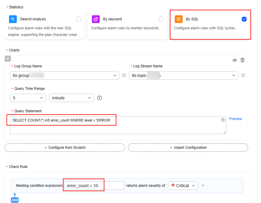

    Statistics
    By SQL: Use SQL analysis to configure an alarm rule.
    Charts
    Configure alarm-related charts.
    You can add a chart in these following two ways. If the logs in the log stream have not been structured, configure log structuring first. Up to three charts can be added. The chart and the SQL query statement in the chart cannot be left blank.
    • Configure from Scratch
      Click Configure from Scratch and set parameters as follows:
      • Log Group Name: Select a log group that has logs reported from the drop-down list.
      • Log Stream Name: Select a log stream of the log group from the drop-down list.
      • Query Time Range: Set this parameter to 1 to 60 minutes or 1 to 24 hours.
      • Query Statement: Enter a query statement. For details, see Using SQL Analysis Syntax.
    • Import Configuration
      Click Import Configuration. On the displayed Custom page, select a log group and stream, select a chart, and click OK.
      If there are no charts available or the charts do not fit your needs, click Create Chart. Configure the chart parameters, click OK, and click Save and Back in the upper right corner to return to the Create Alarm Rule right panel. You can see that the chart you just created has been selected, and the query statement has been filled in.
      Specify the query time range (1 to 60 minutes or 1 to 24 hours). When the query frequency is set to every 1 to 4 minutes, the query time range can only be set to a value no larger than 1 hour.
      • Click to go to the visualization page of the log stream.
      • Click to delete an added chart.
      • Click Preview to view the data after visual analysis. You must click Preview; otherwise, the alarm rule cannot be saved.
    To add more charts, repeat the preceding steps. For details about the numbers of multiple charts, see Figure 5.
    The number of the first chart is 0, the number of the second chart is 1, and the number of the third chart is 2.
    Figure 5 Viewing chart numbers
    Check Rule

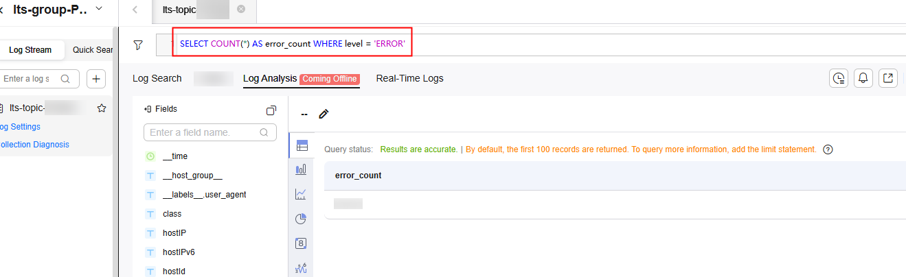

SQL statement:
SELECT COUNT(*) AS error_count WHERE level = 'ERROR'
The following query result indicates that the log level ERROR appeared 26 times in the target log stream.
Figure 11 Querying result
  • Query statement: Set the query time range to 5 minutes and run the statement SELECT count(*) as Error to collect statistics on the number of times that the keyword Error appears within 5 minutes. For more search syntax, see Using SQL Analysis Syntax.
    Figure 12 Query statement

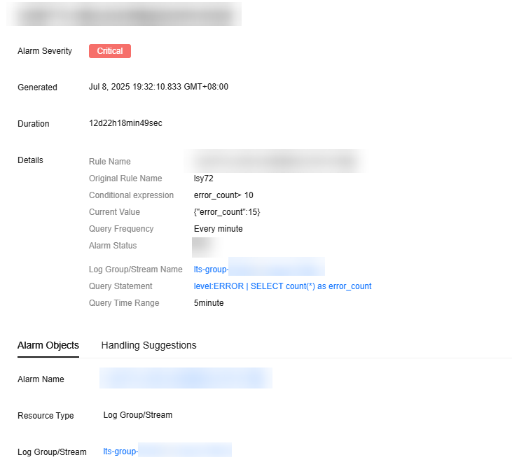

  • Alarm notification: After creating the preceding alarm rule, you will receive an alarm in the alarm list as long as the keyword Error appears 10 or more times in your logs. You can also click an alarm name to view the alarm details and sources.
    Figure 13 Alarm notification
Example: Setting an Alarm Rule Using a Search | Analysis Statement
This example guides you through setting up an alarm rule with a pipe-character-based statement (search | analysis statement) to trigger an alarm when the number of logs with an ERROR level reaches a specified threshold within a defined time range. This example is for reference only.

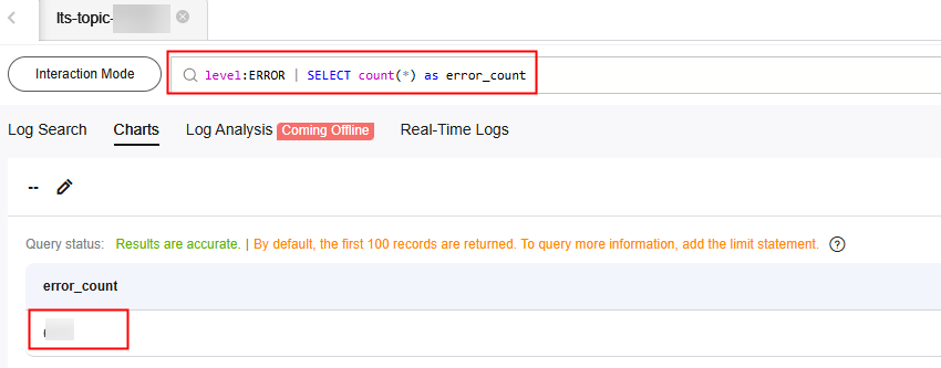

Search | analysis statement:
level:ERROR | SELECT count(*) as error_count
The following query result indicates that the log level ERROR appeared 123 times in the target log stream.
Figure 14 Query and analysis result
  • Query statement: Set the query time range to 5 minutes and execute the search | analysis statement to count ERROR level logs within that period. For details about the pipe character statement syntax, see Log Search and Analysis (Pipe Character).
    Figure 15 Query statement

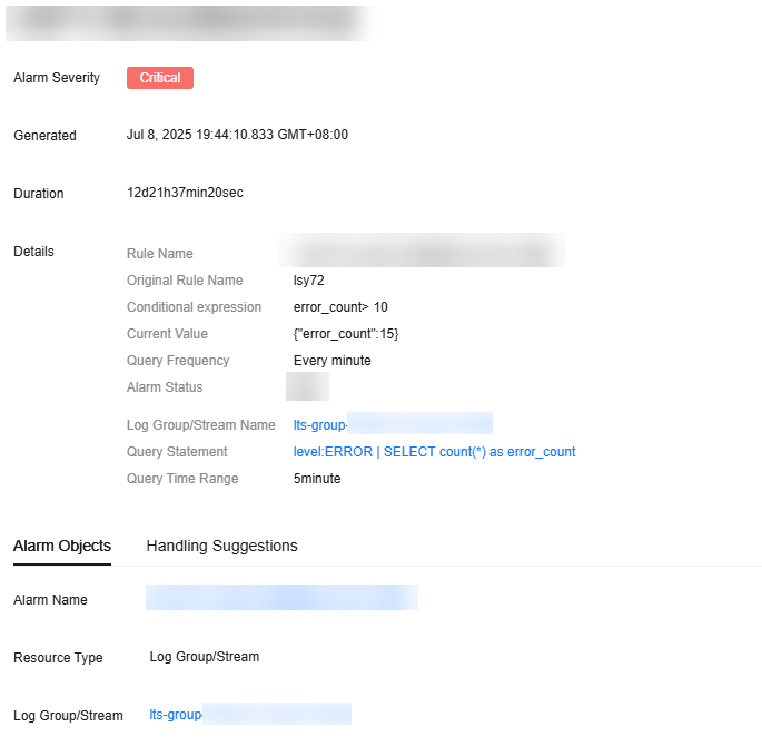

    Figure 16 Alarm notification
