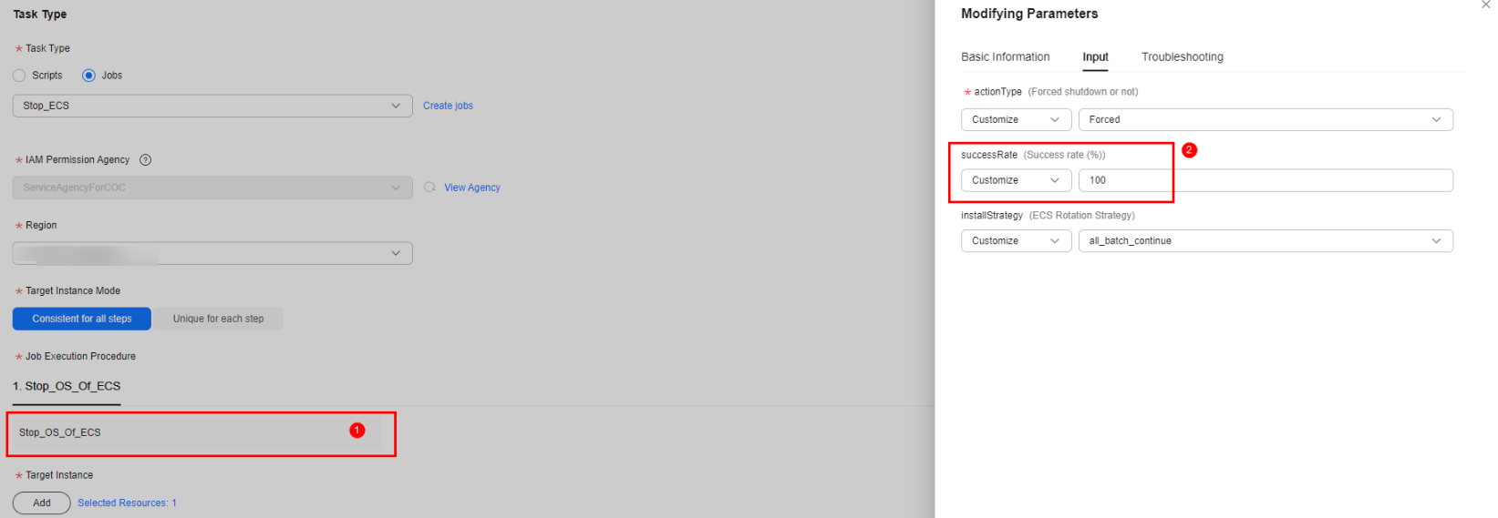

  9. Set Task Type.
    • Jobs: Select a job from the drop-down list. You can select a custom job or public job.
      Currently, jobs that reference global parameters and jobs without target instances are not supported.
      If you select a job to set a scheduled task and want to use the suspension policy in the script scenario, set a parameter in the specific job step. For example, if you want to stop an ECS, set the successRate parameter.
      Figure 1 Setting the suspension policy for stopping a scheduled ECS job
