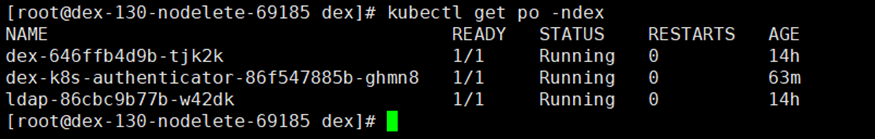

  3. Install Dex based on the custom configuration.
    helm install dex dex/dex --namespace dex --create-namespace --version 0.19.1 --values dex-values.yaml
    View the installed releases.
    helm list

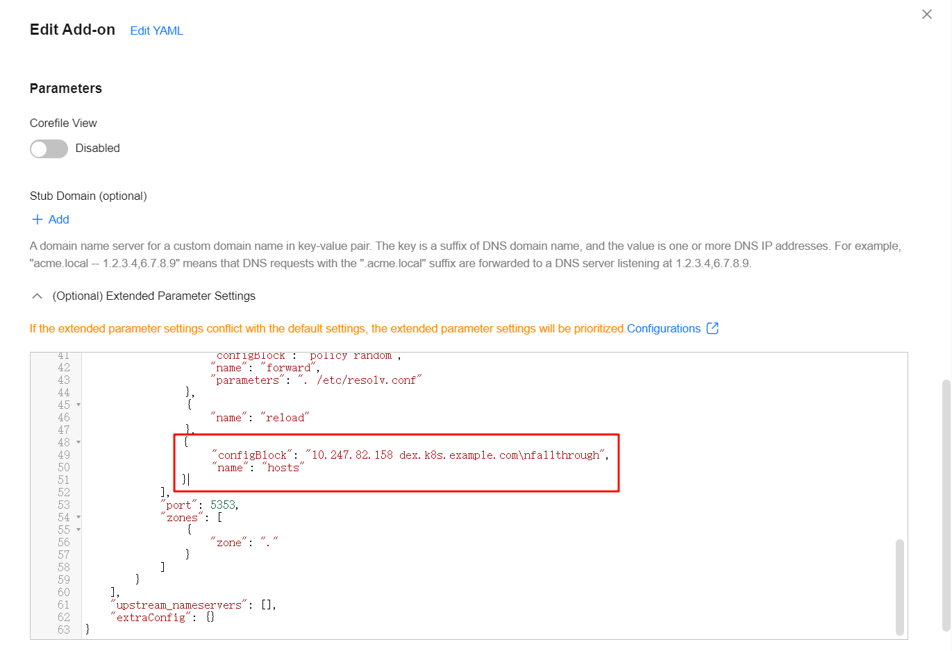

Step 3: Configure Intra-Cluster Domain Name Resolution
  1. Log in to the CCE console and click the cluster name to access the cluster console.
  2. In the navigation pane, choose Add-ons. Then, click Edit under CoreDNS.
  3. In the Parameters area, edit the extended parameters and add the following content to the plugins field to configure the Dex service domain name resolution:
      "configBlock": "10.247.82.158 dex.k8s.example.com\nfallthrough",
      "name": "hosts"
    10.247.82.158 is the ClusterIP of the nginx-ingress-controller Service.
  4. Click OK.

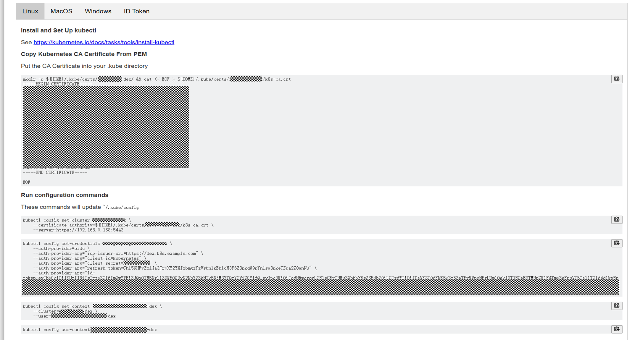

Step 4: Deploy the dex-k8s-authenticator Application
  1. Add a Helm repository.
    helm repo add skm https://charts.sagikazarmark.dev
    helm repo update
  2. Create an authen-values.yaml file to configure the dex-k8s-authenticator parameter. For details about the configuration example, see dex-k8s-authenticator.
    config:
      clusters:
        - name: Hello-CCE
          short_description: "Your cluster"
          issuer: https://dex.k8s.example.com    # Domain name for accessing Dex
          client_id: kubernetes                  # Client ID in Dex config in Step 2: Deploy a Dex Application.
          client_secret: *****                   # Client secret in Dex config in Step 2: Deploy a Dex Application.
          redirect_uri: https://login.k8s.example.com/callback        # Domain name for accessing dex-k8s-authenticator
          k8s_master_uri: https://192.168.0.158:5443                  # Address for accessing the cluster API server
          # CA certificate of the cluster
          k8s_ca_pem: |
            -----BEGIN CERTIFICATE-----
            -----END CERTIFICATE-----
      # If HTTPS is used for Dex access, the CA certificate of the Dex domain name must be provided.
      trusted_root_ca: |
    ingress:
      enabled: true
      className: nginx
      hosts:
        - host: login.k8s.example.com # Change the value to the domain name for accessing dex-k8s-authenticator.
          paths:
            - path: /
              pathType: ImplementationSpecific
      tls:
        - secretName: dex.example.com.tls  # Dex access key created in Step 1: Create a Key (Skip This Step If You Already Have a Certificate)
          hosts:
            - login.k8s.example.com    # Change the value to the domain name for accessing dex-k8s-authenticator.
  3. Install dex-k8s-authenticator based on the custom configuration.
    helm install dex-k8s-authenticator skm/dex-k8s-authenticator --namespace dex --version 0.0.3 --values authen-values.yaml

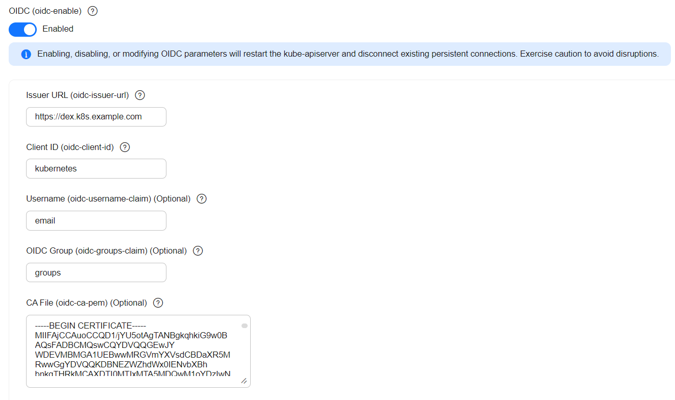

Step 5: Modify the Startup Parameters of the Cluster API Server
  2. In the navigation pane, choose Settings.
  3. Click the Cluster Access tab, enable OIDC, and configure the parameters required for kube-apiserver to use OIDC.
    Parameter
    Description
    Example Value
    Issuer URL (oidc-issuer-url)
    The URL for OIDC authentication. It must be HTTPS-compliant.
    Client ID (oidc-client-id)
    Client ID registered with the OIDC authentication service. For example, the client ID registered in Step 2: Deploy a Dex Application is kubernetes.
    kubernetes
    Username (oidc-username-claim)
    The value to be used as the username. You need to specify a field in JWT claims for it. The default value is sub. It is typically the unique identifier of the end user. You can also select other fields, such as email or name.
    You can grant Kubernetes permissions based on the username in the cluster. For details, see Step 6: Grant Kubernetes Permissions to a Third-Party User.
    email
    Setting the parameter to email means that the value of the email field (the email address) in the JWT claim is used as the username.
    OIDC Group (oidc-groups-claim)
    The value to be used as the user group. You need to specify a field in JWT claims for it. The field name of the user group is typically groups. You can grant Kubernetes permissions based on the user group. For details, see Step 6: Grant Kubernetes Permissions to a Third-Party User.
    groups
    Setting this parameter to groups means that the value of groups in the JWT claim is used as the user group.
    CA File (oidc-ca-pem)
    A CA certificate in PEM format. It is used to sign the identity provider's web certificate.
    CA certificate of the Dex domain name in Step 1: Create a Key (Skip This Step If You Already Have a Certificate)
  4. Click Confirm Settings.

  1. Open a browser and enter the dex-k8s-authenticator domain name in the address bar. In this example, the domain name is login.k8s.example.com.
  2. Enter the username and password of a user in the CCE user group in LDAP.
  3. Run commands by following the instructions. After the login is successful, dex-k8s-authenticator provides executable commands to help you configure the kubeconfig file.
  4. After the kubeconfig file is configured, access Kubernetes resources for testing using kubectl.
