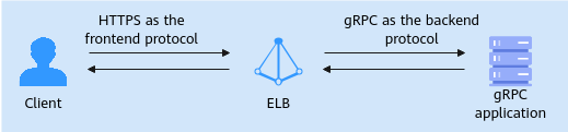

If your company deploys a gRPC application on an ECS in a region and creates a load balancer in the VPC where the ECS is running, you can add an HTTPS listener to the load balancer, create a gRPC backend server group, and add the ECS to this backend server group. Then the load balancer can route gRPC requests to this ECS, which processes these requests and returns responses back to clients.
Figure 1 Accessing the gRPC application through ELB

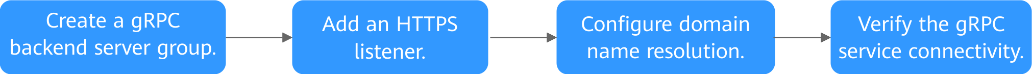

Figure 2 Procedure for forwarding gRPC requests

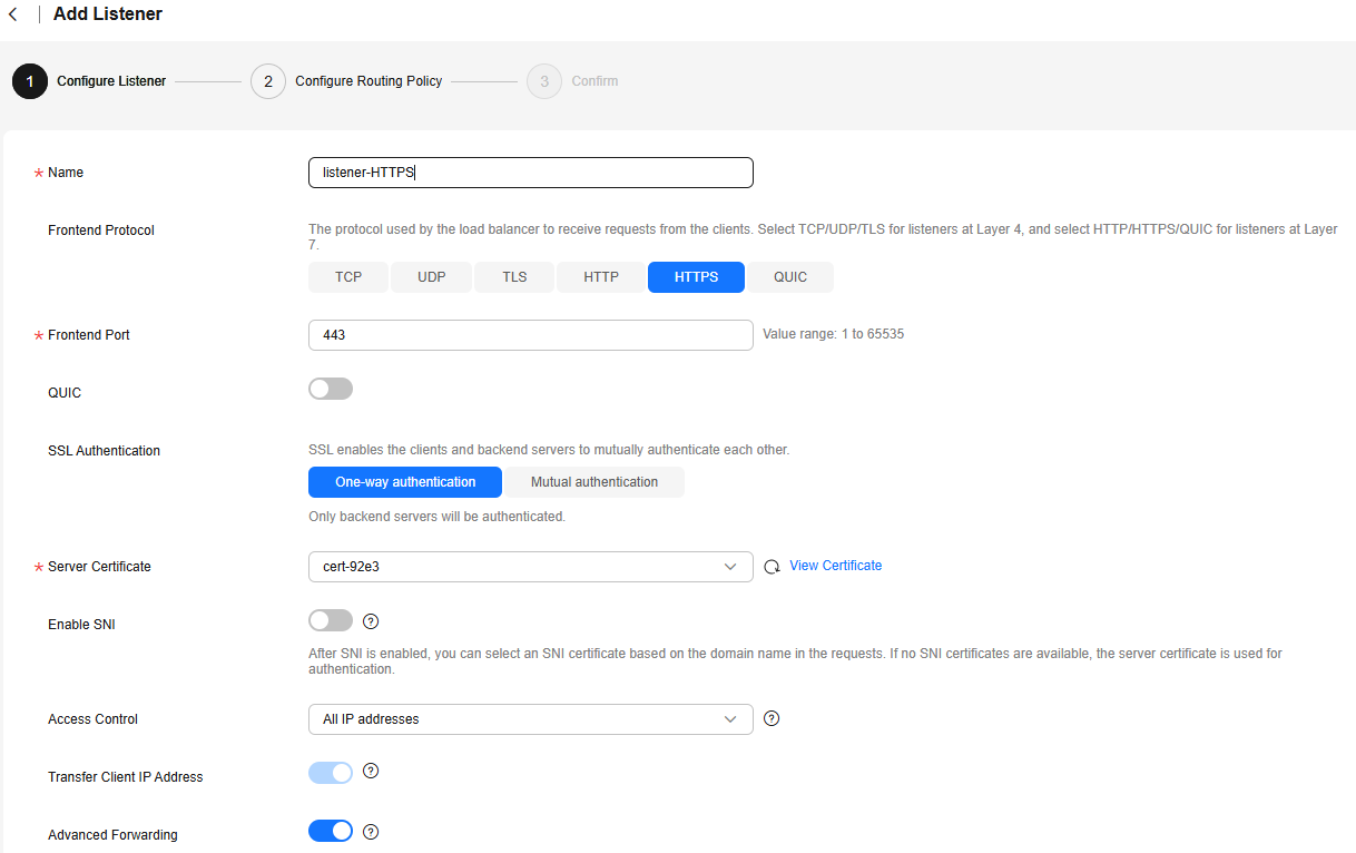

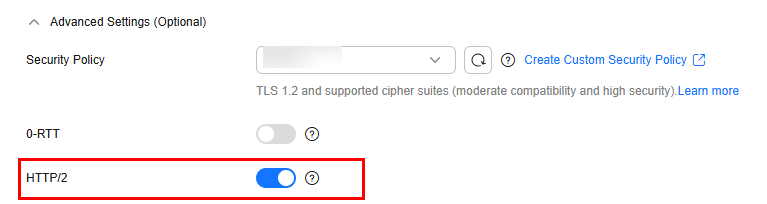

  3. On the Add Listener page, set Frontend Protocol to HTTPS and enable HTTP/2 in More (Optional).
    Figure 3 Configuring one-way authentication
    Figure 4 Enabling HTTP/2

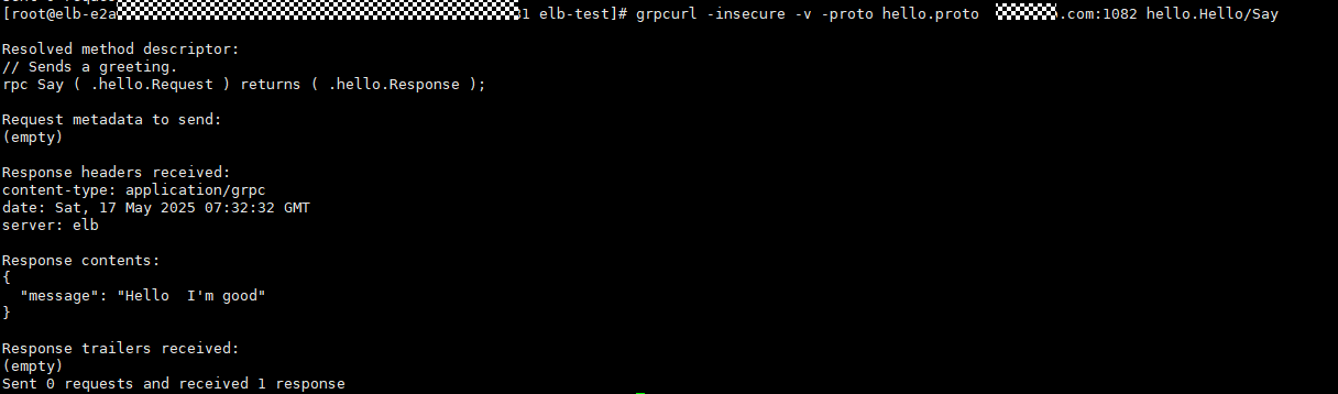

  3. Run the following command on the client to access the gRPC service on the backend server:
    grpcurl -insecure -proto <.proto-file> <domain-name>:<listening-port> <gRPC-service-name>/<method>
    If information similar to the following is displayed, the client can access the backend server where the gRPC service is deployed through ELB.
    Figure 6 Verifying the access to the gRPC service
