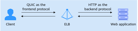

You can add a QUIC listener to forward requests. The Quick UDP Internet Connection (QUIC) is a UDP-based protocol at the transport layer. It improves congestion control and does not depend on kernel protocols.
QUIC features low latency and avoids head-of-line blocking. It makes video and page loading faster, improving network performance and data security.

Step 3: Add a QUIC Listener
- Go to the load balancer list page.
- Locate the target load balancer and click Add Listener in the Operation column.
- On the Add Listener page, set the protocol to QUIC and port to 442.
Figure 2 Adding a QUIC listener
- Click Next: Configure Request Routing Policy and select Use existing for Backend Server Group. Select the HTTP backend server group you have created and click Next: Confirm.
- Confirm the configurations and click Submit.

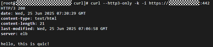

Step 4: Verify QUIC Connections
- Run the following command to access the EIP and listening port of the load balancer:
curl --http3-only -k -i https://<EIP>:<PORT>
- If the page shown in Figure 3 is displayed, the client and backend server communicate with each other using HTTP/3 through QUIC negotiation.
