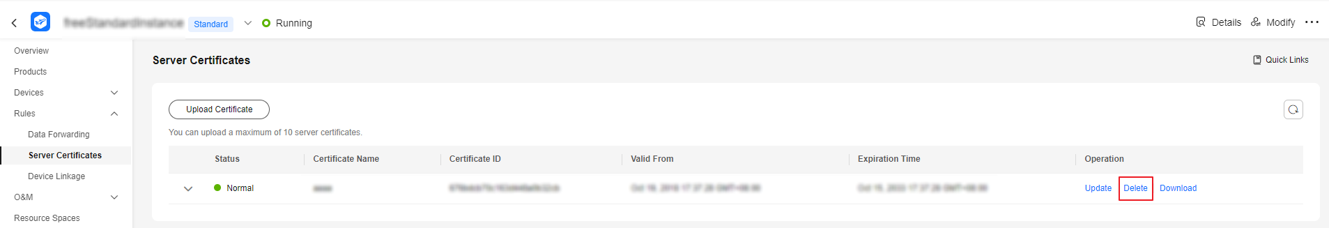

Deleting a Certificate
You can delete a certificate that is no longer used.
After a certificate is deleted, the push to the application server may fail. Back up related data before the deletion.
Figure 2 CA certificate - Deleting a certificate
