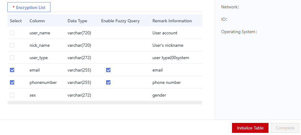

- Click the Encryption List tab, select columns to be encrypted, and set whether to enable fuzzy search.
After encryption, fuzzy search cannot be performed by default. If the following conditions are met, select Enable Fuzzy Search. Fuzzy search supports % and _.
- The ciphertext is encoded in hexadecimal format and does not support BASE64 encoding. For details, see Setting Encryption Parameters.
- The field is of the string type (varchar). Other types are not supported.
Figure 3 Selecting columns to be encrypted
- Click Initialize Table to initialize the data table.
- Click Complete.
