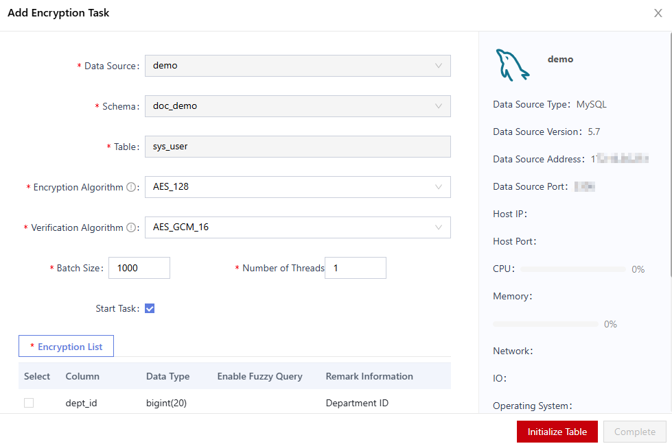

- Click Add Encryption Task in the upper right corner.
- In the displayed dialog box, set encryption information. For details about the related parameters, see Table 1.
Table 1 Adding an encryption task Parameter
Description
Data Source
Name of an asset.
Schema
Name of the schema of the asset.
Table
Table name of an asset.
Encryption Algorithm
Select an encryption algorithm from the drop-down list box.
You can view the supported algorithm types on the Checking the Encryption Algorithm page.
Verification Algorithm
Select a verification algorithm from the drop-down list.
The verification algorithm is used to verify the integrity of important data. You can view the supported algorithm types on the Checking the Encryption Algorithm page.
Batch Size
Set the amount of data processed for each batch in the encryption task.
Number of Threads
Number of threads occupied by the encryption task.
Start Task
If this parameter is selected, the task is automatically started after being created.
Figure 1 Adding an encryption task

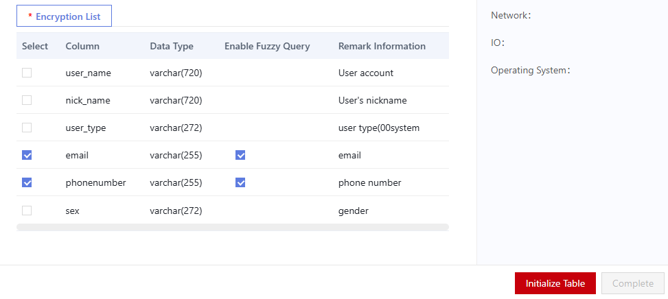

- Click the Encryption List tab, select columns to be encrypted, and set whether to enable fuzzy search. Figure 2 Selecting columns to be encrypted
After encryption, fuzzy search cannot be performed by default. In the cases below, you can select Enable Fuzzy Query to perform fuzzy search, which supports % and _ characters.- The ciphertext is encoded in hexadecimal format and does not support Base64 encoding. For details, see Setting Encryption Parameters.
- The field is of the string type, for example, varchar and text. Other types are not supported.
- Click Initialize Table to initialize the data table.
- Click Complete.
