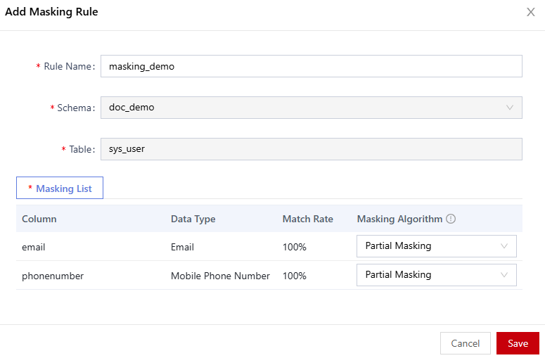

Step 3: Creating a Masking Rule in the Discovery Result
  1. Log in to the web console of the instance as user sysadmin.
  2. In the navigation tree on the left, choose Sensitive Data Discovery > Sensitive Data Scanning.
  3. On the scan task list page, locate the target data asset and click View.
  4. On the scan result page, locate the target database table and click Add Masking Rule.
  5. In the Add Masking Rule dialog box, configure the masking information.
    Figure 4 Adding a masking rule
  6. Configure the rule name and select the masking algorithm corresponding to the data type from the masking list.
  7. Click Save.
The masking rule is automatically enabled after being saved. If plaintext data is queried during database access, the masking results of the data will be retrieved. In this case, you can configure a masking allowlist. If a data record matches the allowlist, it will not be masked.
