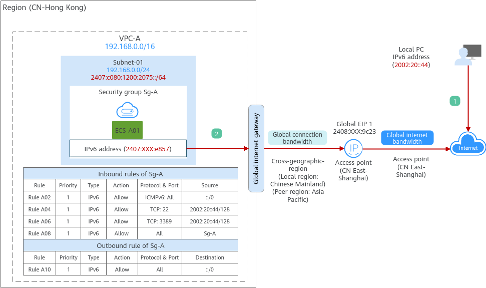

Figure 1 shows the IPv6 network architecture in this example. The network communication requirements are as follows:
- The local PC (IPv6 address: 2002:20::44) can remotely log in to ECS-A01 across regions.
- ECS-A01 can access the Internet across regions.

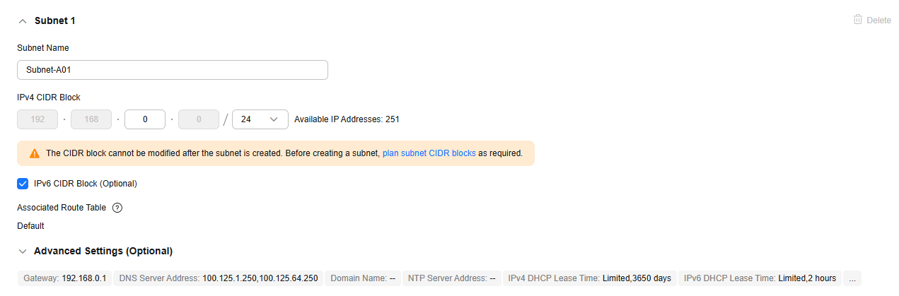

In this example, you need to create a VPC and subnet, and enable IPv6 for this subnet.
Figure 2 Setting a subnet

Table 2 Subnet parameters Parameter
Example Value
Description
Subnet Name
Subnet-A01
The subnet name.
The name can be modified after the subnet is created.
IPv4 CIDR Block
192.168.0.0/24
The IPv4 CIDR block of the subnet, which is a unique CIDR block with a range of IP addresses in the VPC.
The CIDR block cannot be changed after the subnet is created.
IPv6 CIDR Block (Optional)
Enabled
Whether to automatically assign an IPv6 CIDR block to the subnet.
You can enable or disable this option after the subnet is created.
Associated Route Table
Default
The default route table that the subnet is associated with. Each VPC comes with a default route table. Subnets in the VPC are then automatically associated with the default route table.
The default route table has a preset system route that allows subnets in a VPC to communicate with each other.
After the subnet is created, you can create a custom route table and associate the subnet with it.
Advanced Settings (Optional) > Gateway
192.168.0.1
The gateway address of the subnet. You are advised to retain the default address.
The gateway address cannot be changed after the subnet is created.
Advanced Settings (Optional)- DNS Server Address
- Domain Name
- NTP Server Address
- IPv4 DHCP Lease Time
No configuration is required.
The parameters that are configured for the ECS in the VPC. In this example, retain the default values or leave them blank.
You can change the values after the subnet is created.
Advanced Settings (Optional) > Tag
The tag that is used to classify and identify resources. Add tags to the subnet as required.
After the subnet is created, you can edit tags added to the subnet.
Advanced Settings (Optional) > Description
Supplementary information about the subnet. Enter a description as required.
The description can be modified after the subnet is created.

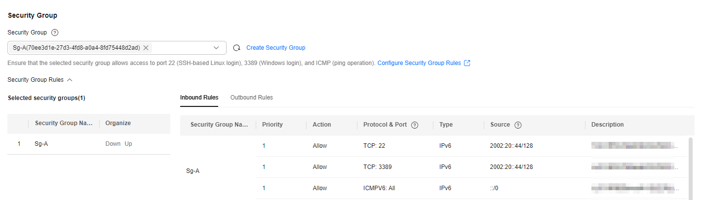

- Security Group: Create security group Sg-A and add inbound and outbound rules to it. Each security group comes with system rules. You need to check and modify the rules as required to ensure that all rules in Table 3 are added. Figure 4 Inbound rules

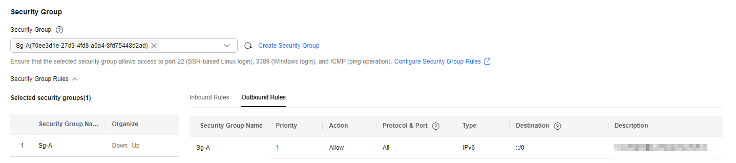

Figure 5 Outbound rules
Table 3 Security group Sg-A rules Direction
Action
Type
Protocol & Port
Source/Destination
Description
Inbound
Allow
IPv6
TCP: 22
Source: 2002:20::44/128
Allows the local PC (2002:20::44/128) to remotely log in to the Linux ECS over SSH port 22 using an IPv6 address.
Inbound
Allow
IPv6
TCP: 3389
Allows the local PC (2002:20::44/128) to remotely log in to the Windows ECS over RDP port 3389 using an IPv6 address.
Inbound
Allow
IPv6
ICMPv6: All
Source: ::/0
Allows IPv6 ping traffic to the ECS in the security group over all ICMP ports to test the ECS network connectivity.
Inbound
Allow
IPv6
All
Source: current security group (Sg-A)
Allows the ECSs in the security group to communicate with each other using IPv6 addresses.
Outbound
Allow
IPv6
All
Destination: ::/0
Allows the ECS in the security group to access the external networks using an IPv6 address.

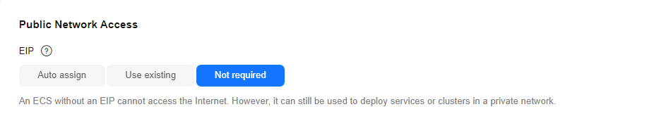

- EIP: Select Not required. Figure 6 Selecting Not required

Step 4: Bind the Global EIP to an ECS and a Global Internet Gateway
- Go to the global EIP list page.
- In the global EIP list, search for G-EIP1 to locate it.
- Locate the row that contains G-EIP1 and click Bind Instance in the Progress column.
The page for binding an instance is displayed.
- Configure the parameters as follows:
- Instance Region: Select the region where ECS-A01 is located.
- Instance Type: Select ECS (IPv6) and select ECS-A01.
- Global Internet Gateway: Select IGW-A created in Step 2: Create a Global Internet Gateway and Add an IPv6 Route.
- Click Next.
- On the Bind Global Connection Bandwidth page, create a global connection bandwidth to be bound to the global EIP.
Table 7 Parameter descriptions Parameter
Example Value
Description
EIP Region
The region is determined by that of G-EIP1 and does not need to be configured.
Instance Region
The region is determined by that of ECS-A01 and does not need to be configured.
Bandwidth Type
The value is determined by the access point of the global EIP and the region where the instance is located. You do not need to set it.
Assign now
Select Assign now to create a global connection bandwidth.
Bandwidth Name
Bandwidth-A
Enter the name of the global connection bandwidth as required. The name:- Can contain 0 to 64 characters.
- Can contain letters, digits, underscores (_), hyphens (-), and periods (.).
This parameter can be modified after the global connection bandwidth is created.
Bandwidth (Mbit/s)
300
Select the size of the global connection bandwidth as required.
- Click Finish.
In the global EIP list, you can see that the global EIP has an instance bound.
Step 5: Test Network Connectivity
- Check whether you can log in to ECS-A01 using its IPv6 address.
Multiple methods are available for logging in to an ECS. For details, see Logging In to an ECS.

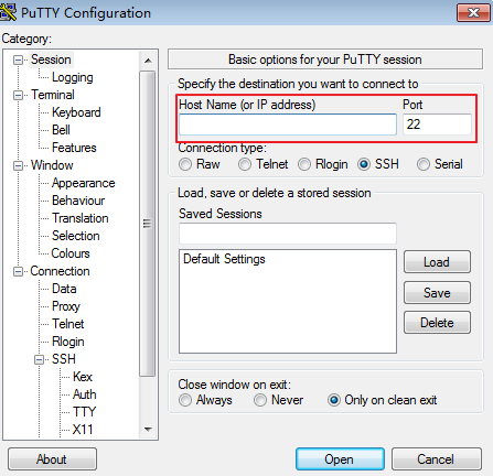

Use PuTTY to remotely log in to ECS-A01 using the IPv6 address.
Enter the IPv6 address of ECS-A01 under Host Name (or IP address), for example, 2407:XXX:e857.
Figure 7 PuTTY Configuration
- Test the network connectivity between ECS-A01 and the Internet using an IPv6 address:
In this example, 2002:20::45 is used as a public IP address. An example command is as follows:
ping6 2002:20::45
If information similar to the following is displayed, ECS-A01 can communicate with the Internet using the IPv6 address.[root@ecs-a01 ~]# ping6 2002:20::45 PING 2002:20::45(2002:20::45) from 2002:20::45 : 56 data bytes 64 bytes from 2002:20::45: icmp_seq=1 ttl=64 time=0.770 ms 64 bytes from 2002:20::45: icmp_seq=2 ttl=64 time=0.295 ms 64 bytes from 2002:20::45: icmp_seq=3 ttl=64 time=0.245 ms ^C --- 2002:20::45 ping statistics --- 3 packets transmitted, 3 received, 0% packet loss, time 2080ms rtt min/avg/max/mdev = 0.245/0.436/0.770/0.237 ms
If your access using an IPv6 address is abnormal, refer to Why Can't I Access Websites Using IPv6 Addresses After IPv4/IPv6 Dual Stack Is Configured?
