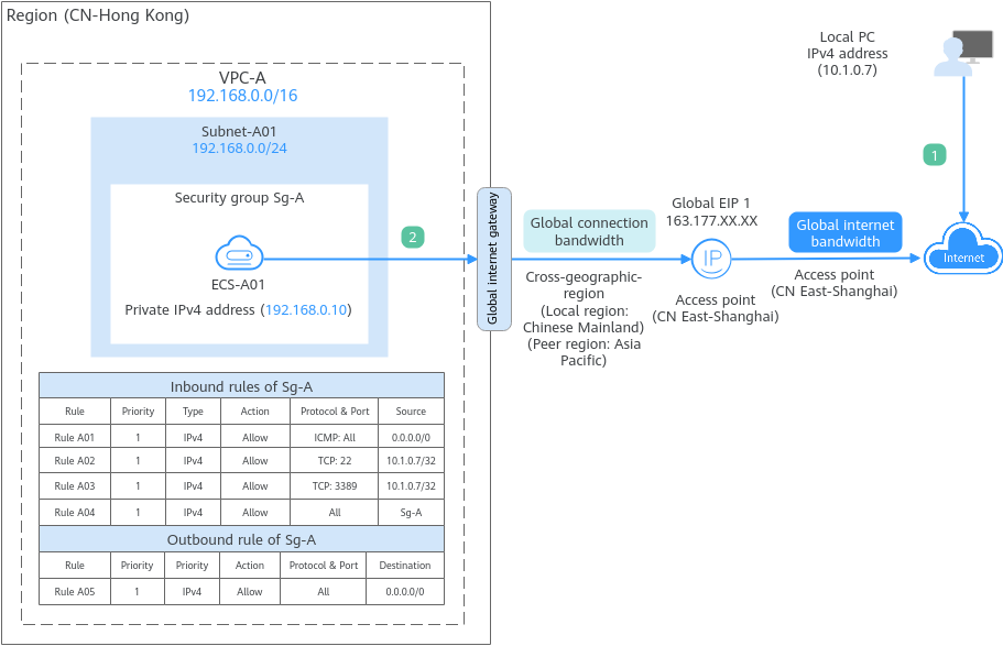

Figure 1 shows the IPv4 network architecture in this example. The network communication requirements are as follows:
Figure 1 IPv4 network architecture (VPC, ECS, and global EIP)
  1. The local PC (IP address: 10.1.0.7) can remotely log in to ECS-A01 across regions.
  2. ECS-A01 can access the Internet across regions.

Step 4: Bind the Global EIP to an ECS and a Global Internet Gateway
  1. Go to the global EIP list page.
  2. In the global EIP list, search for G-EIP1 to locate it.
  3. Locate the row that contains G-EIP1 and click Bind Instance in the Progress column.
    The page for binding an instance is displayed.
  4. On the Bind Instance page, configure the parameters.
    • Instance Region: Select the region CN-Hong Kong where ECS-A01 is located.
    • Instance Type: Select ECS (IPv4) and select ECS-A01.
    • Global Internet Gateway: Select IGW-A created in Step 2: Create a Global Internet Gateway.
  5. Click Next.
  6. On the Bind Global Connection Bandwidth page, create a global connection bandwidth to be bound to the global EIP.
    Table 6 Parameter descriptions
    Parameter
    Example Value
    Description
    EIP Region
    No configuration is required.
    The region is determined by that of G-EIP1 and does not need to be configured.
    Instance Region
    The region is determined by that of ECS-A01 and does not need to be configured.
    Bandwidth Type
    The value is determined by the access point of the global EIP and the region where the instance is located. You do not need to set it.
    Assign now
    Select Assign now to create a global connection bandwidth.
    Bandwidth Name
    Bandwidth-A
    Enter the name of the global connection bandwidth as required. The name:
    • Can contain 0 to 64 characters.
    • Can contain letters, digits, underscores (_), hyphens (-), and periods (.).
    This parameter can be modified after the global connection bandwidth is created.
    Bandwidth (Mbit/s)
    300
    Select the size of the global connection bandwidth as required.
  7. Click Finish.
    In the global EIP list, you can see that the global EIP has an instance bound.
Step 5: Test Network Connectivity
  1. Use the local PC to remotely log in to ECS-A01.
    Multiple methods are available for logging in to an ECS. For details, see Logging In to an ECS.
  2. Test the network connectivity between ECS-A01 and the Internet:
    ping <IPv4-public-address-or-domain-name>
    Example command:
    ping support.huaweicloud.com
    If information similar to the following is displayed, ECS-A01 can communicate with the Internet.
    [root@ecs-a01 ~]# ping support.huaweicloud.com
    PING hcdnw.cbg-notzj.c.cdnhwc2.com (203.193.226.103) 56(84) bytes of data.
    64 bytes from 203.193.226.103 (203.193.226.103): icmp_seq=1 ttl=51 time=2.17 ms
    64 bytes from 203.193.226.103 (203.193.226.103): icmp_seq=2 ttl=51 time=2.13 ms
    64 bytes from 203.193.226.103 (203.193.226.103): icmp_seq=3 ttl=51 time=2.10 ms
    64 bytes from 203.193.226.103 (203.193.226.103): icmp_seq=4 ttl=51 time=2.09 ms
    --- hcdnw.cbg-notzj.c.cdnhwc2.com ping statistics ---
    4 packets transmitted, 4 received, 0% packet loss, time 3004ms
    rtt min/avg/max/mdev = 2.092/2.119/2.165/0.063 ms
