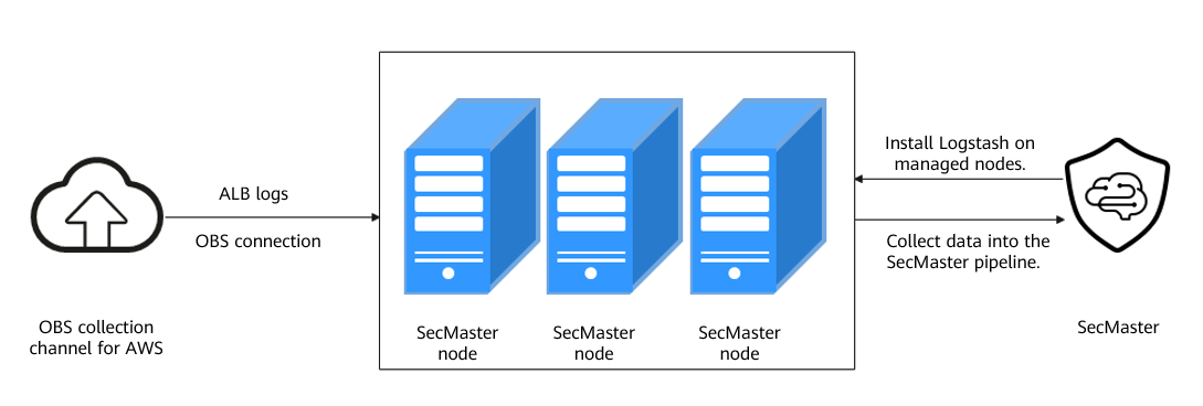

This section describes how to integrate Amazon Web Services (AWS) Application Load Balancer (ALB) logs into SecMaster.
SecMaster can integrate AWS object storage logs. It uses the AWS ALB log parser to parse logs and transfer them into the SecMaster pipeline. After enabling log integration, you can query them on the page.

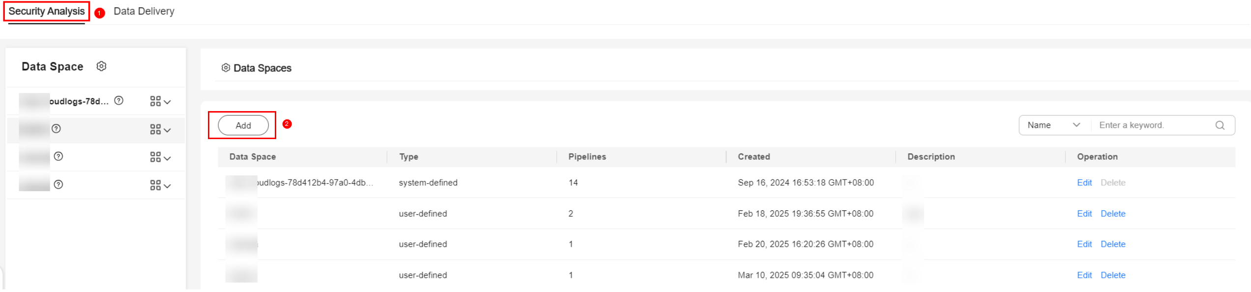

- Add a data space.
- In the upper left corner of the data space list, click Add. The Add Data Space panel is displayed on the right. Figure 3 Add Data Space
- On the Add Data Space panel, set the parameters for the new data space.

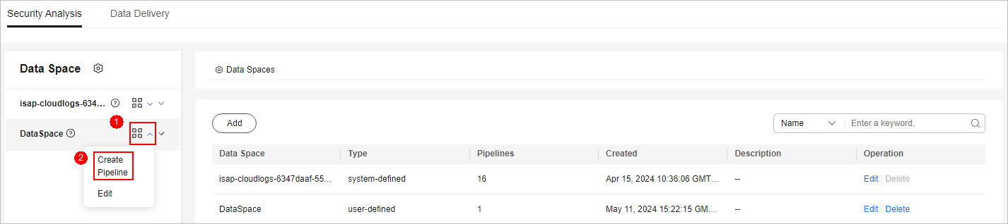

- In the data space navigation tree on the left, locate the data space added in 8.b, click
next to the data space name, and select Create Pipeline from the drop-down list. Figure 4 Creating a pipeline
- On the Create Pipeline page, configure pipeline parameters. For details about the parameters, see Table 2.

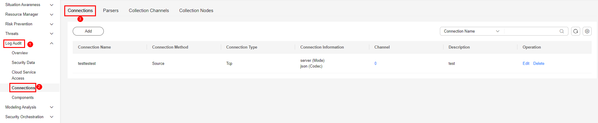

- Go to the workspace management page. In the navigation pane on the left, choose . Figure 5 Accessing the Connections page
- Add a source for the data connection.
- On the Connections tab, click Add.
- Configure the data connection source details.

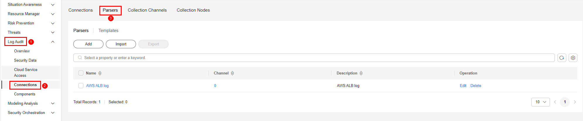

- Parameters for adding a parser Create a parser from template AWS ALB log.

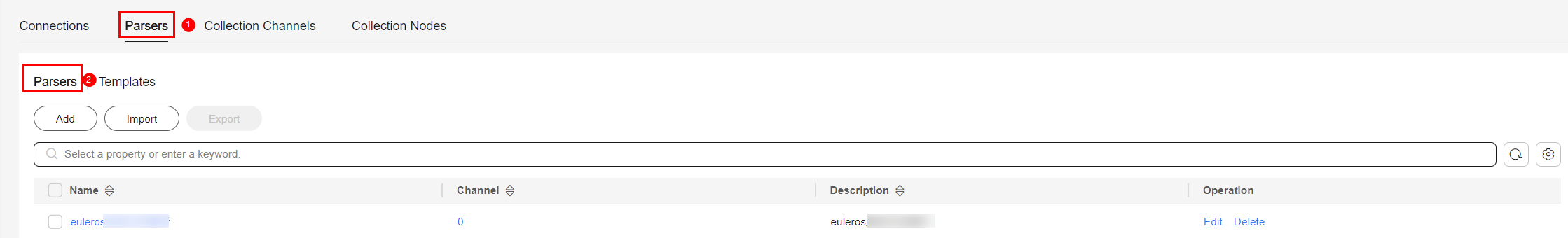

- Go to the target workspace management page. In the navigation pane on the left, choose . On the displayed page, click the Parsers tab.
Figure 6 Accessing the Parsers tab
- On the Parsers tab, click the Templates tab. In the Operation column of the parser template named AWS ALB log, click Create by Template. The Create Parser page is displayed.
- On the Create Parser page, configure parser parameters.
- Name: Retain the default value, which is AWS ALB log.
- Description: Retain the default value. The default value is AWS ALB log.
- Parsing rule: Retain the default value.
- Click OK. Return to the page to check the created parser.
Figure 7 Checking the created parser

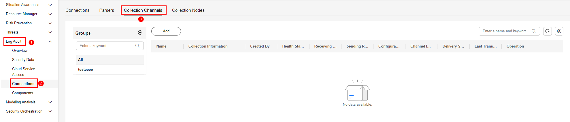

- Configure log collection channels, connect each functional component, and ensure that SecMaster and log collectors work properly.
- Go to the workspace management page. In the navigation pane, choose . On the displayed page, click the Collection Channels tab. Figure 8 Accessing the Collection Channels tab

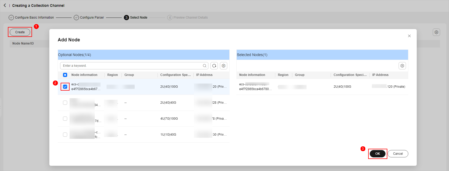

- On the Select Node page, click Create. In the displayed dialog box, select the ECS node managed in 6 and click OK. Figure 9 Selecting a node
- Click Next in the lower right corner of the page.

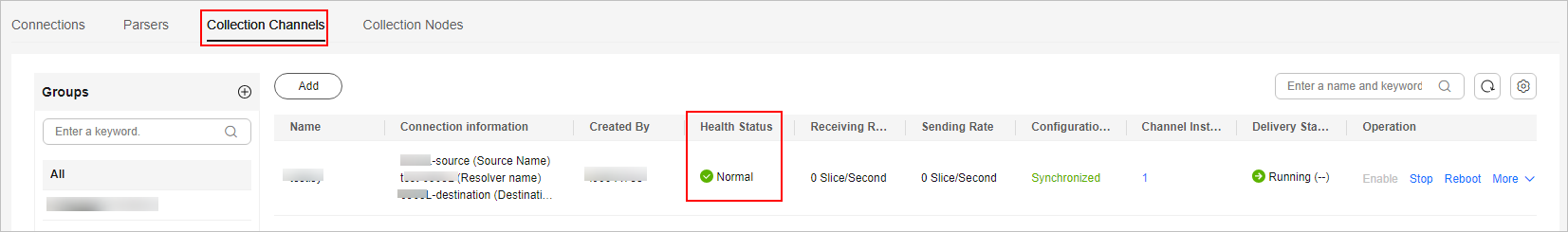

- On the Collection Channels tab, if the health status of a collection channel is Normal, the collection channel is successfully delivered. Figure 10 Collection channels configured
