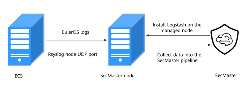

This topic describes how to integrate EulerOS logs into SecMaster.
Rsyslog is used to remotely collect logs, send logs on tenant ECSs to the corresponding SecMaster nodes over UDP ports after parsing using the EulerOS system log parser provided by collection management. After enabling log integration, you can query them on the page. The procedure is as follows.

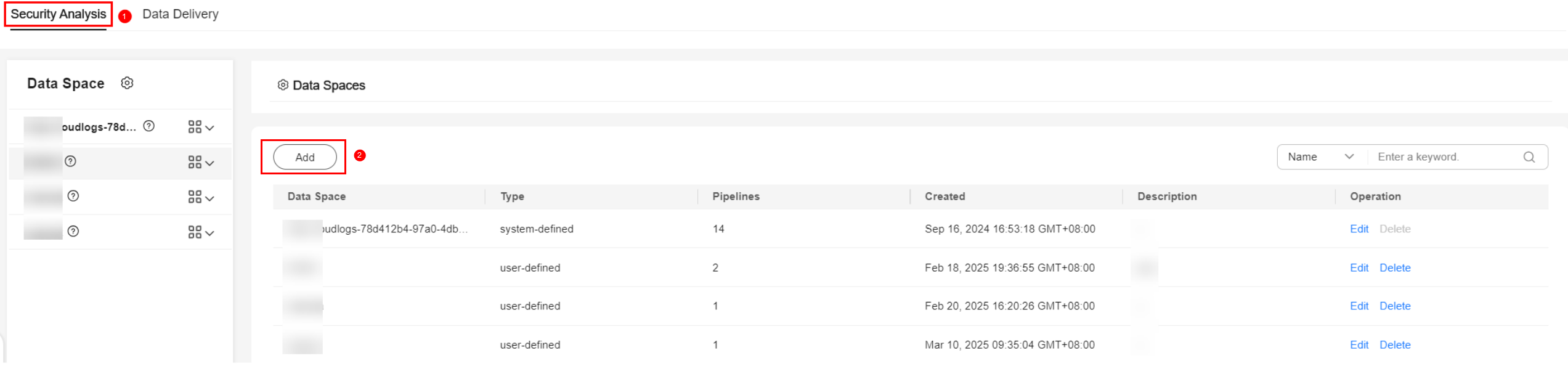

- Add a data space.
- In the upper left corner of the data space list, click Add. The Add Data Space panel is displayed on the right. Figure 3 Add Data Space
- On the Add Data Space panel, set the parameters for the new data space.

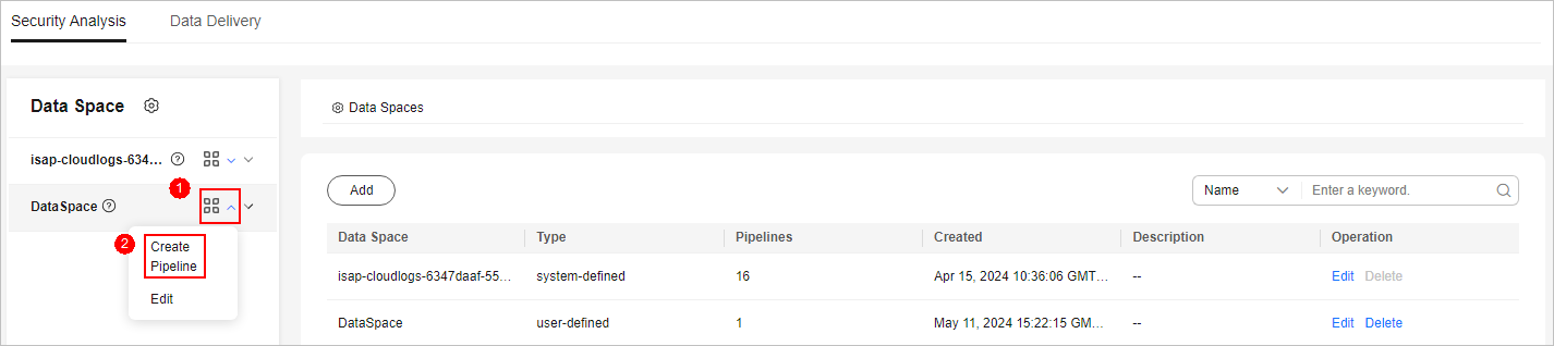

- In the data space navigation tree on the left, click
on the right of the data space name created in 8.b and select Create Pipeline. Figure 4 Creating a pipeline
- On the Create Pipeline page, configure pipeline parameters. For details about the parameters, see Table 3.

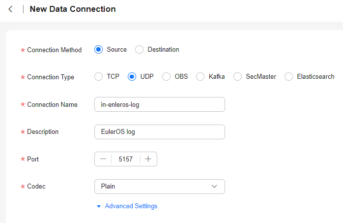

- Add a source for the data connection.
- On the Connections tab, click Add.
- Configure the data connection source details. Figure 6 Source
The following uses UDP as an example to describe how to add a log data source. For details about other connection types, see Connector Rules.
Table 4 Log source settings Parameter
Description
Connection Method
Select Source.
Connection Type
Select UDP.
Connection Name
Name of the data connection source. In this example, in-euleros-log is used.
Description
Enter a brief description of the data source. In this example, "EulerOS logs" are used.
Port
Set the port for the data connection. In this example, 5157 is used.
Codec
Set the encoding format. You are advised to set it to Plain.
Advanced Settings
No configuration is required.
- After the setting is complete, click Confirm in the lower right corner of the page.

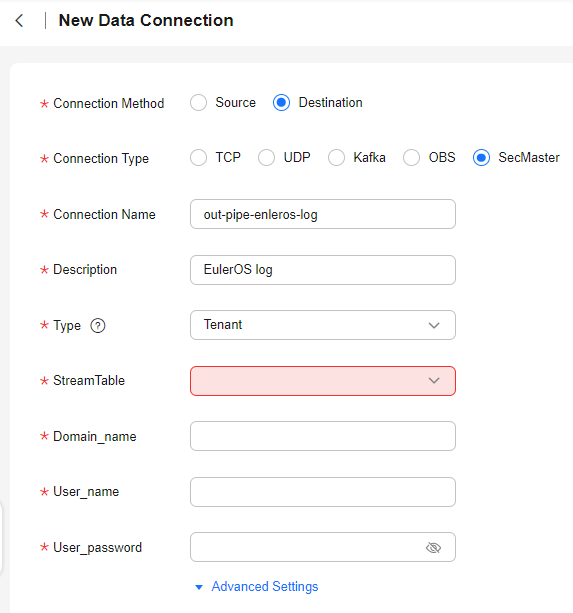

- Configure the data connection destination details. Figure 7 Destination
Table 5 Log transfer destination Parameter
Description
Connection Method
Select Destination.
Connection Type
Select SecMaster.
Connection Name
Enter a custom name for the data connection destination. In this example, enter "out-pipe-euleros-log".
Description
Enter a custom description of the data connection destination. In this example, "EulerOS logs" are used.
Type
User-defined log destination type. Select Tenant.
Pipe
Select the pipeline created in 8. In this example, select euleros_log.
Domain_name
Enter the domain account information of the IAM user used to log in to the console.
User_name
Enter the information of the IAM user used to log in to the console.
User_password
Enter the password of the current login IAM user.
Advanced Settings

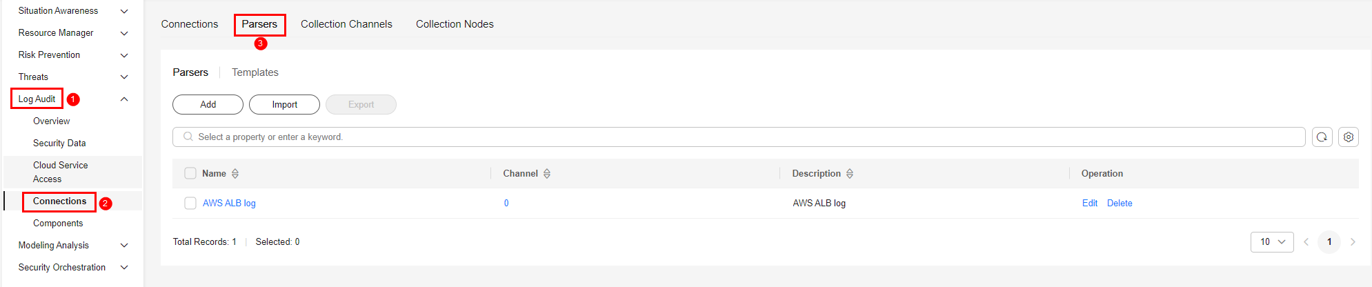

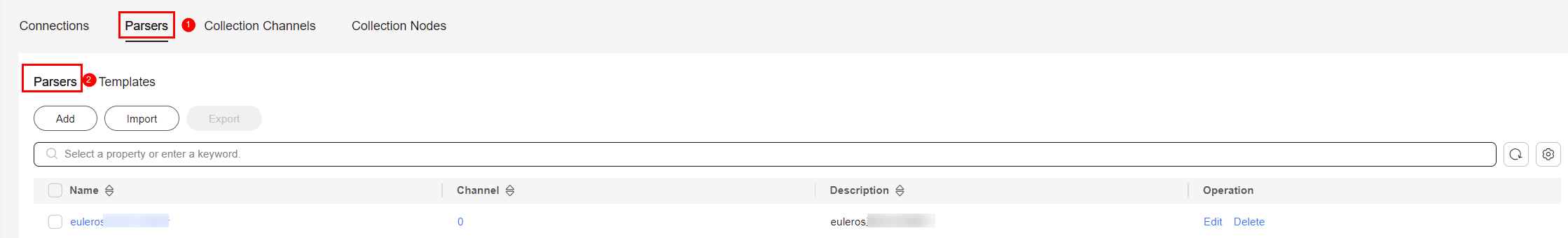

- Add a parser created from the parser template euleros system log parsing.
- Go to the target workspace. In the navigation pane on the left, choose . On the displayed page, click the Parsers tab.
Figure 8 Accessing the Parsers tab
- On the Parsers tab, click the Templates tab. In the Operation column of the parser template named Analysis of euleros system log, click Create by Template. The Create Parser page is displayed.
- On the Create Parser page, configure parser parameters.
- Name: Retain the default value Analysis of euleros system log.
- Description: Retain the default value. The default value is Analysis of euleros system log.
- Parsing rule: Retain the default value.
- Click OK. Return to the page to check the created parser.
Figure 9 Checking the created parser

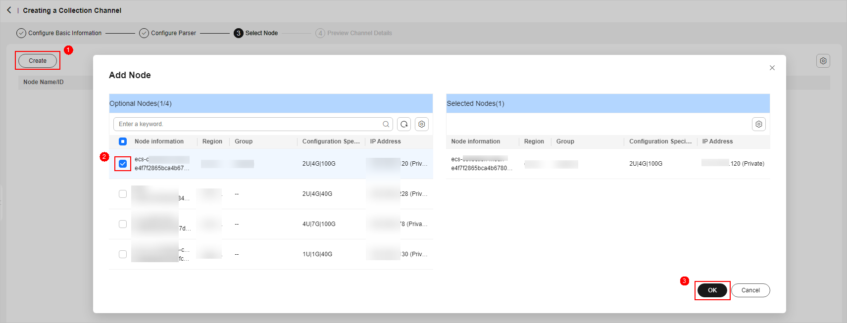

- On the Select Node page, click Create. In the displayed dialog box, select the ECS node managed in 6 and click OK. Figure 11 Selecting a node
- Click Next in the lower right corner of the page.

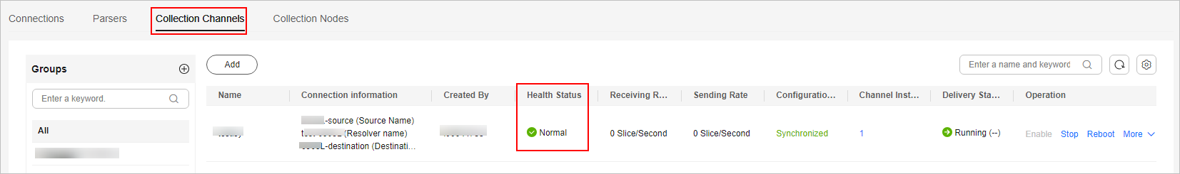

- On the Preview Channel Details page, confirm the configuration and click Save and Execute.
- On the Collection Channels tab, if the health status of a collection channel is Normal, the collection channel is successfully delivered. Figure 12 Collection channels configured

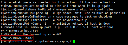

- On the tenant side, configure ECS log forwarding. The Rsyslog service is used to forward logs to SecMaster.
- Remotely log in to your ECS for log collection.
- Select the target log type, run the data access command, monitor all ECS logs through Rsyslog, and specify the IP address and port of the SecMaster collection node to which logs are sent.

- Example 1: If all logs need to be integrated, run the following command:
echo "*.*@IP-address-of-the-SecMaster-collection-node:Port" >> /etc/rsyslog.conf systemctl restart rsyslog
IP-address-of-the-SecMaster-collection-node is the IP address of the ECS node added in 6, and Port is the port set in 9.b.ii.
Example:
echo "*.*@192.168.0.0:5157" >> /etc/rsyslog.conf systemctl restart rsyslog
Figure 13 Example 1
- Example 2: If you want to access auth logs, run the following command:
echo "auth.*@IP-address-of-the-SecMaster-collection-node:Port" >> /etc/rsyslog.conf systemctl restart rsyslog
Example:
echo "auth.*@192.168.0.0:5157" >> /etc/rsyslog.conf systemctl restart rsyslog
