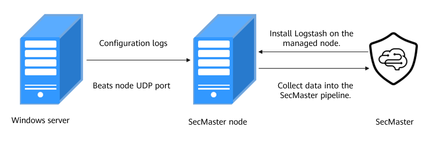

This section describes how to integrate Windows configuration logs into SecMaster.
Windows OSs cannot directly forward logs. SecMaster uses Filebeat, a lightweight log collector, to send Windows configuration logs to the node over corresponding UDP port. Then, SecMaster parses the logs using system log parsers to analyze and send parsed data to SecMaster. After enabling log integration, you can query them on the page.

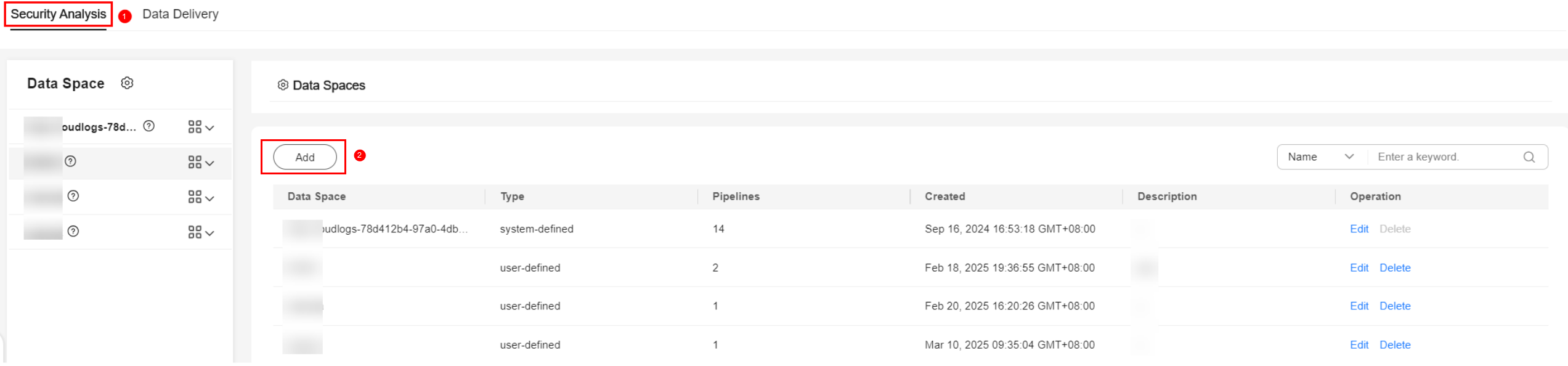

- Add a data space.
- In the upper left corner of the data space list, click Add. The Add Data Space panel is displayed on the right. Figure 3 Add Data Space
- On the Add Data Space panel, set the parameters for the new data space.

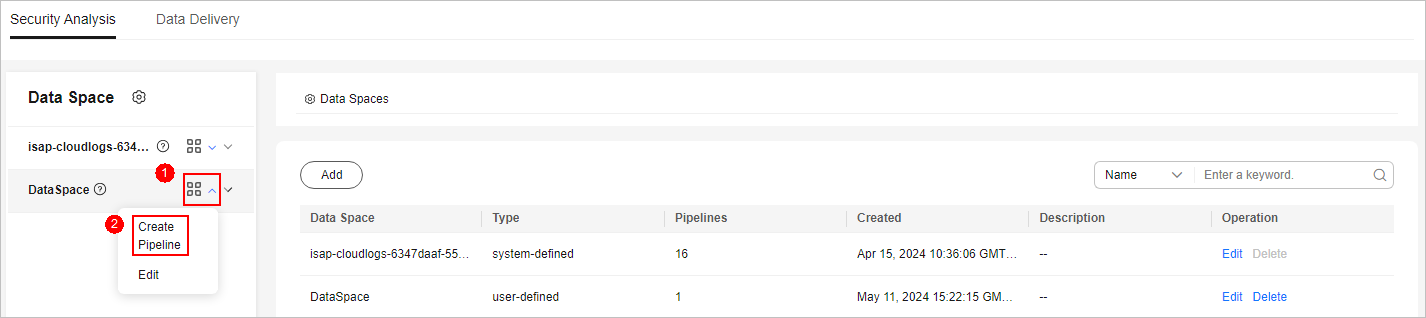

- In the data space navigation tree on the left, locate the data space added in 8.b, click
next to the data space name, and select Create Pipeline from the drop-down list. Figure 4 Creating a pipeline

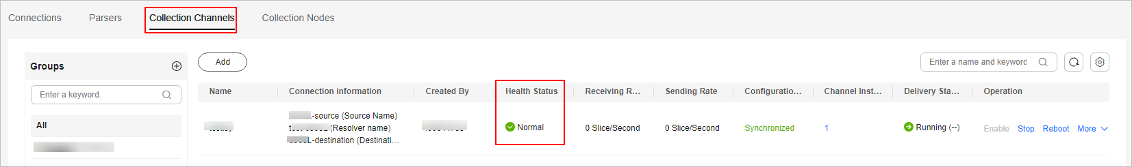

- On the Collection Channels tab, if the health status of a collection channel is Normal, the collection channel is successfully delivered. Figure 8 Collection channels configured

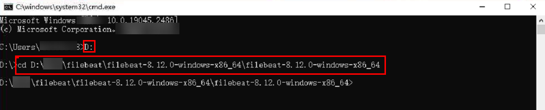

- Remotely log in to the target ECS.
- Download the installation package based on your Windows image version.
- Download the Filebeat service from the Filebeat website.
- Decompress the downloaded package and run the install-service-filebeat script.

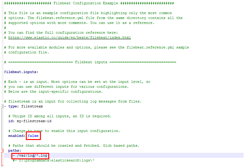

- Modify the filebeat.yml file.
- Log collection configurations:
- type: log #Note that the default value is false. You need to change the value to true. enabled: true paths: #The following file path is the location of logs to be collected. You can use wildcard characters. - D:/tmp/filebeat-input/*.log
Figure 9 Modifying the configuration file

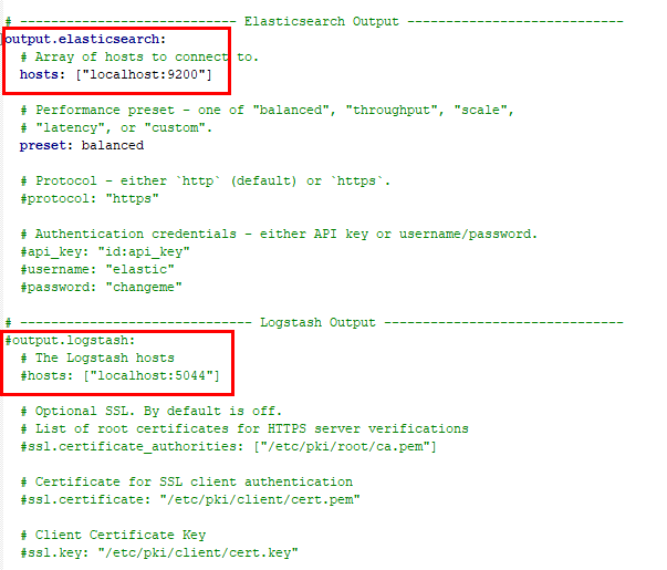

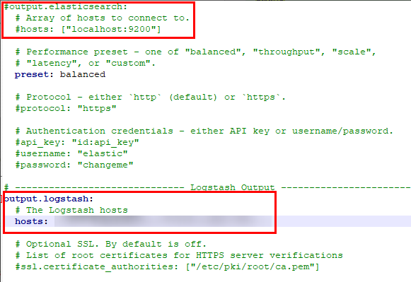

- Log forwarding configurations:
The SecMaster collection node uses the Logstash service to collect logs. You need to modify the following configurations:
- Delete the comment tag (#) from the following two lines of parameters.
#output.logstash: #hosts: ["localhost:5044"]
- Change localhost to the IP address of the VM for log collection management. To check the IP address of the data collection ECS node, go to the target workspace, choose in the navigation pane, and click the Nodes tab. On the displayed tab, locate the ECS node and check its IP address.
- Port 5157 is used as an example. If different types of logs need to be collected to SecMaster at the same time, use different ports for different types of logs. The port number ranges from 1025 to 65535. Figure 10 Before the change
After the modification
Figure 11 After the change

- Enter cmd in the search box of the Windows operating system to open the command prompt.
- Enter the following command to go to the drive where the Filebeat installation directory is located. The following uses drive D as an example.
D:
- Enter the following command to go to the Filebeat installation directory.
cd Filebeat-installation-directory
Figure 12 Go to the Filebeat installation directory.
- Enter the following command and press Enter.
(Frontend).\filebeat -e -c filebeat.yml
