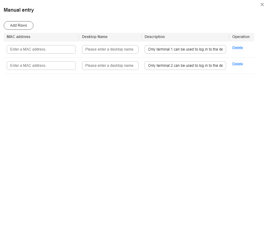

- Click Add Manually.
- On the displayed page, enter the MAC address, desktop name, and description, as shown in Figure 1.
- The MAC address format is xx-xx-xx-xx-xx-xx.
- One MAC address can be bound to multiple desktops.
- A desktop can be bound to multiple MAC addresses.
- Information cannot be entered if there are more than 100,000 binding relationships.
- If multiple terminals need to be bound, click Add Rows to add binding information.
- Click OK.
