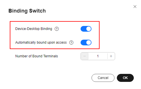

- Enable terminal-desktop binding:
- Click Binding Settings.
 - On the displayed dialog box, toggle on the switch of Device-Desktop Binding.
 - Determine whether to toggle on the switch of Automatically bound upon access and set Number of Bound Terminals (value range: 1–10).
         - Automatically bound upon access can be enabled only after Device-Desktop Binding is enabled.
 - After Automatically bound upon access is enabled, the MAC address is automatically bound when the cloud desktop is accessed from a terminal.
 - Click OK, as shown in Figure 1.
