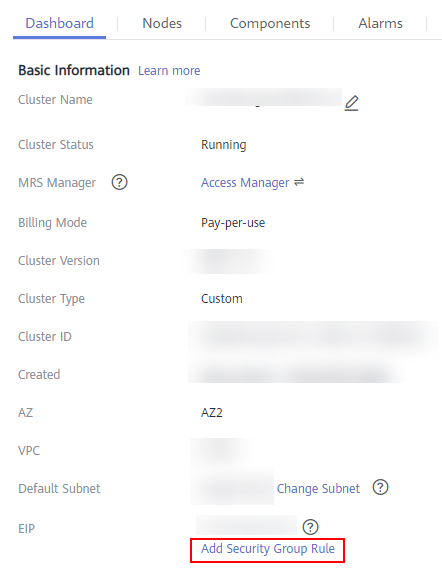

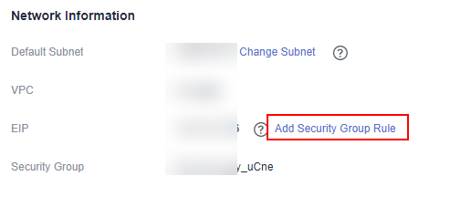

- (Optional) To grant users in other network segments the permission to access MRS Manager, you can modify the security group and add the IP address range of the users.
- On the cluster details page, click Add Security Group Rule next to EIP.
- In the displayed Add Security Group Rule dialog box, add the IP address segment required for authorized users to access the public network, and select the check box. Figure 2 Adding a security group rule
By default, the IP address segment used for accessing the public network is filled. You can change the IP address segment as required. To view, modify, or delete security group rules, click Manage Security Group Rule.
- Click OK.
