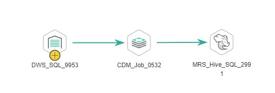

- Drag a desired node to the canvas, move the mouse over the node, and select the
icon and drag it to connect to another node.
It is recommended that each job contain a maximum of 200 nodes.
Figure 1 Compiling a job

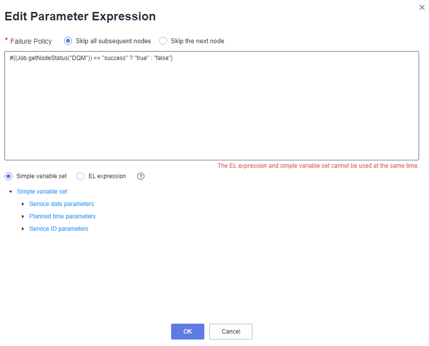

- (Optional) Configure line functions. Right-click the line connecting two nodes on the canvas. Delete and Set Condition are displayed. You can select them as needed.
- Delete: Deletes the line connecting the nodes.
- Set Condition: In the displayed dialog box, you can enter a ternary expression using the EL expression syntax. If the result of the ternary expression is true, subsequent nodes will be connected. Otherwise, subsequent nodes will be skipped.
The following figure shows a typical ternary expression. If the execution result of the DQM node is true, subsequent nodes will be connected. If the execution result is false and the Failure Policy is Skip all subsequent nodes, the next node A and all nodes following node A will be skipped.
#{(Job.getNodeStatus("DQM")) == "success" ? "true" : "false"}Figure 2 Set Condition
For details about the EL expression syntax, see Expression Overview. For details about how to use IF conditions, see IF Condition Judgment.
