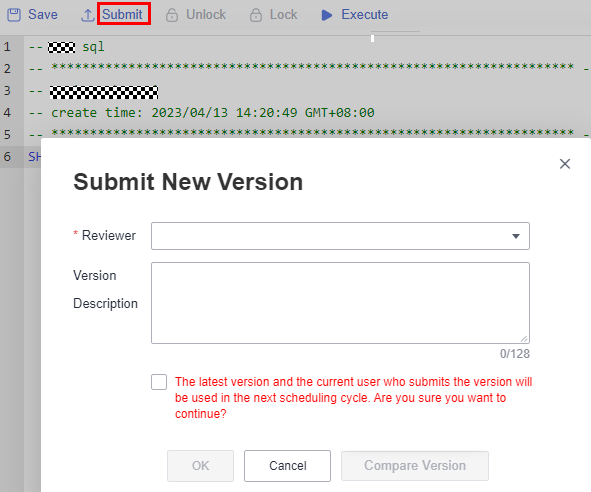

- Above the script editor, click Submit to submit a version. In the displayed dialog box, select the reviewer, enter the change description (a maximum of 128 characters allowed), and select the check box below. If you do not select this option, you cannot click OK. When submitting a version, you can click Compare Version to view the differences between the current version and the last version. Figure 1 Submitting a version
- If review is enabled on the Review Center page, your submitted version will be reviewed by the reviewer on the Pending Review tab page on the Review Center page. The version is submitted successfully only after it is approved by the reviewer. For details, see Approval Settings. If review is disabled, the version can be directly submitted.
To revoke a submitted request, go to the Review Center page and click the My Applications tab. Then you can submit an application again.

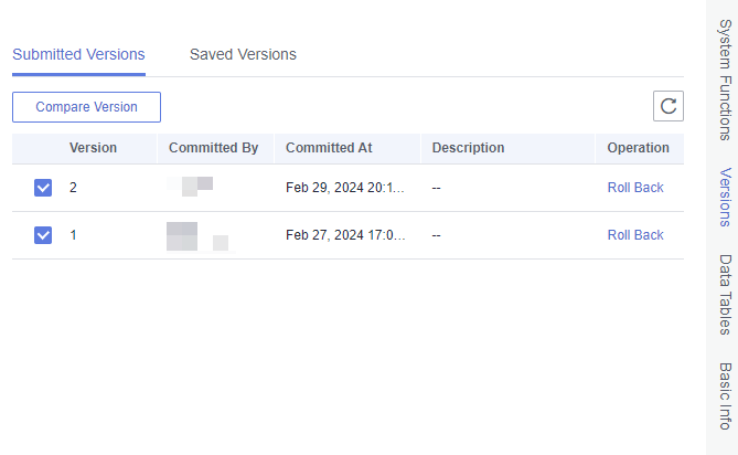

- On the right of the page, click the Versions tab and view the version submission records. Select the version to be rolled back and click Roll Back. If the content in the development state is not submitted, the content will be overwritten after the rollback. In this case, you must submit the rollback version again to make it take effect. By default, the latest submitted version is used for scheduling.Figure 2 Rolling back a version

- On the right of the page, click the Versions tab and view the version submission records. Select the versions to be compared and click Compare Version. Figure 3 Comparing versions

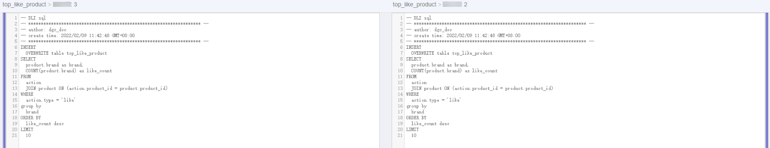

- A new page is displayed, showing the script content of different versions on the left and right separately. The differences between the two versions have been marked. You can use the
and
buttons in the upper right corner to go to the previous or next change. Figure 4 Version comparison details
