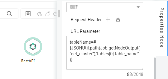

In the URL parameter of the Rest Client node, use expression tableName=#{JSONUtil.path(Job.getNodeOutput("get_cluster"),"tables[0].table_name")}, as shown in Figure 1.
Expression description:
- Job.getNodeOutput("get_cluster") is used to obtain the execution result of the get_cluster node in the job. The execution result is a JSON character string.
- tables[0].table_name is used to obtain the value of a field in the JSON character string.

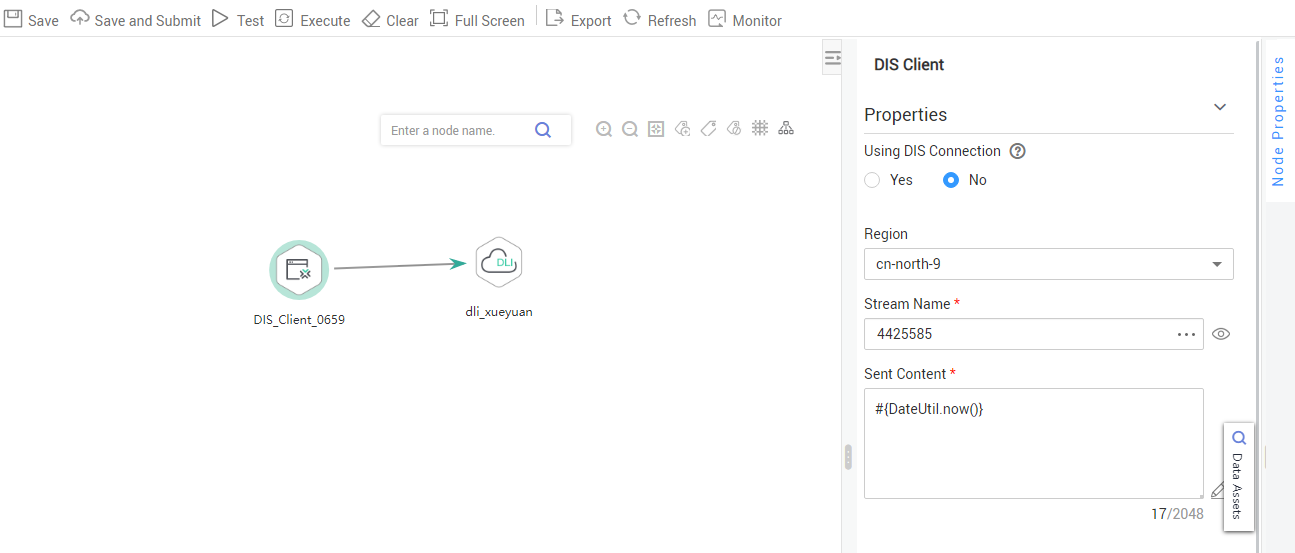

This section uses the #{DateUtil.now()} expression as an example.

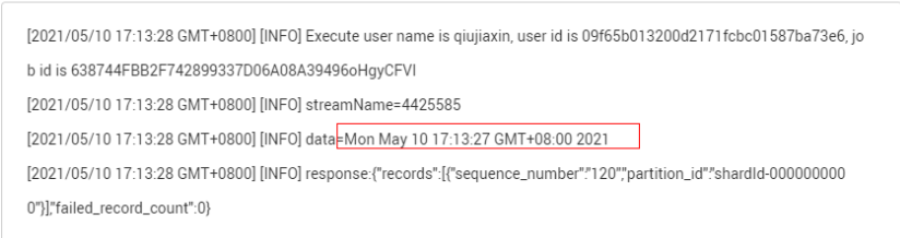

- Use the Kafka Client node.
- Prerequisites: An MRS cluster with the Kafka component is available.
- Method: Select the Kafka Client node, write the EL expression in the data to be sent, and click Test. Then right-click the node to view the log. The value of the EL expression is printed in the log.

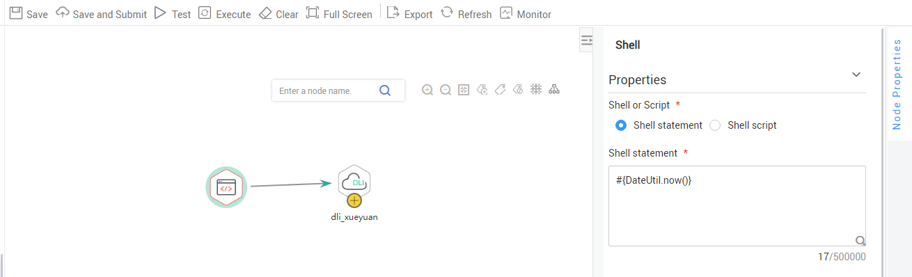

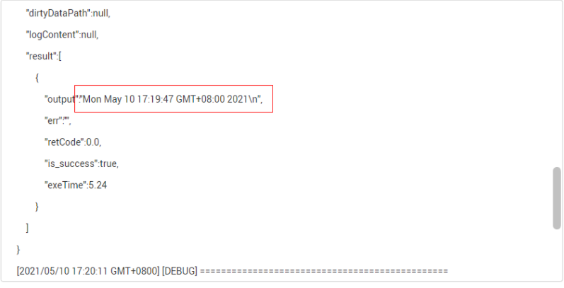

- Use the shell node.
- Prerequisites: An ECS is available.
- Method: Create a host connection, print the EL expression using echo, and click Test. Then view the log. The value of the EL expression is printed in the log.

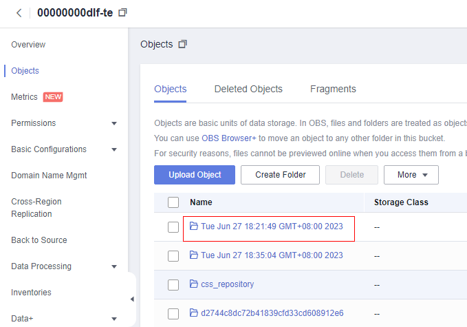

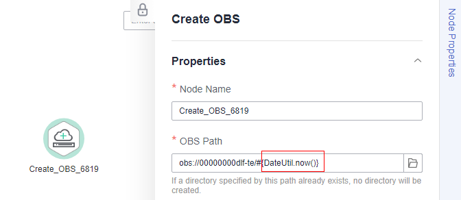

- Use the Create OBS node.
If the preceding methods are unavailable, use the Create OBS node and create an OBS path with the value of the EL expression as its name. You can click Test and go to the OBS console to view the name of the created path.
