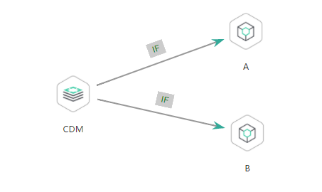

- On the Develop Job page, create a job, drag a CDM node and two Dummy nodes and drop them on the canvas in the right pane. Click and hold
to connect the CDM node to the Dummy nodes, as shown in Figure 1.

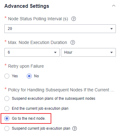

Set the Failure Policy for the CDM node to Go to the next node.

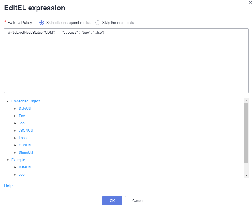

Figure 2 Configuring the failure policy for the CDM node - Right-click the connection line and select Set Condition. In the Edit EL Expression dialog box, enter the IF statement in the text box.
Each statement branch requires an IF statement. The IF statement is a ternary expression based on the EL expression syntax. If the result of the ternary expression is true, subsequent nodes will be connected. Otherwise, subsequent nodes will be skipped.
In this demo, the #{Job.getNodeStatus("node_name")} EL expression is used to obtain the execution status of a specified node. If the execution is successful, success is returned; otherwise, fail is returned. In this example, the IF statement expressions are as follows:
- The IF statement expression for branch A is #{(Job.getNodeStatus("CDM")) == "success" ?. "true" : "false"}
- The IF statement expression for branch B is #{(Job.getNodeStatus("CDM")) == "fail" ?. "true" : "false"}
After entering the IF statement expression, you can select either Skip all subsequent nodes or Skip the next node for Failure Policy. After the configuration is complete, click OK to save the job.Figure 3 Configuring a failure policy - Click Test to test the job and view the execution result on the Monitor Instance page.

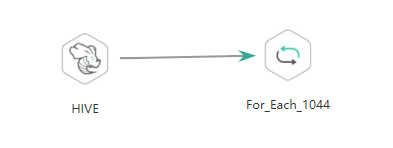

Figure 5 shows the job orchestration.

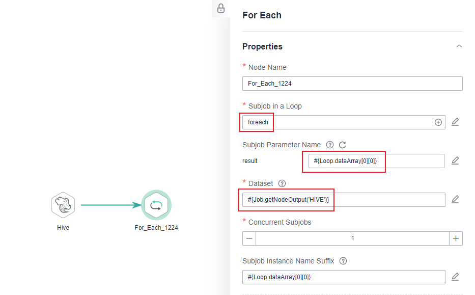

Key configurations of the For Each node are as follows:
- Dataset: Enter the execution result of the select statement on the Hive SQL node. Use the #{Job.getNodeOutput('HIVE')} expression, where HIVE is the name of the previous node.
- Subjob Parameter Name: Enter the parameter defined in the subjob. Transfer the output of the previous node of the main job to the sub-job for use. The variable name is result, and its value is a column in the dataset. The EL expression #{Loop.dataArray[0][0]} or #{Loop.current[]} is used. This example uses {Loop.dataArray[0][0]} as an example.

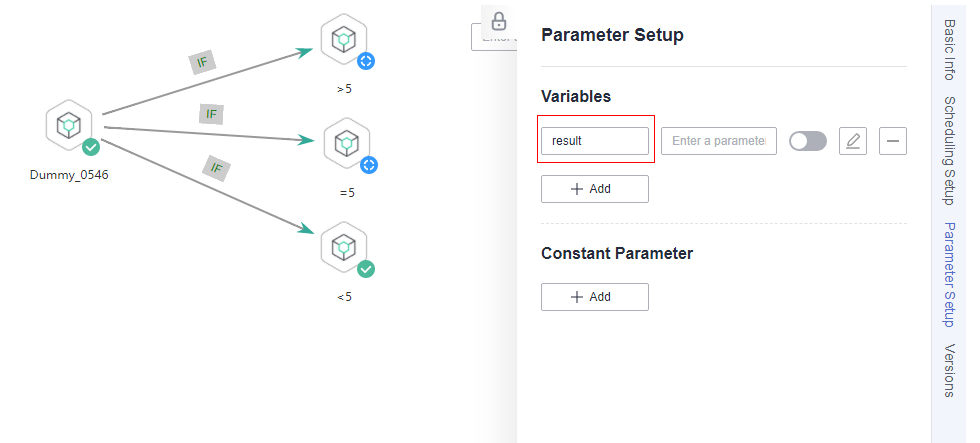

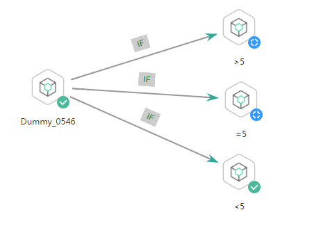

- On the Develop Job page, create a data development subjob For Each. Drag four Dummy nodes and drop them on the canvas, click and hold
to connect them, as shown in Figure 6.

- For the >5 branch, the IF statement expression is #{${result} > 5 ? "true" : "false"}.
- For the =5 branch, the IF statement expression is #{${result} == 5 ? "true" : "false"}.
- For the <5 branch, the IF statement expression is #{${result} < 5 ? "true" : "false"}.

- Configure job parameters. Set the parameter name to result. This parameter is only used by the For Each node in the main job testif to identify subjob parameters. You do not need to set the parameter value.
Figure 7 Configuring job parameters

- On the Develop Job page, create a data development job named testif. Drag a HIVE SQL node and a For Each node and drop them on the canvas. Click and hold
to connect the nodes, as shown in Figure 5.

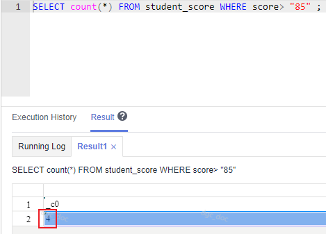

- Configure properties for the HIVE SQL node. Reference the following SQL script (there is no special requirement for other properties):
--Obtain the number of people whose scores are higher than 85 from the student_score table. SELECT count(*) FROM student_score WHERE score> "85" ;
Figure 8 HIVE SQL script execution result - Configure properties for the For Each node.
- Subjob in a Loop: Select foreach, the subjob that has been developed.
- Subjob Parameter Name: Enter the parameter defined in the subjob. Transfer the output of the previous node of the main job to the sub-job for use. The variable name is result (parameter name of the subjob), and its value is a column in the dataset. The EL expression #{Loop.dataArray[0][0]} is used.
Figure 9 Properties of the For Each node - Save the job.

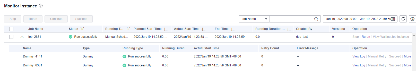

Testing the Main Job
- Click Test above the canvas to test the main job. After the main job is executed, the subjob is automatically invoked through the For Each node and executed.
- In the navigation pane on the left, choose Monitor Instance to view the job execution result.
- After the job is executed, view the execution result of the subjob foreach on the Monitor Instance page. The execution result meets the expectation. Currently, the execution result of the Hive SQL statement is 4. Therefore, the >5 and =5 branches are skipped, and the <5 branch is successfully executed.
Figure 10 Execution result of the subjob

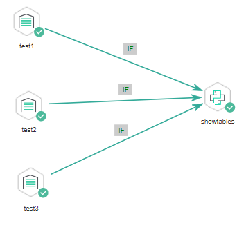

Develop a job.
- On the Develop Job page, create a data development job.

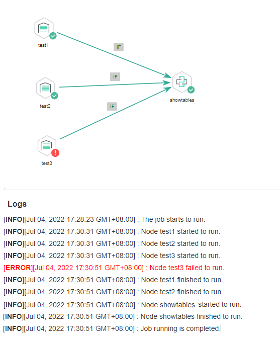

- Drag three DWS SQL operators as parent nodes and one Python operator as a child node to the canvas. Click and hold
to connect the nodes to orchestrate the job shown in Figure 11.
- The IF statement expression for the test1 node is #{(Job.getNodeStatus("test1")) == "success" ? "true" : "false"},
- The IF statement expression for the test2 node is #{(Job.getNodeStatus("test2")) == "success" ? "true" : "false"},
- The IF statement expression for the test3 node is #{(Job.getNodeStatus("test3")) == "success" ? "true" : "false"},
The expression of each node is determined using the IF statement based on the execution status of the previous node.

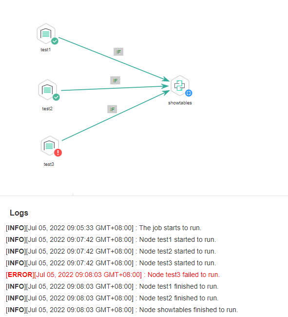

Test the job.
- Click Save above the canvas to save the job.
- Click Test above the canvas to test the job.
If test1 is executed successfully, the corresponding IF statement is true.
If test2 is executed successfully, the corresponding IF statement is true.
If test3 fails to be executed, the corresponding IF statement is false.
If Multi-IF Policy is set to OR, the showtables node is executed and the job execution is complete.
Figure 12 How the job runs if Multi-IF Policy is ORIf Multi-IF Policy is set to AND, the showtables node is skipped and the job execution is complete.
