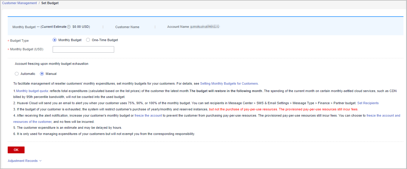

- Locate the target customer and click Set Budget in the Operation column. The Set Budget page is displayed. You can search for customers by whether the account is automatically frozen, association type, association time, customer name, customer account, customer ID, account manager name, month-to-date expenditure, resource expiration date, mobile number, budget usage, or customer tag.
You can select multiple customers and click Set Budget above the customer list to achieve batch budget setting. This method will overwrite the original budget of the customer.

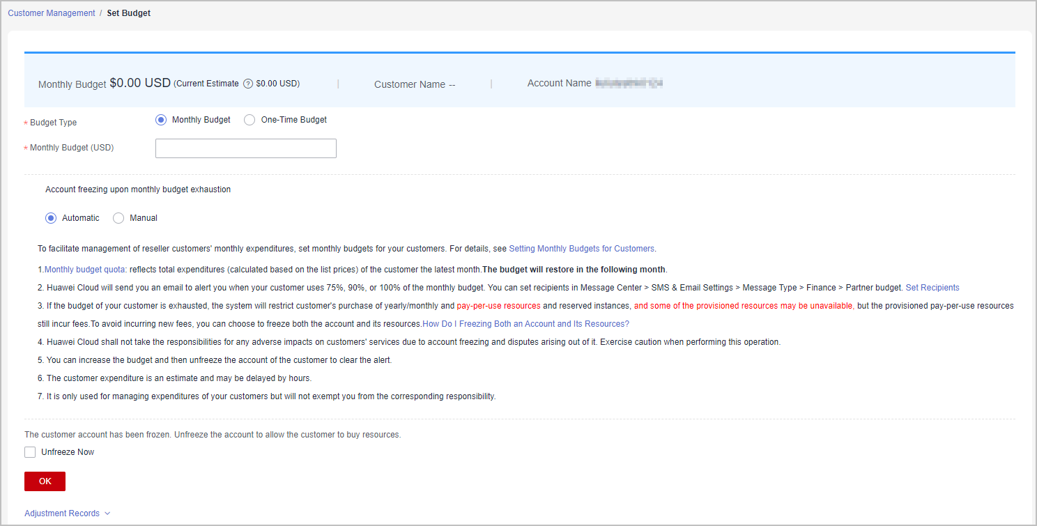

- Set the Budget Type to Monthly Budget, enter the monthly budget value, and select whether to automatically freeze the account upon budget exhaustion.
- If a customer account is frozen, the customer cannot purchase resources. If you want to unfreeze the account, select Unfreeze Now and click OK.
- After a customer is associated with a partner in the resale model, the customer account is frozen by default. When the account is frozen, the customer cannot buy, renew, or change resources. Some of the provisioned resources may be unavailable, but they still incur fees. The partner can select Unfreeze Now when setting a monthly budget for this customer.

- The budget type can be changed. The new budget type will take effect immediately. After you have changed the budget type from one-time budget to monthly budget for a customer, pay attention to the current estimate (the data is an estimate and may be delayed by about 10 minutes). In this case, the current estimate is equal to the month-to-date expenditure. When you change the budget type from monthly budget to one-time budget for a customer, the accumulated expenditure is calculated only from the month when the budget type is changed.
- A message is displayed indicating that the monthly budget has been set successfully.
- Setting a budget is a sensitive operation. You are advised to enable the verification code function to enhance account security. For details about how to enable verification code function, see Managing Basic Information.
- Automatic account freezing is a high-risk operation. If you select the automatic account freezing policy after the budget is exhausted, you must enter the verification code even if the verification code function is disabled.
- Click OK.
