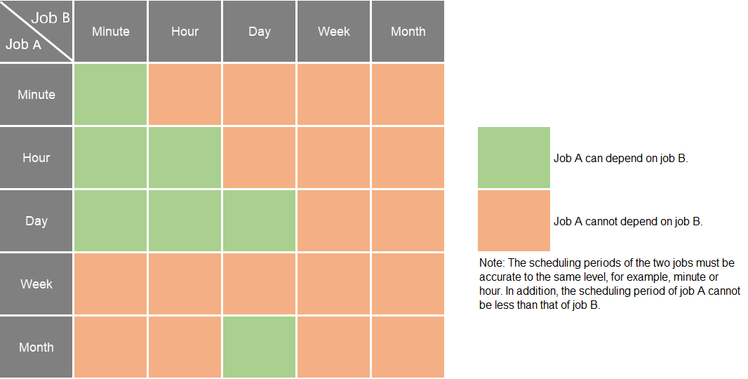

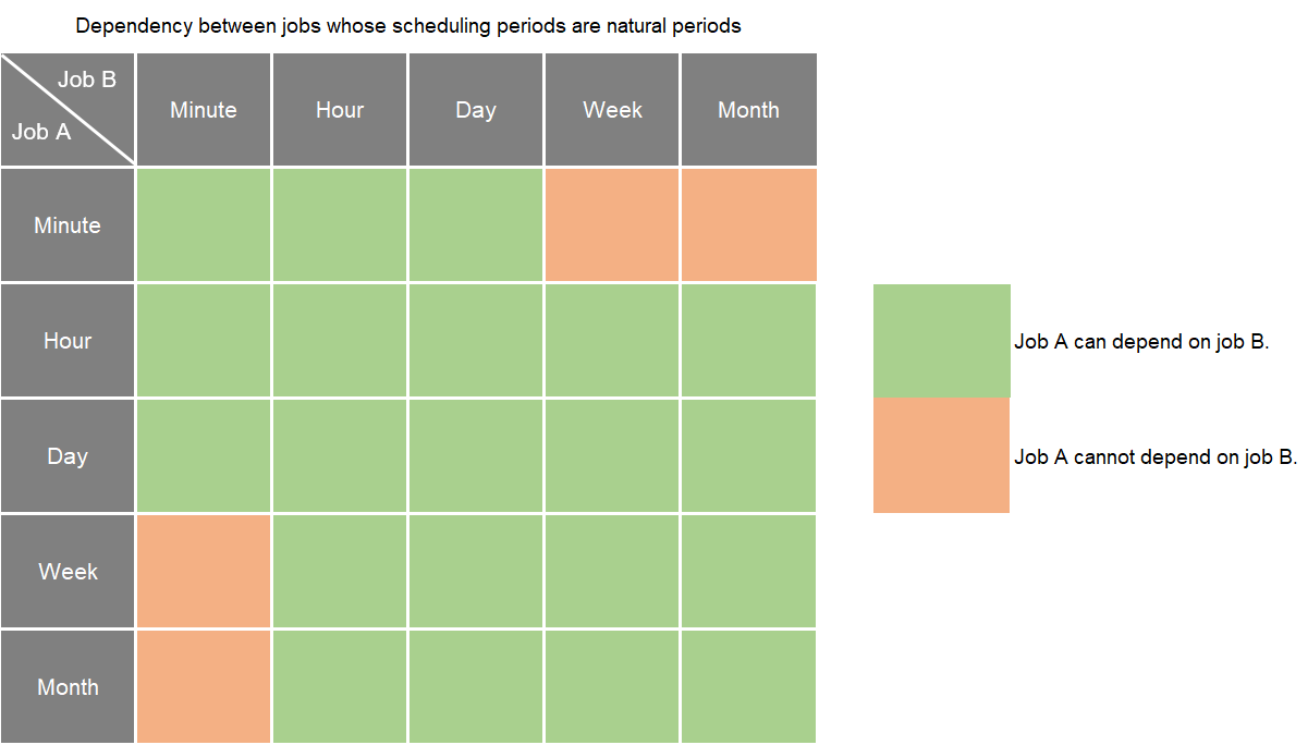

| Dependency job | You can select jobs that are executed periodically in different workspaces as dependency jobs. The current job starts only after the dependency jobs are executed. You can click Parse Dependency to automatically identify job dependencies. NOTE: For details about job dependency rules across workspaces, see Job Dependency Rule. Currently, DataArts Factory supports two types of job dependency policies, that is, dependency between jobs whose scheduling periods are traditional periods and dependency between jobs whose scheduling periods are natural periods. You can select either of them. The scheduling periods for new DataArts Studio instances are natural periods. Figure 1 Dependency between jobs whose scheduling periods are traditional periods Figure 2 Dependency between jobs whose scheduling periods are natural periods For details about the conditions for setting dependency jobs and how jobs run after dependency jobs are set, see Dependency Policies for Periodic Scheduling. |
| Policy for Current job If Dependency job Fails | Policy for processing the current job when one or more instances of its dependency job fail to be executed in its period.
For example, the recurrence of the current job is 1 hour and that of its dependency jobs is 5 minutes.
| Run After Dependency job Ends | If a job depends on other jobs, the job is executed only after its dependency job instances are executed within a specified time range. If the dependency job instances are not successfully executed, the current job is in waiting state. If you select this option, the system checks whether all job instances in the previous cycle have been executed before executing the current job. |
| Dependency Job | When configuring job dependencies, you can filter dependent jobs based on whether they are being scheduled. This prevents downstream job failures caused by upstream dependent jobs not being scheduled.
| Dependency Cycle |
| Cross-Cycle Dependency | Dependency between job instances
