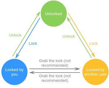

  • You can view the lock status of a script or job in the script or job directory tree.

    • Soft lock: You can lock or unlock jobs or scripts, regardless of whether they are locked by others.
    • Hard Lock: You can lock jobs or scripts only after they have been unlocked by other users. The space administrator and the DAYU Administrator user can lock and unlock jobs or scripts without any limitations.
  • Do not lock a script or job that is locked by another user because if you do so, changes to the script or job made by the user will be lost. If you want to modify the script or job, contact the user to unlock the script or job, and lock it by yourself.
Figure 1 Lock statuses
