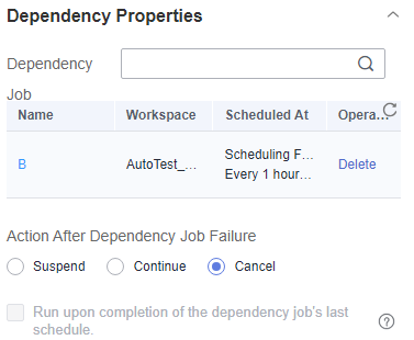

You can set a job that meets the scheduling period conditions as the dependency jobs for a job that is scheduled periodically. For details about how to set a dependency job, see Setting Up Scheduling for a Job Using the Batch Processing Mode.
- The specified period is calculated as follows (see How a Job Runs After a Dependency Job Is Set for It for details):
- Same-period dependency: If the scheduling periods of the two jobs are accurate to the same level (for example, minute, hour, or day), the specified period is (Execution time of job A – Recurrence of job A, Execution time of job A].
- Cross-period dependency: If the scheduling periods of the two jobs are accurate to different levels, the specified period is [Natural start time of the previous recurrence of job A, Natural start time of the current recurrence of job A).
- Parameter Policy for Current job If Dependency job Fails determines whether job A will check the status of job B's instances.
- If this parameter is set to Suspend or Terminate, job A will be suspended or terminated if instances of job B fail during a specified time period.
- If this parameter is set to Continue, job A will be executed only if all the instances of job B are executed (regardless of whether the execution is successful or not).
