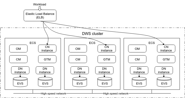

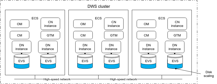

A Closer Look at DWS Cluster Topology
To fully understand the scalability of DWS, one needs to understand DWS's typical cluster topology. The following figure shows a simplified ECS+EVS deployment structure of DWS.
  • ECSs provide compute resources, including CPUs and memory. DWS database instances (such as CNs and DNs) are deployed on ECSs.
  • EVS provides storage resources. An EVS disk is attached to each DN.
  • All ECSs in a DWS cluster are within the same VPC to ensure high-speed connections between them.
  • All the database instances deployed on ECSs form a distributed, massively parallel processing database (MPPDB) cluster to provide data analysis and processing capabilities as a whole.
Figure 1 Cluster topology
Once you have learned the topology of a DWS cluster, you can better understand the scalability of DWS. At present, DWS offers the following scaling options: disk scaling, node flavor change, cluster scale-out, cluster scale-in, and CN addition or deletion.

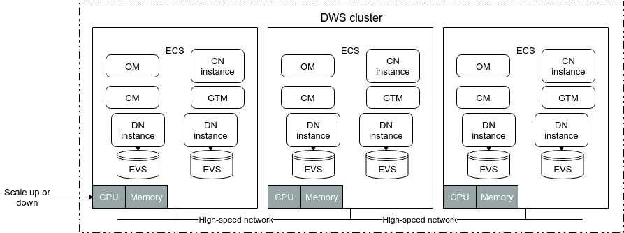

Changing the Node Flavor
  • This operation changes the flavors of all nodes in a cluster. It can be used to quickly change CPU and memory resources.
  • A flavor is a preset resource template of a combination of a specific number of vCPUs and memory. For example, the flavor dwsx.16xlarge includes 64 vCPUs and 512 GB memory.
  • Changing the node flavor is a lightweight operation that typically can be completed within 5 to 10 minutes. It does not involve data migration, but services will need to be restarted once, causing a service interruption in minutes. You are advised to perform this operation during off-peak hours.
  • For DWS's coupled storage-compute architecture, EVS specifications support specification scaling. The cluster version must be 8.1.1.300 or later.
  • For details, see Changing the Node Flavor.
Figure 3 Changing the node flavor

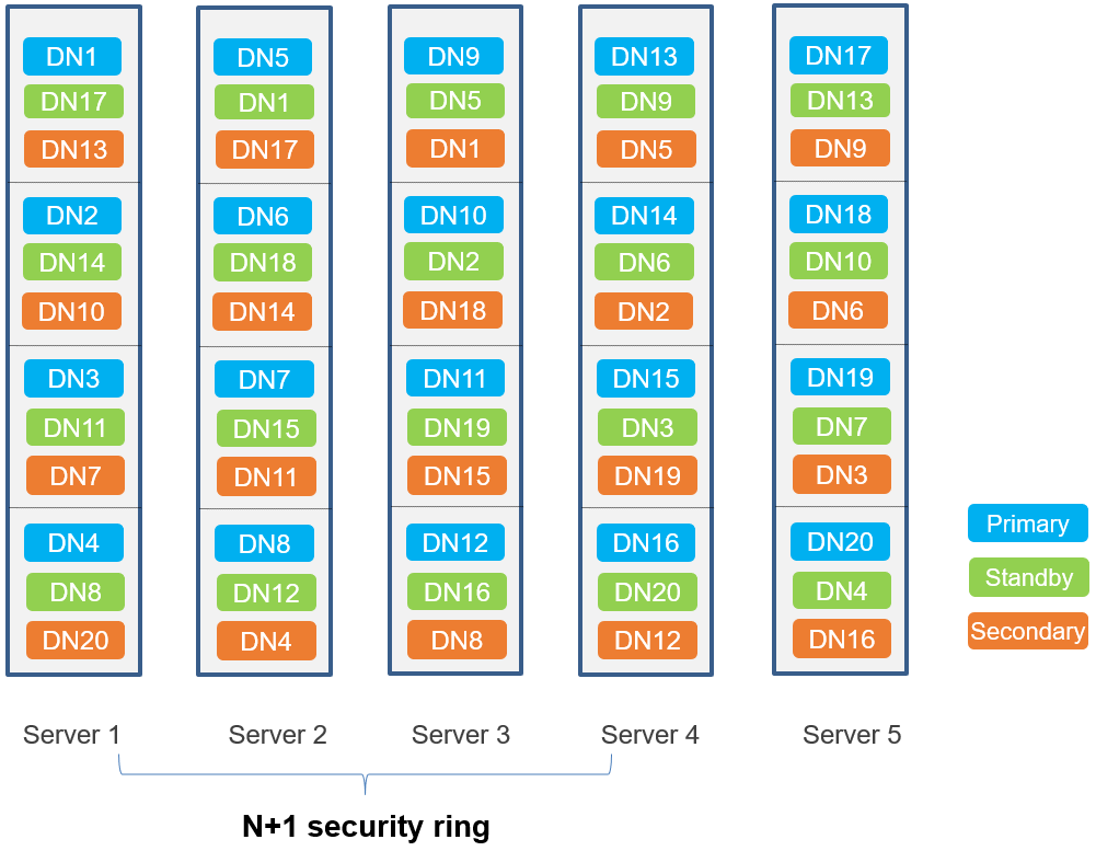

DWS Cluster Security Ring
A security ring is the minimum set of nodes required for the horizontal deployment of multi-replica DNs. Cluster scale-out and scale-in are both performed by security ring. The main idea behind security rings is fault isolation. Any fault that occurs within a security ring stays within that ring.
DWS uses a primary-standby-secondary architecture, so the minimum number of nodes in a security ring is 3. When a fault occurs within a ring, it has no impact on nodes outside that ring. The scope of impact is minimized (3 nodes), and the impact on each node in that faulty ring is 1/(N-1), that is, 1/2. In extreme scenarios, the entire cluster is a security ring. If a fault occurs within this ring, the scope of impact is the largest (the entire cluster), but the impact on each node in the ring is the smallest, that is, 1/(N-1).
A common practice is to form an N+1 ring, where each node evenly distributes its N replicas to the remaining N nodes in the same ring. When a fault occurs in the ring, the scope of impact in the entire cluster is N+1 nodes, and the impact on each node in the ring is 1/N.
Figure 5 Typical N+1 security ring

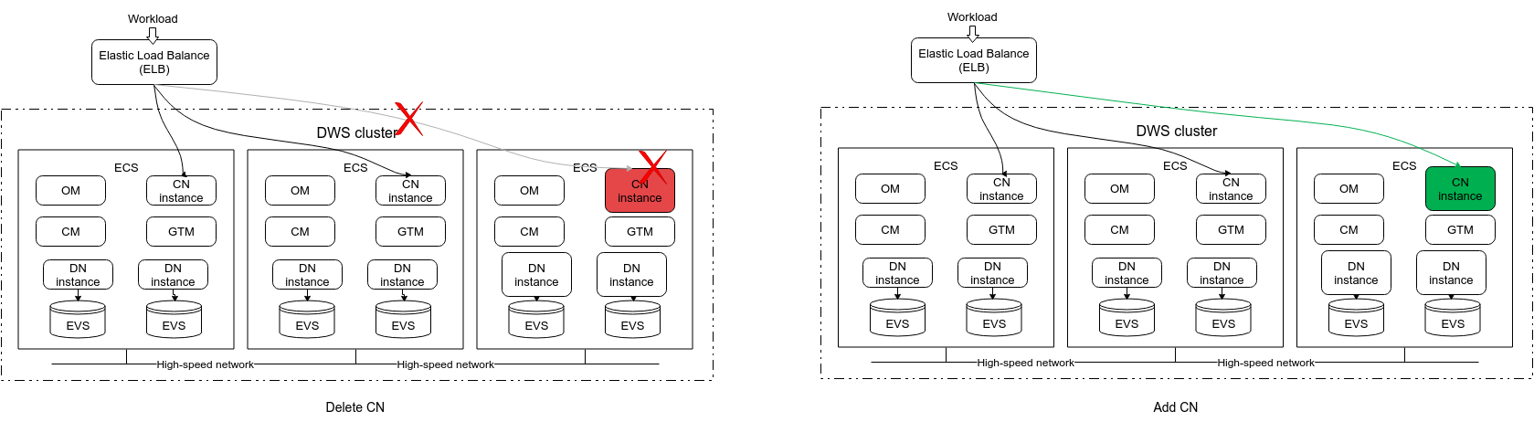

Adding or Deleting CNs
  • Adding or deleting coordinator nodes (CNs) is another way of cluster scaling in DWS.
  • CNs are an important component of DWS. They provide interfaces to external applications, optimize global execution plans, distribute execution plans to data nodes (DNs), and summarize results from each node into a single result set.
  • CN capacities determine the entire cluster's concurrency handling capability. By adding more CNs, you increase the cluster's concurrency handling capability.
  • CNs use a multi-active architecture. To ensure data consistency, if data on some CNs is damaged, DDL services will be blocked. To quickly restore DDL services, you can remove the faulty CNs.
  • DWS supports adding or deleting CNs in 8.1.1 and later versions.
  • When a CN is added, metadata needs to be synchronized. The time it takes to add a CN depends on the metadata size. In 8.1.3, CNs can be added and deleted online. During CN addition, DWS does not restart and can continue to provide services. DDL services will be blocked for a short period of time (with no error reported). No other services are affected.
Figure 7 Adding or deleting a CN

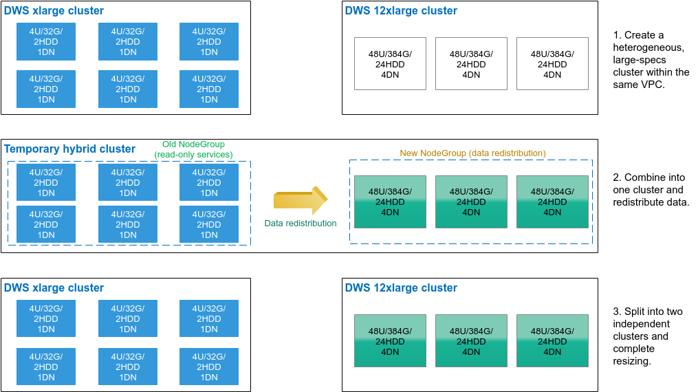

Cluster topology
Change both the cluster topology and node flavor (the number of DNs changes).
Resize the cluster.
Read-only services
Data migration is needed. The duration is positively correlated with the sizes of metadata as well as service data.
Change both the cluster topology and node flavor (the number of DNs remains the same).
Migration data for cluster disaster recovery.
Online services can be maintained (partially impacted).
Data migration is needed. The duration is positively correlated with the size of service data.
