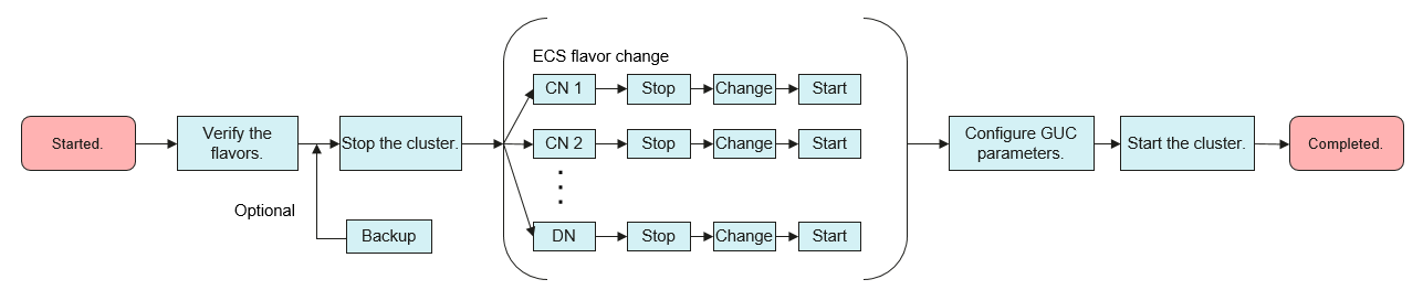

Node Flavor Change Modes
DWS supports online and offline node flavor changes. For details, see Table 1.
| Node Flavor Change Mode | Description |
| Offline | During the change, the cluster will be stopped. Services will be unavailable for about 10 minutes. The offline mode is used by default. |
| Online | Changes are applied to nodes one at a time. Services may be interrupted briefly (3 to 5 times) during the change. In addition, the performance of decoupled storage and compute will deteriorate briefly. DDL services are unavailable during flavor changes of CNs. An online flavor change takes a longer time than an offline flavor change. Plan your time window carefully. If the online mode is not supported on the console, contact technical support. |

Procedure
- Log in to the DWS console.
- Choose Cluster > Cluster List. All clusters are displayed by default.
- In the row of a cluster, choose More > Change Specifications > Change node flavor in the Operation column. Click OK.
- On the Change node flavor page, select the target flavor and change mode.
Table 2 Flavor change parameters Parameter
Description
Select the target flavor.
- (Default) You can switch the flavor to another flavor of the same type. For details about the supported flavors, see Table 3.
- You can also select a flavor of a type different from the current flavor. If this operation is not supported, contact technical support.
Change Mode
You can select Online or Offline. For details, see Table 1.
Figure 2 Changing the flavor
- Confirm that the settings are correct, select I agree, and click Next: Confirm.
- Click Submit. In the displayed dialog box, click OK to submit the cluster flavor change task.
- Return to the cluster list. The cluster status will change to Changing node flavor. Wait for about 20 minutes.
