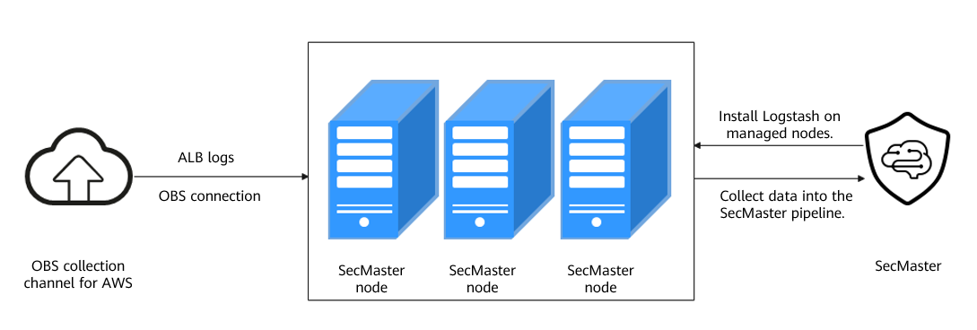

This section describes how to integrate Amazon Web Services (AWS) Application Load Balancer (ALB) logs into SecMaster.
SecMaster can integrate AWS object storage logs. It uses the AWS ALB log parser to parse logs and transfer them into the SecMaster pipeline. After enabling log integration, you can query them on the Log Audit > Security Data page.
Figure 1 Networking diagram for integrating AWS ALB logs into SecMaster

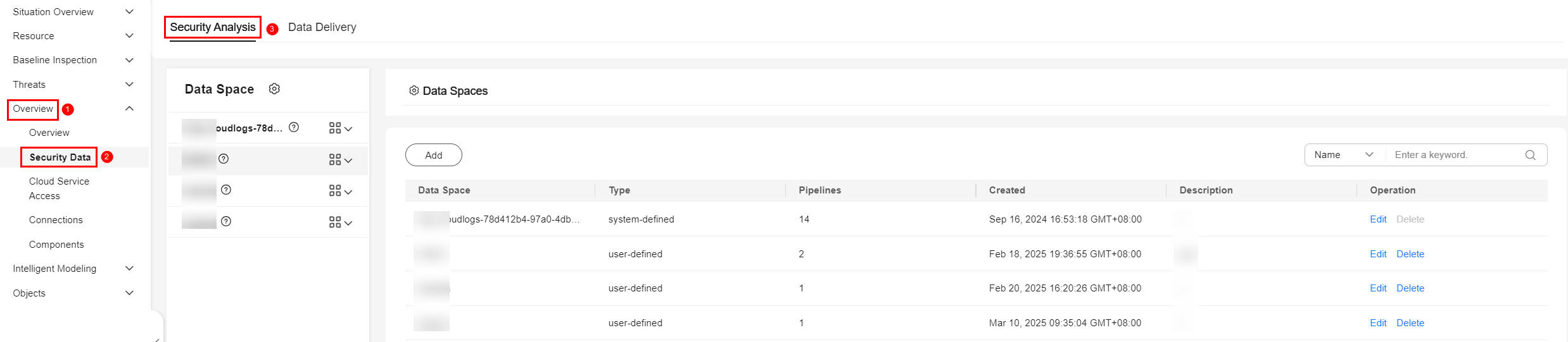

    1. Go to the target workspace management page. In the navigation pane on the left, choose Log Audit > Security Data.
      Figure 2 Accessing the Security Analysis tab

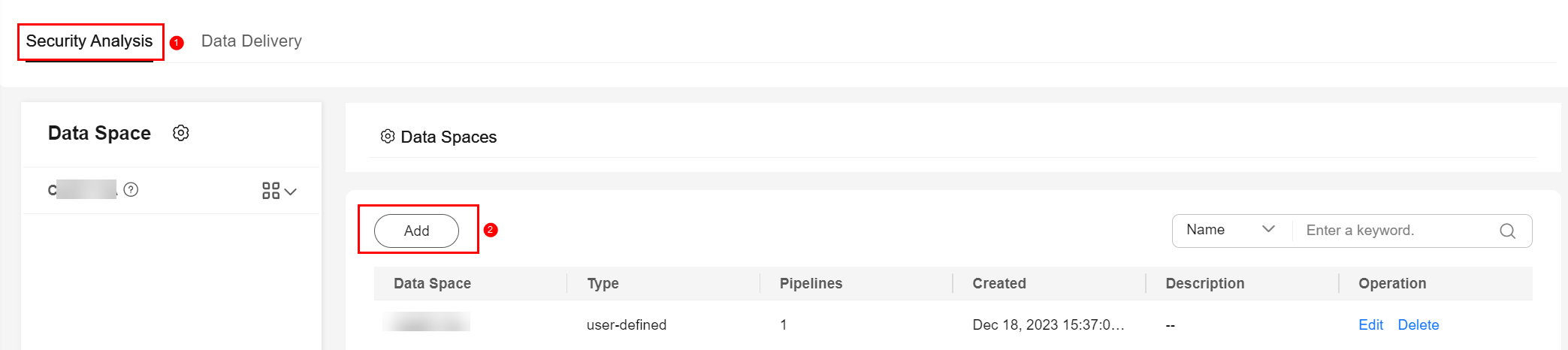

    1. Add a data space.
      1. In the upper left corner of the data space list, click Add. The Add Data Space panel is displayed on the right.
        Figure 3 Add Data Space

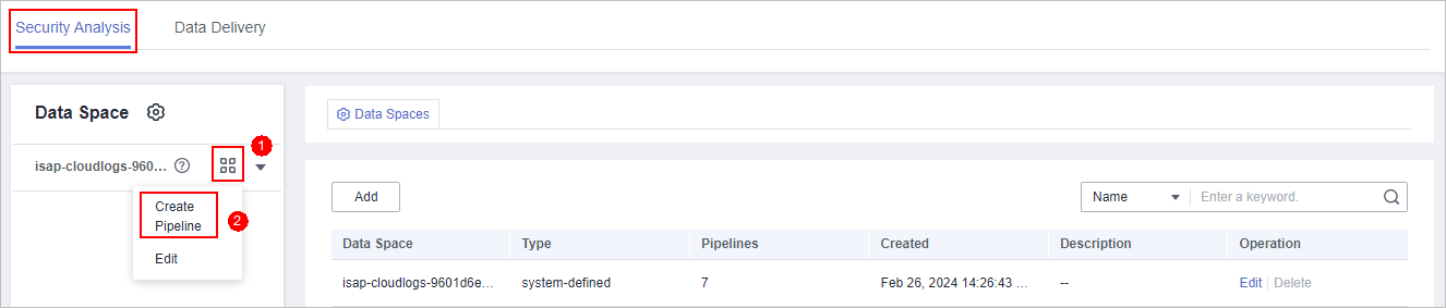

    2. In the data space navigation tree on the left, locate the data space added in 8.b, click next to the data space name, and select Create Pipeline from the drop-down list.
      Figure 4 Creating a pipeline
    3. On the Create Pipeline page, configure pipeline parameters. For details about the parameters, see Table 2.

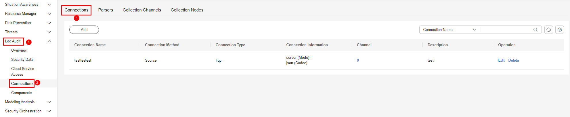

  9. Configure the connector. You need to configure log source and log destination parameters.
    1. Go to the workspace management page. In the navigation pane on the left, choose Log Audit > Collections.
      Figure 5 Accessing the Connections page
    2. Add a source for the data connection.
      1. On the Connections tab, click Add.
      2. Configure the data connection source details.
        This section uses OBS as an example. For more connection types, see Connector Rules.

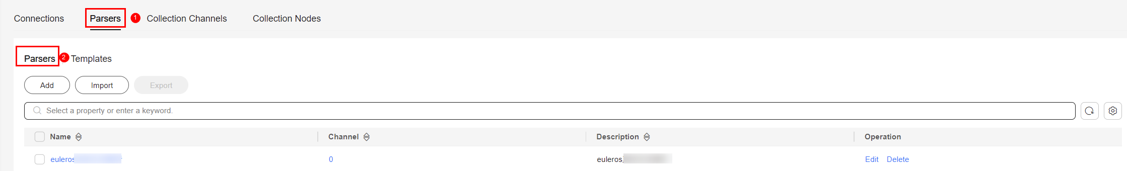

  10. Parameters for adding a parser Create a parser from template AWS ALB log.
    1. Go to the target workspace management page. In the navigation pane on the left, choose Log Audit > Collections. On the displayed page, click the Parsers tab.
    Figure 6 Accessing the Parsers tab
    1. On the Parsers tab, click the Templates tab. In the Operation column of the parser template named AWS ALB log, click Create by Template. The Create Parser page is displayed.

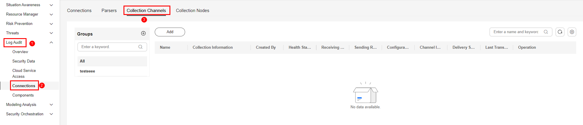

  11. Configure log collection channels, connect each functional component, and ensure that SecMaster and log collectors work properly.
    1. Go to the workspace management page. In the navigation pane, choose Log Audit > Collections. On the Collections page, click the Collection Channels tab.
      Figure 8 Accessing the Collection Channels tab

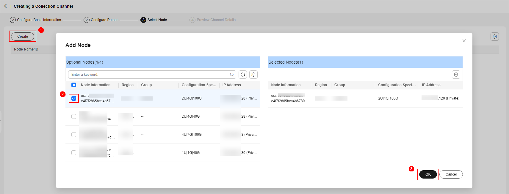

      5. On the Select Node page, click Create. In the displayed dialog box, select the ECS node managed in 6 and click OK.
        Figure 9 Selecting a node

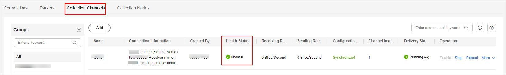

    5. On the Preview Channel Details page, confirm the configuration and click Save and Execute.
    6. On the Collection Channels tab, if the health status of a collection channel is Normal, the collection channel is successfully delivered.
      Figure 10 Collection channels configured
