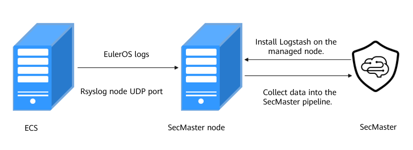

Rsyslog is used to remotely collect logs, send logs on tenant ECSs to the corresponding SecMaster nodes over UDP ports after parsing using the EulerOS system log parser provided by collection management. After enabling log integration, you can query them on the page. The procedure is as follows.

- Install the component controller (isap-agent) and manage log collector nodes (ECSs) to SecMaster. For details, see Installing the Component Controller (isap-agent).
- Install the log collection component (Logstash) and configure the log collection process. For details, see Installing the Log Collection Component (Logstash).

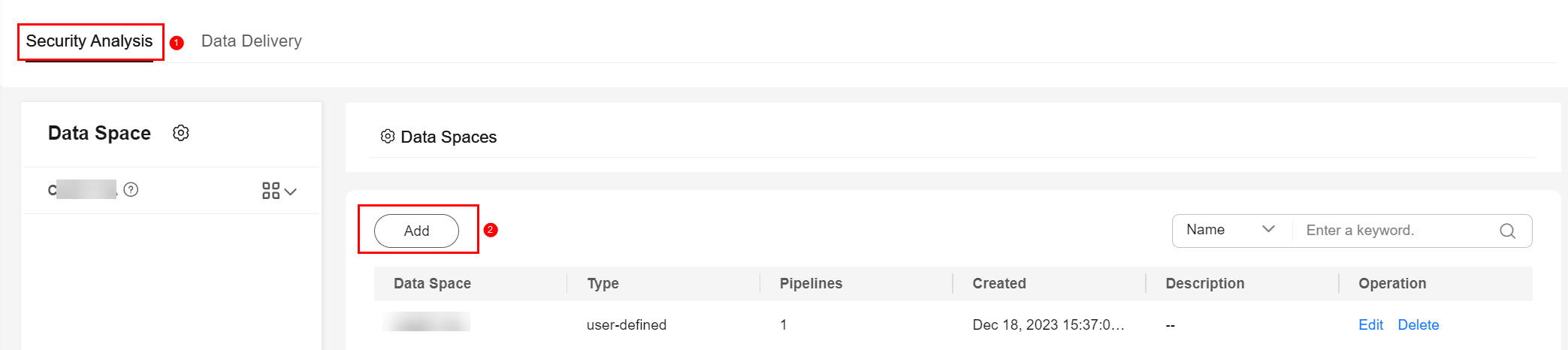

- Add a data space.
- In the upper left corner of the data space list, click Add. The Add Data Space panel is displayed on the right. Figure 3 Add Data Space
- On the Add Data Space panel, set the parameters for the new data space.
Table 1 Adding a data space Parameter
Description
Data Space
Enter a data space name. The name must meet the following requirements:
- The name can contain 5 to 63 characters.
- Only letters, numbers, and hyphens (-) are allowed. The name cannot start or end with a hyphen (-) or contain consecutive hyphens (-).
- The name cannot be the same as any other data space name on Huawei Cloud.
Example: DataTransfer
Description
(Optional) Remarks of the data space.
- Click OK.

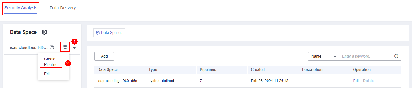

- In the data space navigation tree on the left, click
on the right of the data space name created in 8.b and select Create Pipeline. Figure 4 Creating a pipeline
- On the Create Pipeline page, configure pipeline parameters. For details about the parameters, see Table 2.

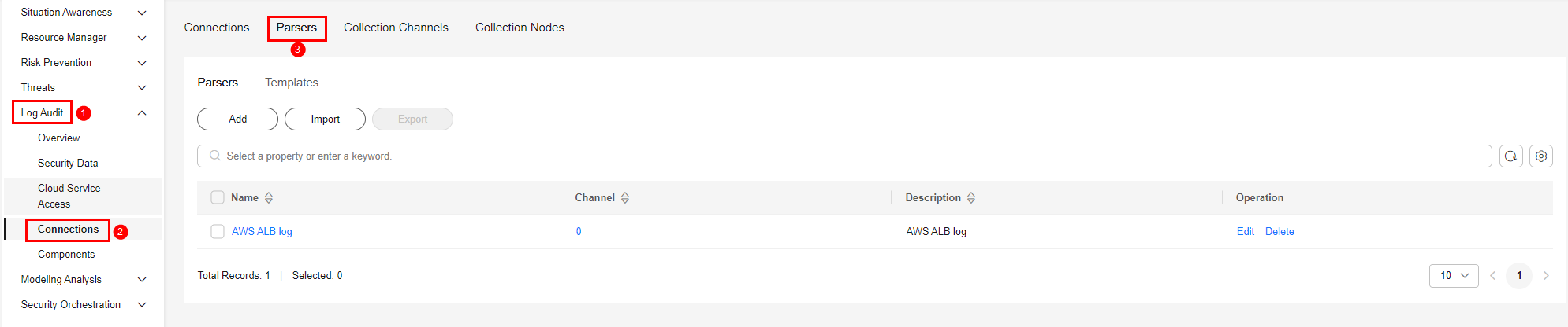

- Add a parser created from the parser template euleros system log parsing.
- Go to the target workspace management page. In the navigation pane on the left, choose . On the displayed page, click the Parsers tab.
Figure 6 Accessing the Parsers tab
- On the Parsers tab, click the Templates tab. In the Operation column of the parser template named Analysis of euleros system log, click Create by Template. The Create Parser page is displayed.
- On the Create Parser page, configure parser parameters.
- Name: Retain the default value Analysis of euleros system log.
- Description: Retain the default value. The default value is Analysis of euleros system log.
- Parsing rule: Retain the default value.
- Click OK. Return to the page to check the created parser.

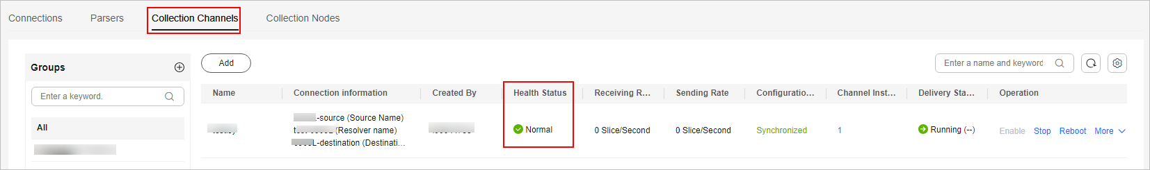

- Configure log collection channels, connect each functional component, and ensure that SecMaster and log collectors work properly.
- Go to the workspace management page. In the navigation pane, choose . On the displayed page, click the Collection Channels tab. Figure 7 Accessing the Collection Channels tab
- Add a log collection channel group.
- On the Collection Channels tab, click
on the right of Groups. - Enter a group name, for example, EulerOS logs, and click
- Create a log collection channel.
- On the right of the group list, click Add.
- In the Configure Basic Information step, configure basic information.
Table 5 Basic information parameters Parameter
Description
Basic Information
Title
Enter a custom collection channel name. In this example, "EulerOS logs" are used.
Channel grouping
Select the group created in 11.b. In this example, "EulerOS logs" are used.
(Optional) Description
Enter the description of the collection channel.
Configure Source
Source Name
Select the log source name added in 9. In this example, select in-euleros-log.
After you select a source, the system automatically generates the information about the selected source.
Destination Configuration
Destination Name
Select the log destination name added in 9. In this example, select out-pipe-euleros-log.
After you select a destination, the system automatically generates the information about the selected destination.
- Click Next in the lower right corner of the page.
- On the Configure Parser page, select Analysis of euleros system log and add raw logs to the collection channel list. After the parser is configured, click Next in the lower right corner.

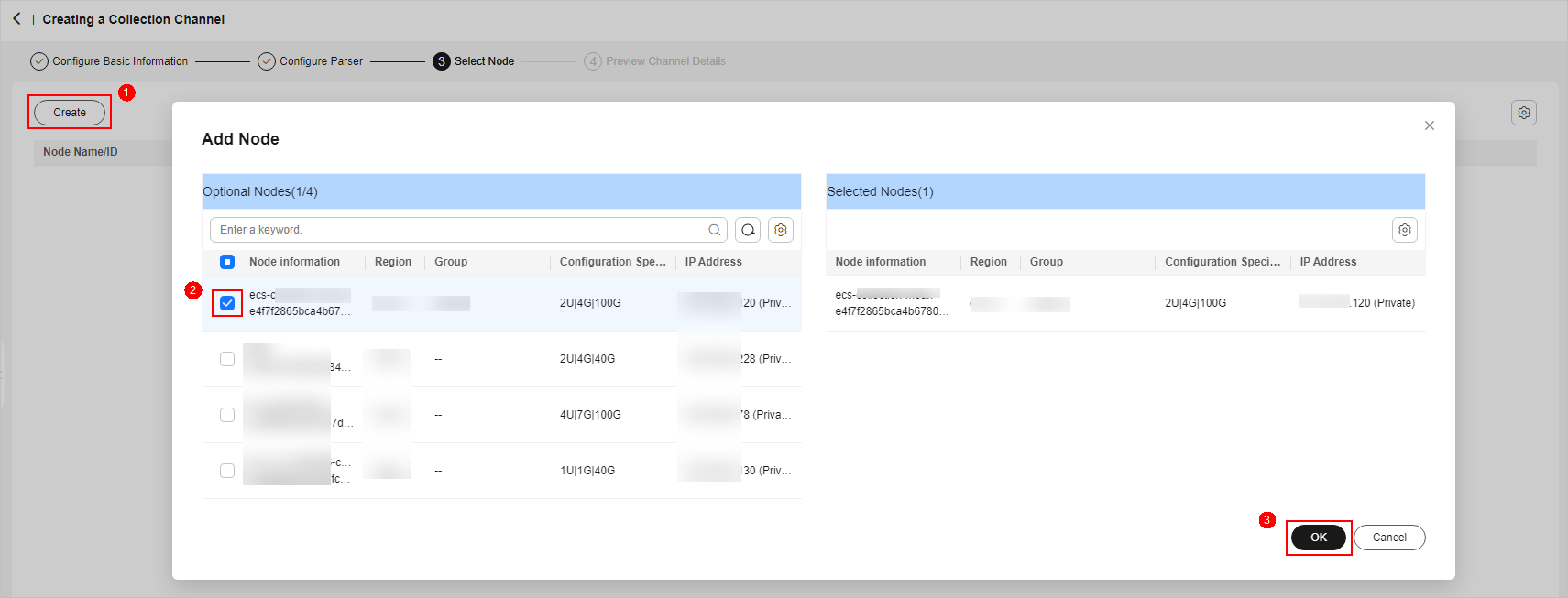

- On the Select Node page, click Create. In the displayed dialog box, select the ECS node managed in 6 and click OK. Figure 8 Selecting a node
- On the Preview Channel Details page, confirm the configuration and click Save and Execute.
- On the Collection Channels tab, if the health status of a collection channel is Normal, the collection channel is successfully delivered. Figure 9 Collection channels configured

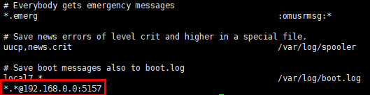

- On the tenant side, configure ECS log forwarding. The Rsyslog service is used to forward logs to SecMaster.
- Remotely log in to your ECS for log collection.
- Select the target log type, run the data access command, monitor all ECS logs through Rsyslog, and specify the IP address and port of the SecMaster collection node to which logs are sent.

- Example 1: If all logs need to be integrated, run the following command:
echo "*.*@IP-address-of-the-SecMaster-collection-node:Port" >> /etc/rsyslog.conf systemctl restart rsyslog
IP-address-of-the-SecMaster-collection-node is the IP address of the ECS node added in 6, and Port is the port set in 9.b.ii.
Example:
echo "*.*@192.168.0.0:5157" >> /etc/rsyslog.conf systemctl restart rsyslog
