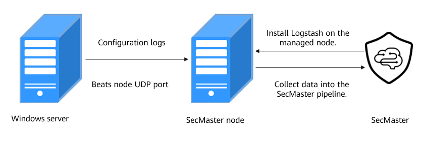

Windows OSs cannot directly forward logs. SecMaster uses Filebeat, a lightweight log collector, to send Windows configuration logs to the node over corresponding UDP port. Then, SecMaster parses the logs using system log parsers to analyze and send parsed data to SecMaster. After enabling log integration, you can query them on the page.

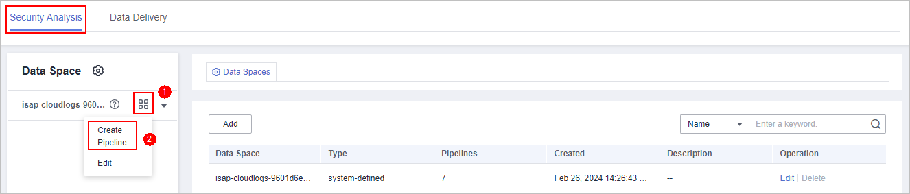

- In the data space navigation tree on the left, locate the data space added in 8.b, click  next to the data space name, and select Create Pipeline from the drop-down list.
       Figure 4 Creating a pipeline next to the data space name, and select Create Pipeline from the drop-down list.

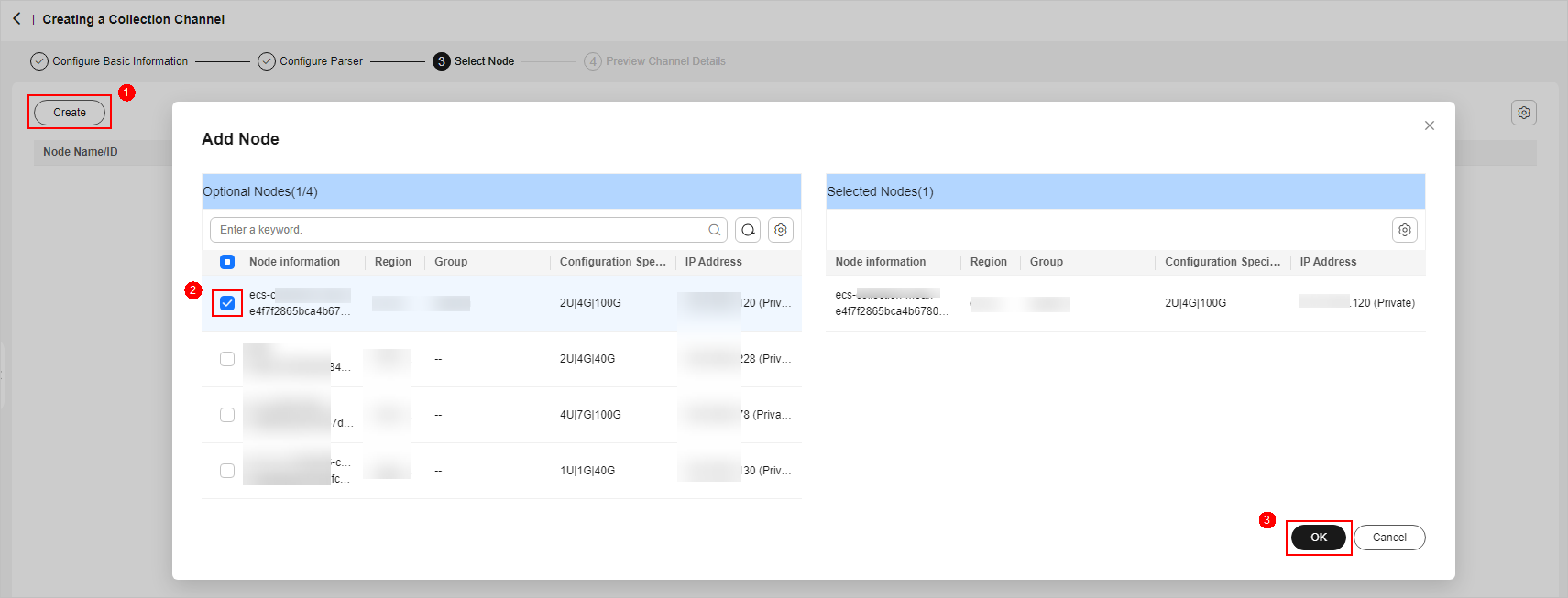

- On the Configure Parser page, select Quick access Parser and add raw logs to the collection channel list. After the parser is configured, click Next in the lower right corner.
- On the Select Node page, click Create. In the displayed dialog box, select the ECS node managed in 6 and click OK.
        Figure 7 Selecting a node
- Click Next in the lower right corner of the page.

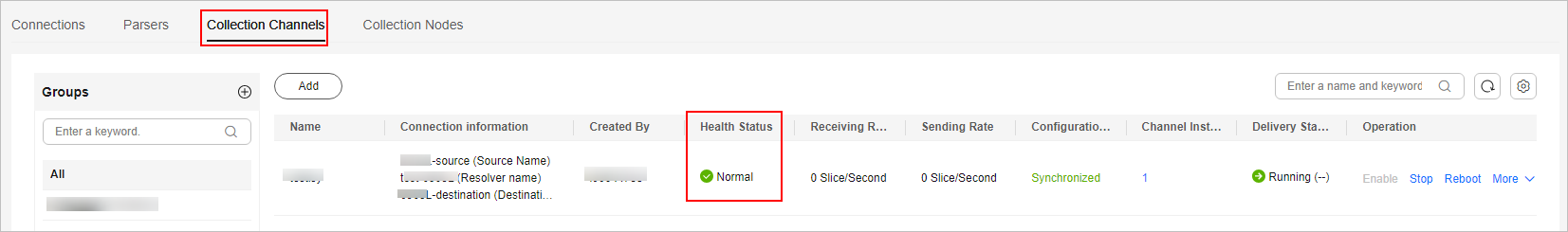

- On the Preview Channel Details page, confirm the configuration and click Save and Execute.
- On the Collection Channels tab, if the health status of a collection channel is Normal, the collection channel is successfully delivered.
      Figure 8 Collection channels configured

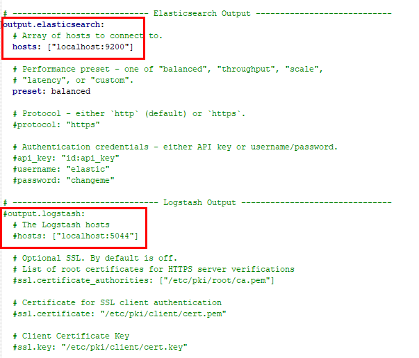

- Modify the filebeat.yml file.

        The SecMaster collection node uses the Logstash service to collect logs. You need to modify the following configurations: - Delete the comment tag (#) from the following two lines of parameters.
          #output.logstash: #hosts: ["localhost:5044"]

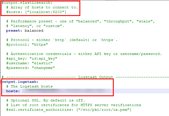

- Change localhost to the IP address of the VM for log collection management. To check the IP address of the data collection ECS node, go to the target workspace, choose in the navigation pane, and click the Nodes tab. On the displayed tab, locate the ECS node and check its IP address.
- Port 5157 is used as an example. If different types of logs need to be collected to SecMaster at the same time, use different ports for different types of logs. The port number ranges from 1025 to 65535.
          Figure 10 Before the change  After the modification Figure 11 After the change

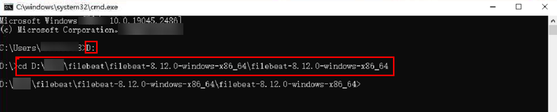

        - Enter cmd in the search box of the Windows operating system to open the command prompt.
- Enter the following command to go to the drive where the Filebeat installation directory is located. The following uses drive D as an example.
          D:
- Enter the following command to go to the Filebeat installation directory.
          cd Filebeat-installation-directory Figure 12 Go to the Filebeat installation directory.
- Enter the following command and press Enter.
          (Frontend).\filebeat -e -c filebeat.yml
