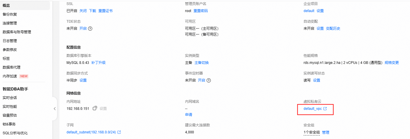

      图6 查看ECS的VPC
      图7 查看RDS的VPC
