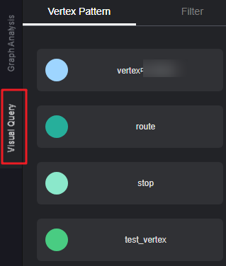

- In the left pane of the graph editor, click the Visual Query tab.
Figure 1 Visual query
- Add a vertex to the canvas.
- In the Add Vertex Pattern tab, all vertex labels and edge labels of the graph are displayed. Each label is displayed as a card that can be dragged to the canvas. Select a vertex label and drag it to the canvas.
The Cypher query statement below changes with your operations.
The vertex and edge labels here are the same as those in the metadata list in Configuring the Schema Data of a Graph.

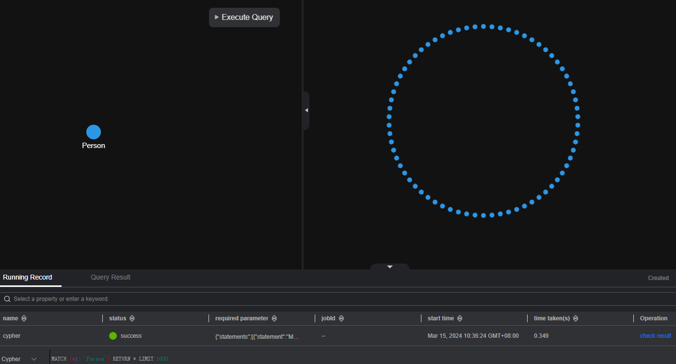

- Drag the labels you want to use for the query to the canvas and click Execute Query. The graph result is displayed on the right of the canvas.

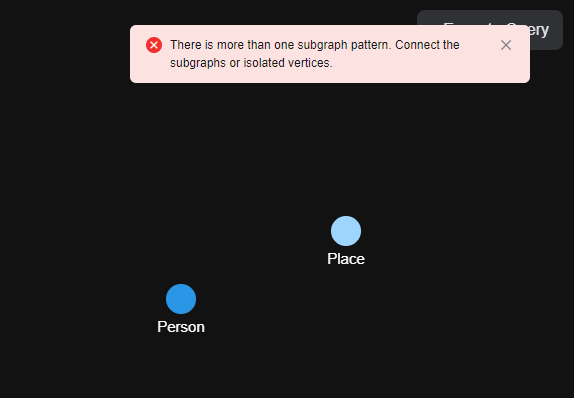

You can view the running records of the Cypher query statement in the Running Record tab below the canvas. Click Query Result to view the result.Figure 2 Query resultQuery results can be displayed only when there is only one submap pattern on the canvas. If there are multiple disconnected subgraphs or isolated vertices, you must first add edges to connect the subgraphs or isolated vertices. You can also rebuild your query pattern by setting up multiple labels. Otherwise, clicking Query will prompt that there are multiple subgraph patterns.Figure 3 Multiple submap patterns

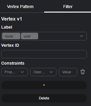

Click a vertex in the canvas. The Filter tab page is displayed in the left pane. On the Filter tab, specify labels, vertex ID, and property search criteria to search for the vertex labels you want to view on the canvas.Figure 4 Adding a vertex search criterion
- Vertex v1: Cypher variable ID (vertex identifier in the Cypher query statement below the canvas), which is named based on the sequence in which vertices are dragged to the canvas, for example, v1, v2, and more.
- Label: Set one or more labels to search for target vertices. The logical operator between every two labels is OR.
- Vertex ID: It is equivalent to a filter criterion. After adding a vertex ID to a vertex label, you can click Query to query the vertex labels with the same vertex ID.
- Constraints: Specify a property contained in the vertex label. Currently, a property with multiple values is not supported.
- Property: Property contained in the label.
- Operator: Comparison operators (>,>=,<,<=,=,<>), null judgment operators (is null, is not null), and string comparison operators (starts with, ends with, contains) are supported.
starts with searches for a property that starts with a specified string; ends with searches for a property that ends with a specified string; contains searches for a property that contains a specified string.
- Value: Property value. The attribute value type must be the same as that in the metadata. If the attribute value is of the character type, you need to use single quotation marks ('').
: Delete the constraint.
- + button: Add a criterion.
- Delete: Delete the added criterion.

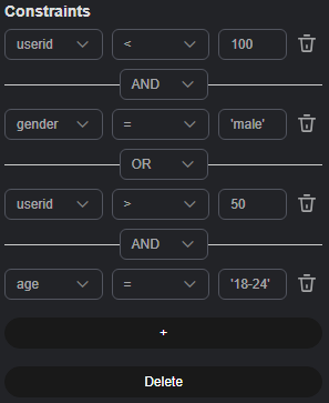

If there is more than one criterion, click
next to AND to set the logical operator (AND or OR).
Figure 8 Selecting a logical operatorThe priority of AND is higher than OR. The suggested calculation sequence is as follows:
- Arrange all AND operations first.
- Then, perform all OR operations.
In the following example, the edge search criterion is userid < 100 AND gender = 'male' OR userid > 50 AND age = '18-24'.
The operation sequence is:
(userid < 100 AND gender = 'male') and (userid > 50 AND age = '18-24') are operated first, and result1 and result2 are recorded respectively.
Then, result1 OR result2 is operated.
