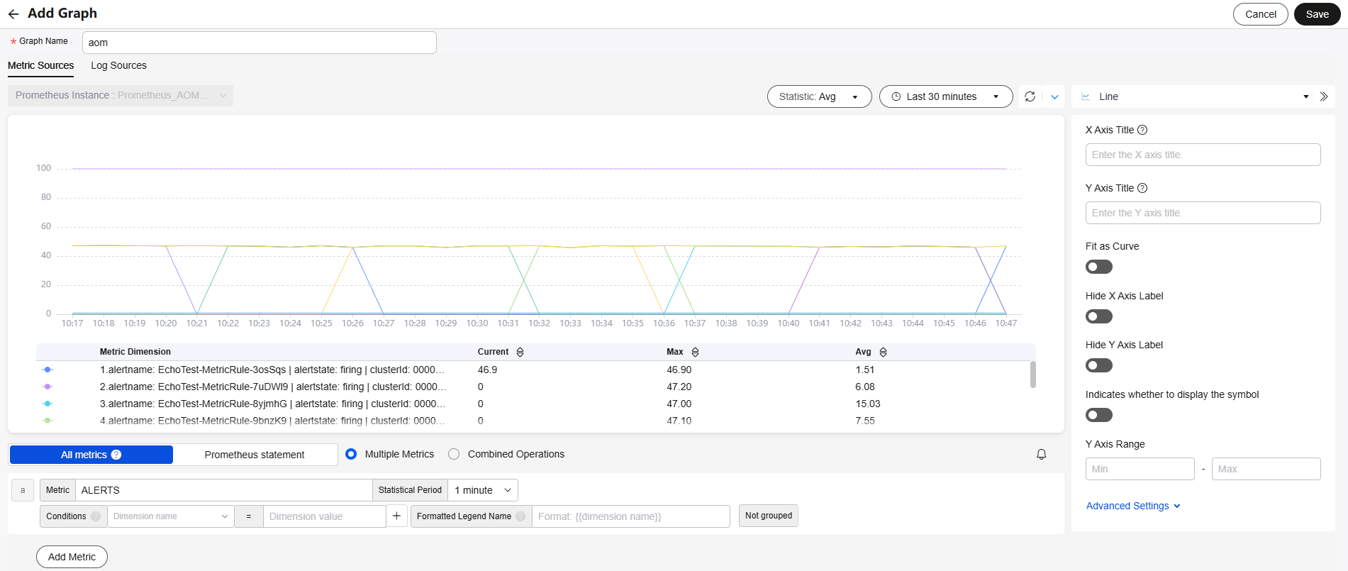

    • Add a metric graph. Set parameters by referring to Table 3. Then click Save.
      Figure 1 Adding a metric graph
      Table 3 Adding a metric graph
      Parameter
      Description
      Graph Name
      Name of a graph to distinguish it from other graphs. For graph names, variables can be added to dynamically filter graph information. Duplicate names are supported.
      Enter a maximum of 255 characters. The following characters are not allowed: "$# %&'+;<=>?\
      Data Source
      The default value is Metric Sources.
      Graph Type
      Options: line, digit, top N, table, bar, and digital line.
      How to Add
      Add metrics as required. You can select metrics through interaction or using PromQL.
      Interaction
      Select target metrics from the metric drop-down list.
      • Calculation method:
        • Multiple Metrics: Performs calculation for metrics and their conditions separately, and displays the results on the graph.
        • Combined Operations: Performs calculation on multiple metrics and their conditions based on expressions, and displays the results on the graph.
      • Metric: Select a target metric from the drop-down list. You can also directly enter a metric name in the search box and click Generate. If no metric is reported, configure one.
      • Statistical Period: Interval at which metric data is collected. The statistical periods that are available for you to select vary according to the time range.
        For details, see Relationship Between the Time Range and Statistical Period. If you use new dashboards, see Relationship between the time range and statistical period.
      • Condition: Metric monitoring scope. Each metric condition is in "key:value" format and can be selected from the drop-down list. You can also enter a dimension name and value, and click Generate to add a metric condition. You can also click and select AND or OR to add more conditions for the metric.
      • Group Condition: Aggregate metric data by the specified field and calculate the aggregation result. Options: Not grouped, avg by, max by, min by, and sum by. For example, avg by clusterName indicates that metrics are grouped by cluster name, and the average value of the grouped metrics is calculated and displayed in the graph.
      • Formatted Legend Name: Use a fixed name or variable as the legend name. For example, enter {{hostname}} and a host name will be displayed as the legend name.
        • Format: {{dimension name}}.
        • If the displayed legend name is {{dimension name}}, there is no dimension.
        • Digit graphs, tables, and digital line graphs do not support Formatted Legend Name.
      • Expression: You need to set an expression when Combined Operations is selected. The metric values and conditions are calculated based on the expression and then displayed in the graph. Operators (+-*/) are supported. Example: a + b
      You can click Add Metric to add more metrics. A maximum of 100 metrics can be added.
      PromQL
      Add metric data by entering a Prometheus statement related to the metric.
      • Prometheus Statement: See Prometheus Statements.
      To add more metrics, click Add Prometheus Statement. You can add 100 metrics in total.
      Graph Settings
      On the right of the page, click the down arrow, select a desired graph type from the drop-down list, and set graph parameters (such as the X axis title, Y axis title, and displayed value). For details about the parameters, see Metric Data Graphs.
      If you create a dashboard of the new version, see Metric Data Graphs.
      Statistic
      Method used to measure metrics. Options: Avg, Min, Max, Sum, and Samples.
      Time Range
      Time range in which metric data is collected. Options: Last 30 minutes, Last hour, Last 6 hours, Last day, Last week, and Custom.
      If you use new dashboards, you can select From now, From last, and Specified.
      • From now: queries data generated in a time range that ends with the current time, such as the previous 1, 5, or 15 minutes. For example, if the current time is 19:20:31 and 1 hour is selected as the relative time from now, the graphs on the dashboard display the data that is generated from 18:20:31 to 19:20:31.
      • From last: queries data generated in a time range (on the hour) that ends with the current time, such as the previous 1 or 15 minutes. For example, if the current time is 19:20:31 and 1 hour is selected as the relative time from last, the graphs on the dashboard display the data that is generated from 18:00:00 to 19:00:00.
      • Specified: queries data that is generated in a specified time range.
      Refresh Frequency
      Interval at which the metric data is refreshed. Options: Refresh manually, 30 seconds auto refresh, 1 minute auto refresh, and 5 minutes auto refresh.
