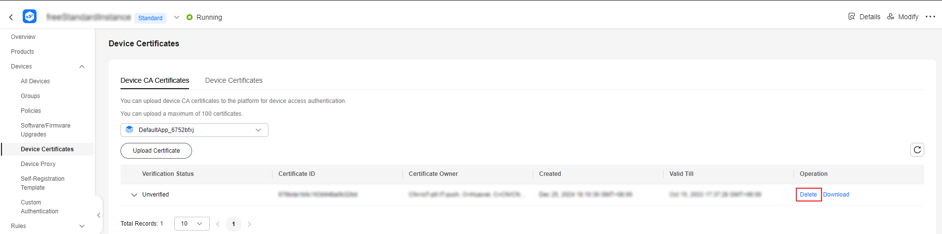

Deleting a CA Certificate
You can delete a CA certificate that is no longer used.
Once a service CA certificate is deleted, devices that rely on it for authentication can no longer access the platform. Back up related data before the deletion.
Figure 5 CA certificate - Deleting a certificate
