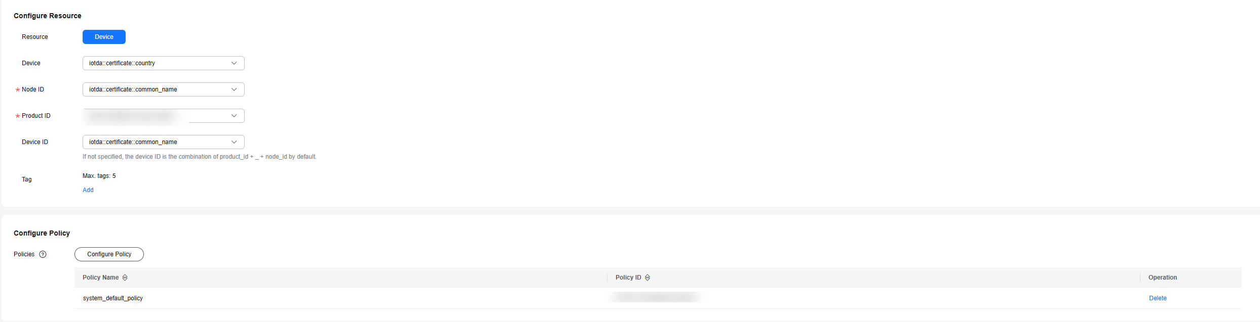

     - Select the device name, node ID, device ID, and product ID in the resource configuration area.
    Figure 3 Self-registration template - Creating a template
     The platform predefines the parameters that can be declared and referenced in the template, as shown below. The certificate must contain the parameters referenced in the template.
- iotda::certificate::country: country
 - iotda::certificate::organization: organization
 - iotda::certificate::organizational_unit: department
 - iotda::certificate::distinguished_name_qualifier: distinguished name
 - iotda::certificate::state_name: province/state
 - iotda::certificate::common_name: common name
 - iotda::certificate::serial_number: serial number
 - Add a policy in the policy configuration area. The added policy is automatically bound to the device during self-registration. For details, see Device Topic Policies.

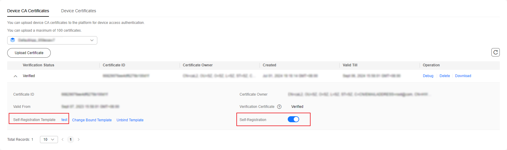

 - In the navigation pane, choose Devices > Device Certificates. Create a device certificate by referring to Registering a Device Authenticated by an X.509 Certificate. Upload the CA certificate to the platform for verification, bind the self-registration template created in 3, and enable the self-registration function.
    Figure 4 Device CA certificate - Binding a template
     The CA certificate and the product associated with the product ID in the template must be in the same resource space.

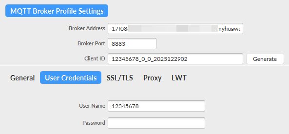

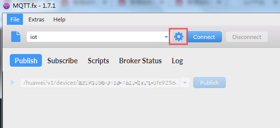

 - Open MQTT.fx, set connection parameters by referring to Table 1, and click Apply.
Table 1 Connection parameters Parameter
Description
Broker Address
Platform access address (see How Do I Obtain the Platform Access Address?)
Broker Port
8883
Client ID
Any string. Recommended: Set this parameter according to the platform rules in Device Connection Authentication to ensure continued access to the platform via certificate authentication even after the template is disabled.
User Name

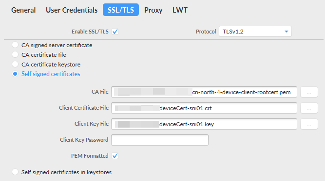

Enable SSL/TLS
True
Self signed certificates
True
CA File
Platform CA certificate (see Certificates)
Client Certificate File
Path of the device certificate file
Client Key File
Path of the private key file of the device certificate
Client Key Password
Private key password (not necessary if there is no password)

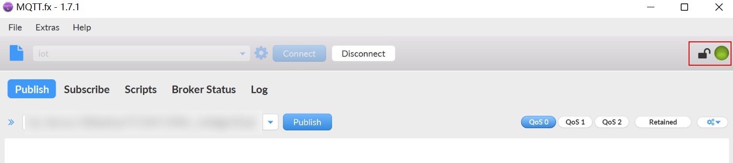

     - Click Connect. If the icon in the upper right corner turns green, the simulated device has been authenticated and connected.
    Figure 9 Device simulator connected

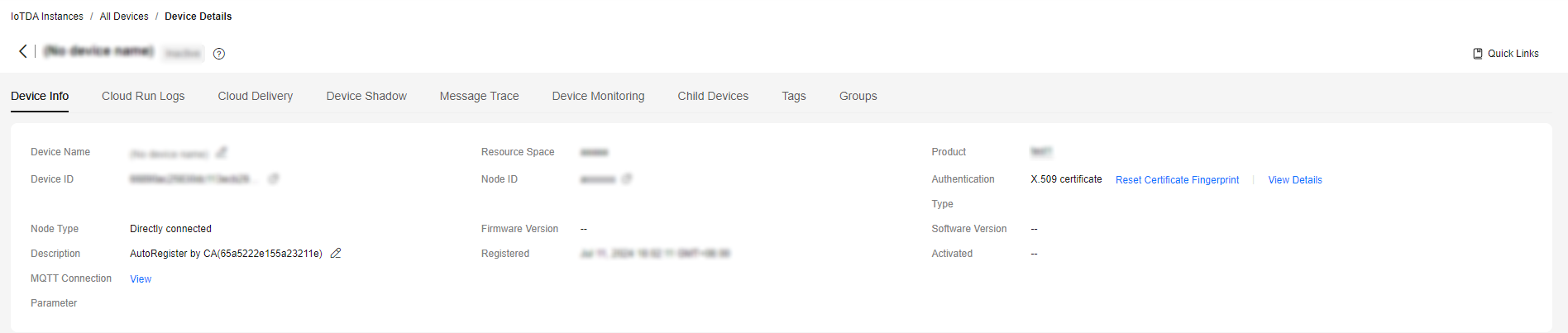

     - In the navigation pane of the IoTDA console, choose Devices > All Devices. On the device list tab page, search for the device by device ID or node ID. The device is displayed as registered and online.
    Figure 10 Device - Self-registered device details
