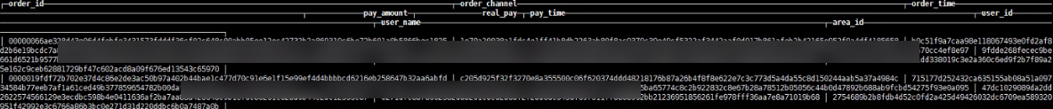

Step 4: Verify the result.
  1. After the MRS Flink and DLI jobs are successfully executed, return to the ClickHouse cluster command window and access the cluster client.
  2. View databases.
    show databases;
  3. Use databases.
    use databases;
  4. View tables.
    show tables;
  5. View the synchronized data.
    select * from order limit 10;
    Figure 2 Viewing synchronization data
