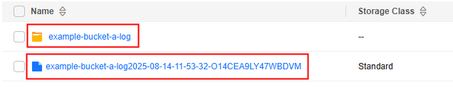

- Check whether log files exist.
Check whether log files exist or whether the folder for storing log files exists in the object list based on the configured log file name prefix and log file naming rules.
Figure 2 Checking the log folder or log files

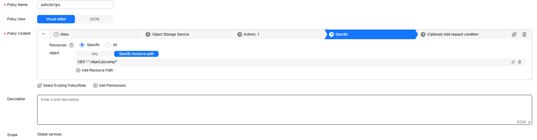

- Create a custom policy to grant OBS permissions to the agency. If a policy that meets the requirements already exists, skip this step.
- In the navigation pane of the IAM console, choose Permissions > Policies/Roles.
- On the Policies/Roles page, click Create Custom Policy in the upper right corner.
- On the Create Custom Policy page, set the parameters as follows and retain the default settings for other parameters.
Figure 3 Configuring a custom policy
- Policy Name: Enter a name that is easy to remember.
- Select service: Select Object Storage Service (OBS).
- Actions: Select obs:object:PutObject.
- Resources: Select Specific.
object: Select Specify resource path. The resource path format is OBS:*:*:object:Bucket name/Object name.
Replace Bucket name with the name of the log storage bucket. For example, OBS:*:*:object:piccomp/* indicates all objects in the log storage bucket piccomp.
- Click OK. If the created custom policy is displayed in the policy list, the policy is created successfully.
