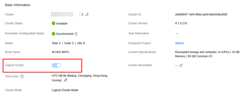

- For a storage-compute coupled cluster, Logical Cluster must be toggled on so that the Logical Cluster tab is displayed in the navigation pane on the cluster details page. The Logical Cluster toggle switch only controls whether to display the Logical Cluster tab. When it is toggled on, the cluster will not be converted to a logical cluster.

- On the top navigation bar, click the Logical Clusters or Virtual Warehouses tab. Figure 1 Logical Cluster switch button
