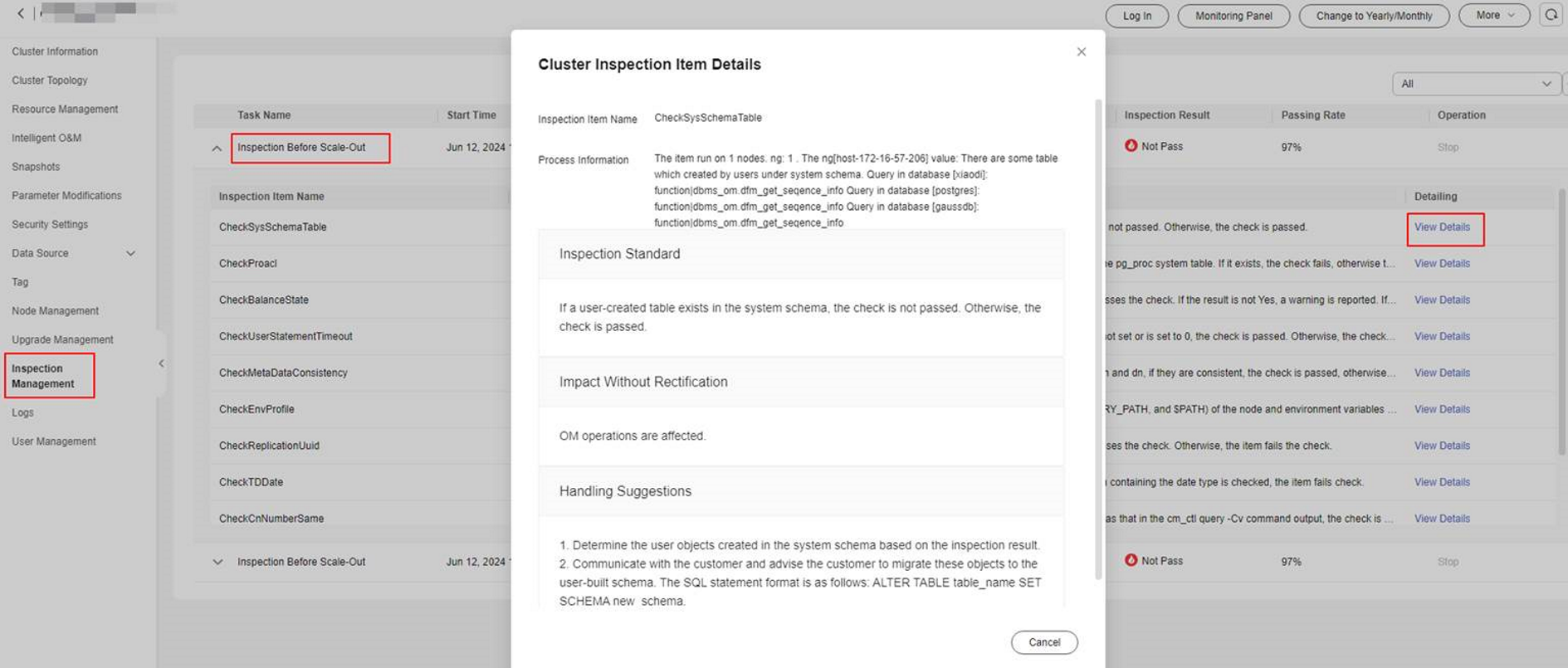

Viewing Inspection Details
- Log in to the DWS console.
- In the navigation pane on the left, choose Clusters > Cluster List. In the cluster list, click the name of the target cluster.
- On the Cluster Information page, click the Inspection Management tab.
- Click
next to the name of a task to check the inspection status, execution progress, inspection result, and pass rate. For more details about these inspection items, click View Details in the task row. After creating an inspection task on the configuration change page, you can keep track of its progress and view details. You can even stop the inspection from that same page. Figure 1 Viewing inspection details
