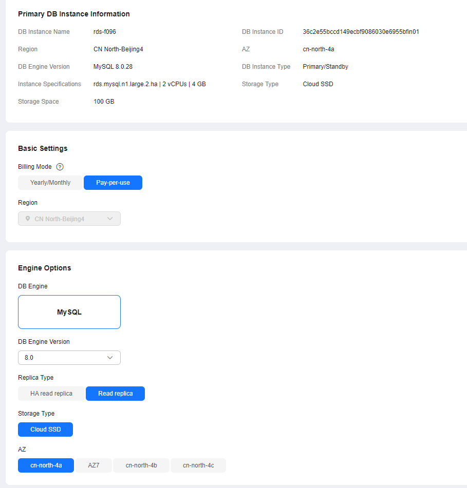

Figure 1 Basic information
Table 1 Basic information Parameter
Description
Billing Mode
Yearly/monthly billing and pay-per-use billing are supported.
Region
By default, read replicas are in the same region as your DB instance.
DB Engine
Same as the DB engine of your DB instance by default and cannot be changed.
DB Engine Version
Same as the DB engine version of your DB instance by default and cannot be changed.
Replica Type
Select Read replica.
Storage Type
Determines the DB instance read/write speed. The higher the maximum throughput is, the higher the DB instance read/write speed can be.
- Cloud SSD or Ultra-high I/O
Stores data in cloud disks for decoupled storage and compute. The maximum throughput is 350 MB/s.
- For RDS for MySQL instances, this storage type is normally displayed as Cloud SSD, but for existing instances in certain regions it is displayed as Ultra-high I/O.
- The supported IOPS depends on the I/O performance of the Elastic Volume Service (EVS) disk. For details, see the description about ultra-high I/O in Disk Types and Performance of the Elastic Volume Service Service Overview.
- Extreme SSD
Uses 25GE network and RDMA technologies to provide you with up to 1,000 MB/s throughput per disk and sub-millisecond latency.
The supported IOPS depends on the I/O performance of the EVS disk. For details, see the description about extreme SSDs in Disk Types and Performance of the Elastic Volume Service Service Overview.
- Flexible SSD
Decouples capacity from performance and allows for tailored IOPS and throughput for your business requirements. This storage type is ideal for mainstream interactive applications that require high performance and low latency.
- You can preconfigure an IOPS ranging from 3,000 to 128,000. This IOPS must also be less than or equal to 500 times the capacity. You can preconfigure a throughput ranging from 125 to 1,000 MiB/s. This throughput must also be less than or equal to the IOPS divided by 4. For details, see the description about general-purpose SSD V2 in Disk Types and Performance of Elastic Volume Service Service Overview.
NOTE:To purchase instances with flexible SSDs, submit a service ticket.
If you select DSS for Resource Type, only the storage type that you have selected when buying the DSS service is displayed by default.
AZ
RDS allows you to deploy your DB instance and read replicas in a single AZ or across AZs to improve reliability.

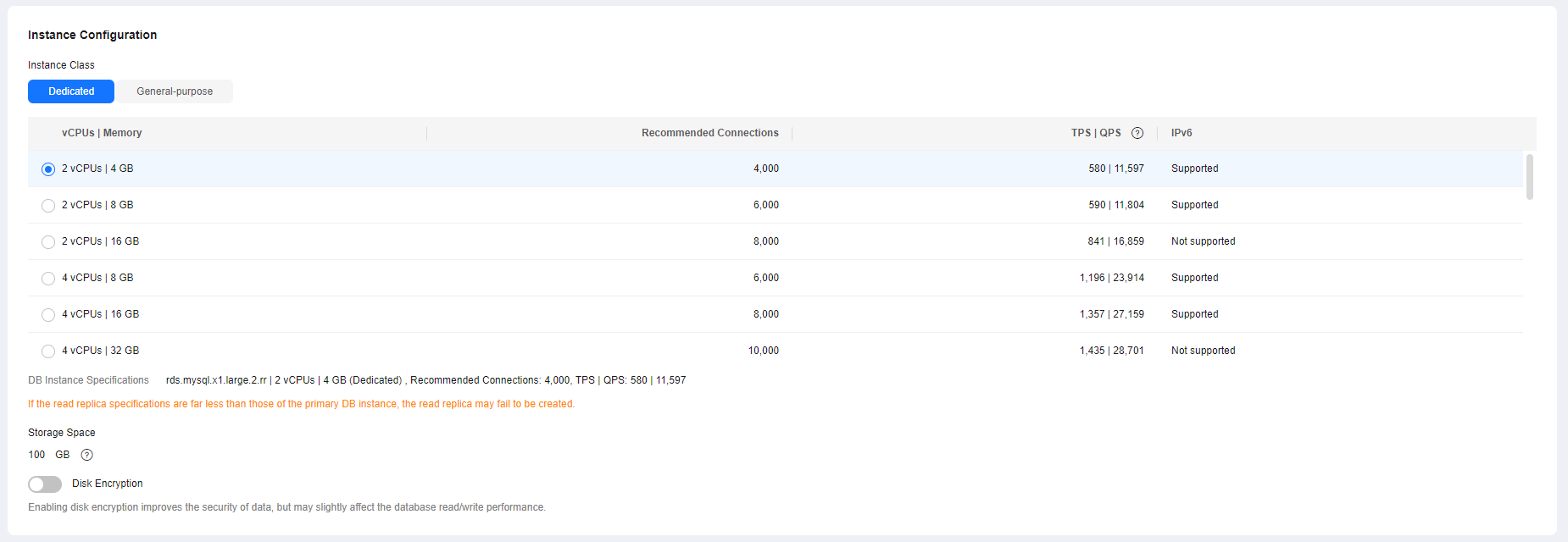

Figure 2 Instance configuration
Table 2 Specifications and storage Parameter
Description
Instance Class
Refers to the vCPUs and memory of a DB instance. Different instance classes support different numbers of database connections and maximum IOPS.
After a DB instance is created, you can change its instance class. For details, see Changing a DB Instance Class.
DB instances in a DCC only support the general-enhanced instance class.
Storage Space
Contains the system overhead required for inodes, reserved blocks, and database operation.
By default, storage space of a read replica is the same as that of the primary DB instance.
Disk Encryption
- Disable: indicates the encryption function is disabled.
- Enable: indicates the encryption function is enabled. Enabling disk encryption enhances data security but reduces the database's read and write performance by 5%.
Key Name: indicates the tenant key. You can select an existing key or create a new one.
NOTE:- If you enable disk encryption during instance creation, the disk encryption status and the key cannot be changed later.
- After an RDS DB instance is created, do not disable or delete the key that is currently in use. Otherwise, RDS will be unavailable and data cannot be restored.
- For details about how to create a key, see "Creating a Key" in Data Encryption Workshop User Guide.

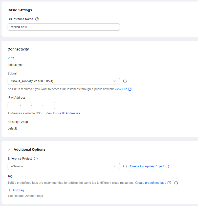

Figure 3 Connectivity and additional options
Table 3 Network Parameter
Description
DB Instance Name
Must start with a letter and consist of 4 to 64 characters. Only letters (case-sensitive), digits, hyphens (-), and underscores (_) are allowed.
VPC
Same as the primary DB instance's VPC.
Subnet
Select the same subnet as the primary DB instance or another subnet in the same VPC. For details about how to create a subnet, see Creating a Subnet for the VPC.
- IPv4 address:
A floating IPv4 address is automatically assigned when you create a read replica. You can also enter an unused floating IPv4 address in the subnet CIDR block. After the read replica is created, you can change the floating IP address.
- IPv6 address:
You can create a read replica using a floating IPv6 address only when the vCPU and memory you selected support IPv6 addresses.
A floating IPv6 address is automatically assigned during read replica creation and cannot be specified. After the read replica is created, this floating IP address cannot be changed.
Security Group
Same as the primary DB instance's security group.
Table 4 Additional Options Parameter
Description
Enterprise Project
If your account has been associated with an enterprise project, select the target project from the Enterprise Project drop-down list.
For more information about enterprise projects, see Enterprise Management User Guide.
Tag
Optional. Tags help you easily identify and manage your read replicas. A maximum of 20 tags can be added for each read replica.
After a read replica is created, you can view its tag details on the Tags page. For details, see RDS for MySQL Tags.
