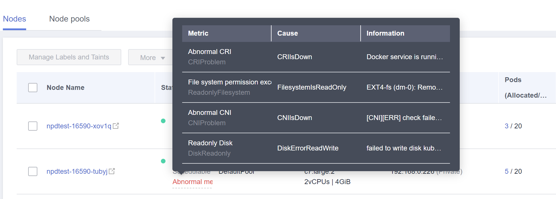

CCE provides an add-on called CCE Node Problem Detector for you to locate faults occurred with nodes. In 1.16.0 and later versions of this add-on, a large number of check items have been added. They allow you to detect the exceptions of resources and components on nodes and locate the faults.
It is strongly recommended that you install this add-on or upgrade it to version 1.16.0 or later.

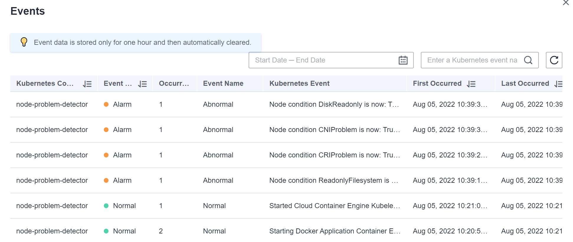

With this add-on, if an exception occurs with a node, you can view the abnormal metrics on the console.
You can also view the events reported by the add-on in node events and locate the faults based on the events.

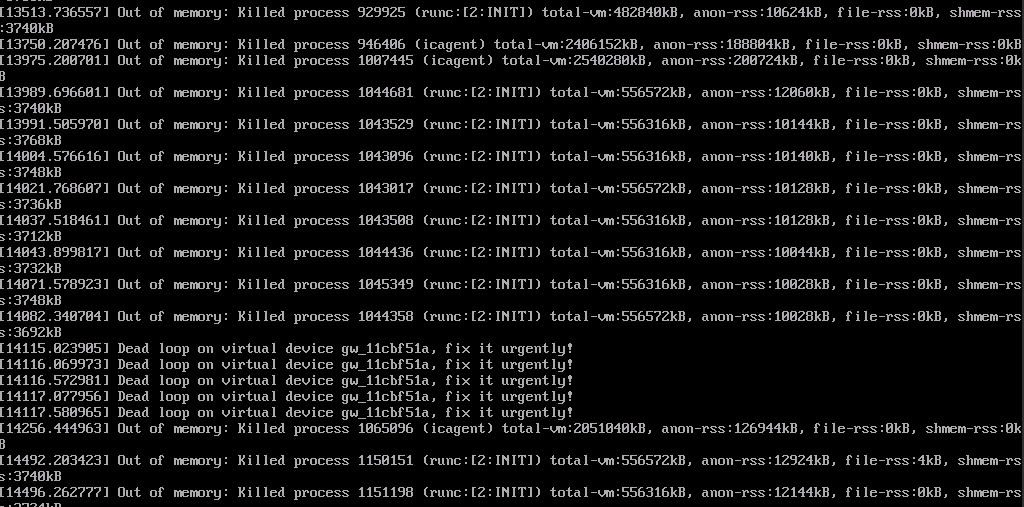

OOMKilling |
Check whether OOM events occurred and are reported. Handling suggestions: Check Item 1: Whether the Node Is Overloaded |

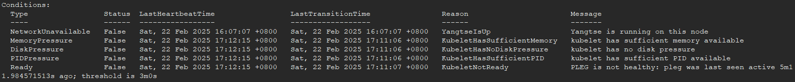

- Locate the row containing the target node, choose More > View YAML in the Operation column, and check the Status field of the node.
The node is in the NotReady state.
- Check the node status and verify whether the value of PIDPressure, DiskPressure, or MemoryPressure becomes True. If any of them becomes True, you can find the appropriate solution based on the exception keyword.

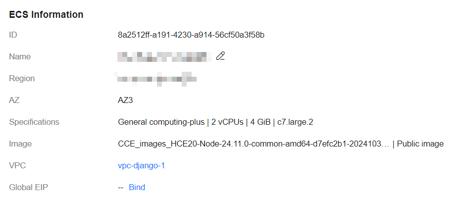

Verifying Whether the ECS Has Been Deleted or Is Faulty
- Log in to the CCE console, click the name of the target cluster to access the cluster console, and view the name of the unavailable node.
- Log in to the ECS console, search for the node, and check the ECS status.
- If the ECS has been deleted, go back to the CCE console, delete the node from the node list, and create another one.
- If the ECS is stopped or frozen, restore it first. It takes about 3 minutes to restore the node.
- If the ECS is faulty, restart it to rectify the fault.
- If the ECS is available, rectify the fault by referring to Checking Key Components of the Node.

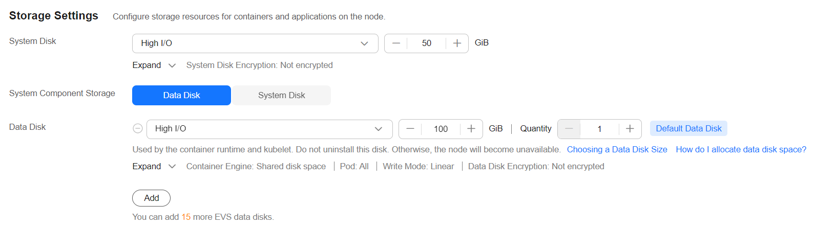

Checking the Disks Attached to the Node
- By default, a 100-GiB data disk is attached to a node for runtime purposes. You have the option to attach additional data disks to the node if needed. If the data disk is removed or damaged, the runtime will be disrupted and the node will become unavailable.
- You need to check whether the data disks of the node are detached from it. If they are, you are advised to create a node and delete the unavailable node. (To minimize risks, you are not advised to perform operations on the CCE nodes through the ECS console.)

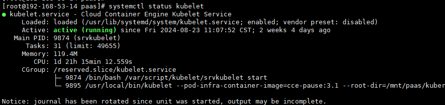

kubelet
- Check the kubelet.
Log in to the target node, run the following command on it, and check the kubelet:
systemctl status kubelet
The expected output is shown in the figure below.
- View the kubelet logs.
journalctl -u kubelet

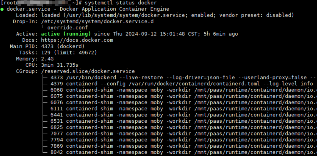

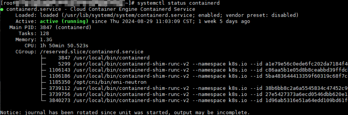

Runtime
- Docker
- containerd

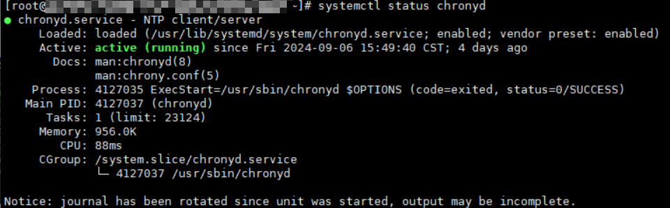

- NTP

- Expand the capacity of the node disks. For details, see Expanding the Storage Space.
- Reduce the load of the node.
Abnormal kubelet
Possible Cause
The kubelet process is not functioning properly or the kubelet configuration is improper. Typically, CCE has set up health checks for kubelet as a default configuration. There is a greater chance of startup failure if the configuration is incorrect.
Symptom
kubelet is inactive.
Solution
- Log in to the abnormal node and restart kubelet: (Restarting kubelet does not affect the running containers.)
systemctl restart kubelet
- Check whether the kubelet status becomes normal:
- If the kubelet status is still abnormal after the restart, log in to the node and view the kubelet logs:
- If there are error messages in the logs, find the cause by looking for specific keywords associated with the error.
- If there is an issue with the kubelet configuration, find the node pool that the node belongs to, click Manage in the Operation column, and make changes to the kubelet configuration.
Abnormal Runtime
Possible Cause
The Docker or containerd configuration or process is not functioning properly.
Symptom
- Docker
- Docker is inactive.
- Docker is active and running, but the node is experiencing issues and not functioning properly, resulting in abnormal behavior. In this case, the docker ps or docker exec command fails to be executed.
- The value of RuntimeOffline of the node becomes True.
- containerd
- containerd is inactive.
Solution
- Log in to the abnormal node.
- Restart the runtime:
# Docker systemctl restart docker # containerd systemctl restart containerd
- After the command is executed, check whether the running status is normal.
# Docker systemctl status docker # containerd systemctl status containerd
- If the component status is still abnormal after the restart, check the component logs:
# Docker journalctl -u docker # containerd journalctl -u containerd
Abnormal NTP
Possible Cause
The NTP process is abnormal.
Symptom
- chronyd is inactive.
- The value of NTPProblem becomes True.
Solution
- Log in to the abnormal node and restart chronyd:
systemctl restart chronyd
- After the restart, check whether the chronyd status becomes normal:
systemctl status chronyd
- If the chronyd status is still abnormal after the restart, log in to the node and view the chronyd logs:
journalctl -u chronyd

Abnormal PLEG
Possible Cause
The pod lifecycle event generator (PLEG) records different events in the lifecycle of a pod, such as the pod startup and termination. The error "PLEG is not healthy" is usually due to abnormal runtime processes on the node or issues with the systemd version on the node.
Symptom
- The node is in the NotReady state.
- You can see the following information in the kubelet logs:
skipping pod synchronization - PLEG is not healthy: pleg was last seen active 3m17.028393648s ago; threshold is 3m0s.
Solution
- Restart Docker or containerd and kubelet in sequence and then check whether the node is restored.
- If the node is not restored after the restart of the key components, restart the node. (Be cautious when restarting the node because it may cause interruptions to your services.)

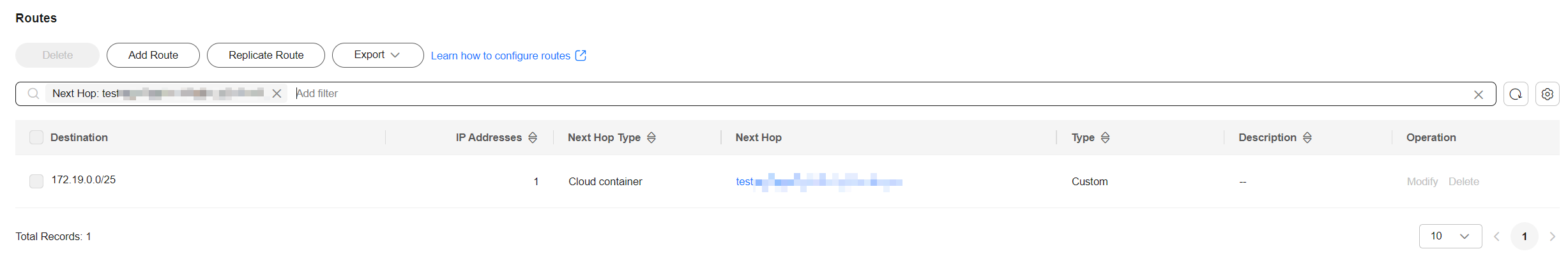

Restricted Node Scheduling with the node.kubernetes.io/route-unreachable Taint
Possible Cause
The network infrastructure's route tables allow the container networks in a cluster that uses the VPC network model to be accessible. A newly created CCE node has network isolation support. If the node network is not functioning properly, the system will automatically add the node.kubernetes.io/route-unreachable taint to the node and remove it once the network is ready. If the node.kubernetes.io/route-unreachable taint remains for an extended period, it indicates abnormal network connectivity for the node.
Symptom
A newly created node is restricted for scheduling for a long time.
Solution
- If there are other normal nodes in the cluster, run the ping command to check the network connectivity between containers on different nodes.
Create a container for testing. In the following example, {node_ip} indicates the IP address of the abnormal node.
kind: Pod apiVersion: v1 metadata: name: nginx namespace: default spec: containers: - name: container-1 image: nginx:latest imagePullPolicy: IfNotPresent imagePullSecrets: - name: default-secret affinity: nodeAffinity: requiredDuringSchedulingIgnoredDuringExecution: nodeSelectorTerms: - matchExpressions: - key: kubernetes.io/hostname operator: In values: - {node_ip} schedulerName: default-scheduler tolerations: - key: node.kubernetes.io/route-unreachable operator: Exists effect: NoSchedule
After the container is started, log in to another normal node and ping the IP address of the container. If the communication is abnormal, go to the next step.
- On the Route Tables page of the VPC console, check whether the node route has been added, whether the next hop type is cloud container, and whether the next hop is the node name. If the node route is present in the route table but the node is still unable to connect to the network, it suggests a potential problem with the underlying network. In such situations, submit a service ticket to the networking team for assistance.
- If the fault persists, submit a service ticket to CCE for troubleshooting.
Node Unavailable Due to OOM
Possible Cause
Many containers are scheduled onto a node, using up all its resources and causing an OOM issue. This issue is primarily seen on nodes running the Docker container engine.
Symptom
If a node in the cluster is assigned too many containers, the node OS might crash, rendering the node unavailable. You may see the information similar to the following after logging in to the node with VNC.
Check the node events:
kubectl describe node {nodeName}
Pay attention to the abnormal node events in the output.
Solution
If the resources on a node are not enough for pod scheduling, reduce the node load through either of the following ways:
- Reset the faulty node.
- Delete unnecessary pods.
- Restrict the resource configurations of pods based on service requirements.
- Add more nodes to the cluster.
