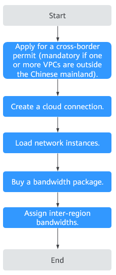

Method 1: Using Cloud Connect to Connect VPCs in Different Regions
Before setting up a DR relationship, you need to configure cross-region network connectivity.

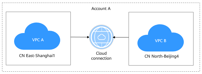

You can use Cloud Connect to connect VPCs across regions.
Ensure that the primary and DR instances are in the regions where cloud connections are available.
Ensure that the VPC subnets to which the primary and DR instances belong allow access from each other.
For details about how to enable communication between VPCs in different regions, see Using a Cloud Connection to Connect VPCs in Different Regions.

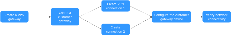

Method 2: Using VPN to Connect VPCs in Different Regions
You can use Virtual Private Network (VPN) to enable communication between VPCs across regions.
Ensure that the primary and DR instances are in the regions where VPN is available.
After configuring the VPN service, you need to contact the VPN customer service to configure the network.
For details about how to configure a VPN connection, see Overview.

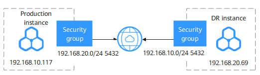

Configuring Security Groups
After connecting two VPCs in different regions, you need to configure security groups for the primary and DR instances so that ports in different VPC CIDR blocks can communicate with each other.
Suppose that there are two instances listed in Table 1 and they use the default port 5432. The firewall configurations for them are as shown in Figure 4.
