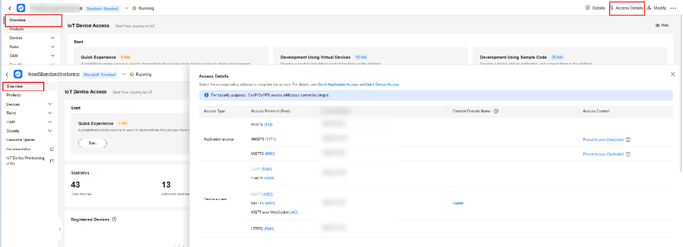

Obtaining Device Access Information
Perform the following procedure to obtain device access information on the IoTDA console:
  1. Log in to the IoTDA console.
  2. In the navigation pane, choose Overview and click Access Details in the Instance Information area to check the device access information and record domain names and ports.
    Figure 1 Obtaining access information
    For devices that cannot be connected to the platform using a domain name, run the ping Domain name command in the CLI to obtain the corresponding IP address. Then you can connect the devices to the platform using the IP address. The IP address is variable and needs to be set using a configuration item.

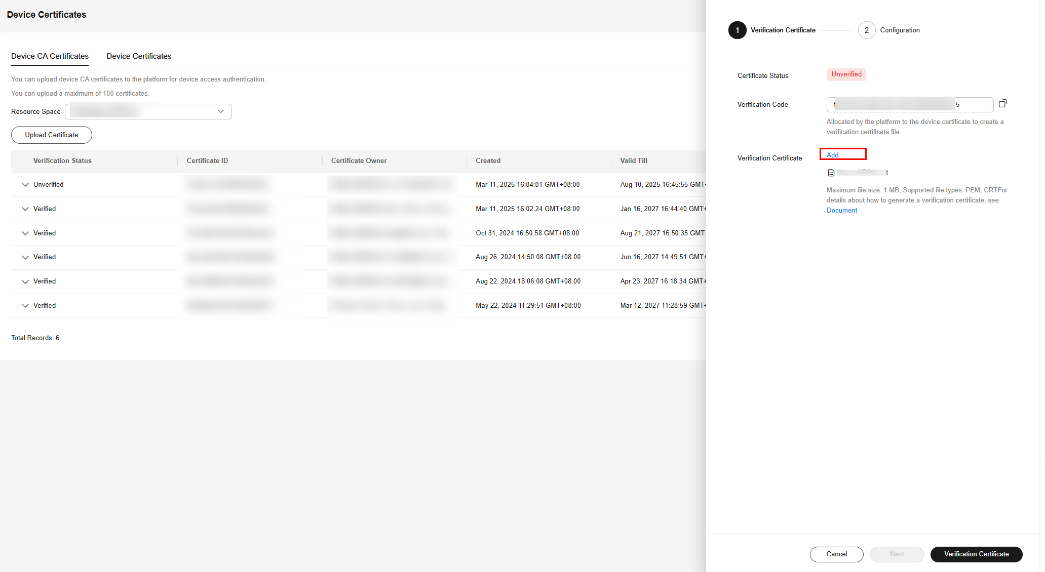

Uploading a Verification Certificate
If the uploaded certificate is a commissioning certificate, the certificate status is Unverified. In this case, upload a verification certificate to verify that you have the CA certificate.
Figure 9 Device CA certificate - Unverified certificate
The verification certificate is created based on the private key of the device CA certificate. Perform the following operations to create a verification certificate:

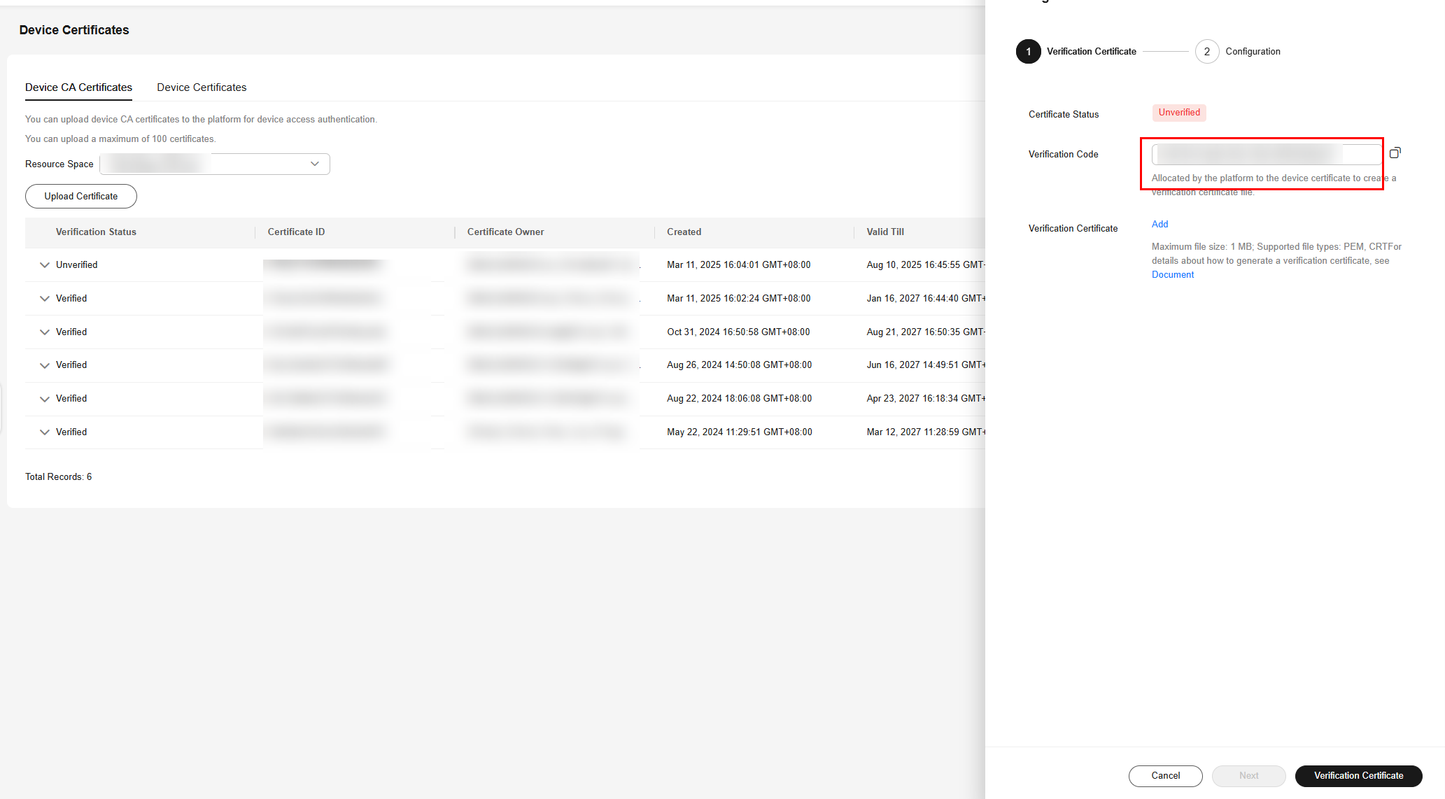

  1. Obtain the verification code to verify the certificate.
    Figure 10 Device CA certificate - Verifying a certificate
    Figure 11 Device CA certificate - Obtaining the verification code

  5. Locate the target certificate, click , and click Upload Verification Certificate.
    Figure 12 Device CA certificate - Verifying a certificate
  6. In the displayed dialog box, click Select File to add a file, and then click OK.
    Figure 13 Device CA certificate - Uploading a verified certificate
    After the verification certificate is uploaded, the certificate status changes to Verified, indicating that you have the CA certificate.
