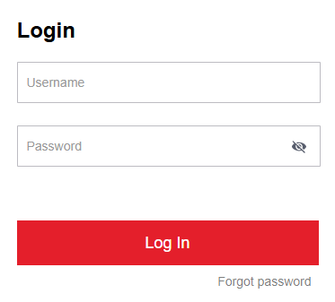

- Enter the login information and click Log In.
You can log in to MRS Manager as user admin or a user created by the administrator with the required login permission.
The password of user admin is the custom password set during MRS cluster creation.
Figure 2 Logging in to MRS Manager

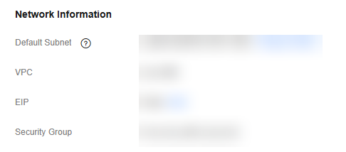

- (Optional) To grant users in other network segments the permission to access MRS Manager, you can modify the security group and add the IP address range of the users.
- On the cluster details page, click Add Security Group Rule next to EIP.
Figure 3 Cluster details page
- In the displayed Add Security Group Rule dialog box, add the IP address segment required for authorized users to access the public network, and select the check box.
Figure 4 Adding a security group rule
By default, the IP address segment used for accessing the public network is filled. You can change the IP address segment as required. To view, modify, or delete security group rules, click Manage Security Group Rule.
- Click OK.
Figure 7 Logging in to MRS Manager
